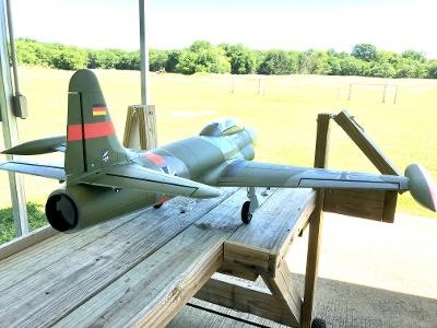

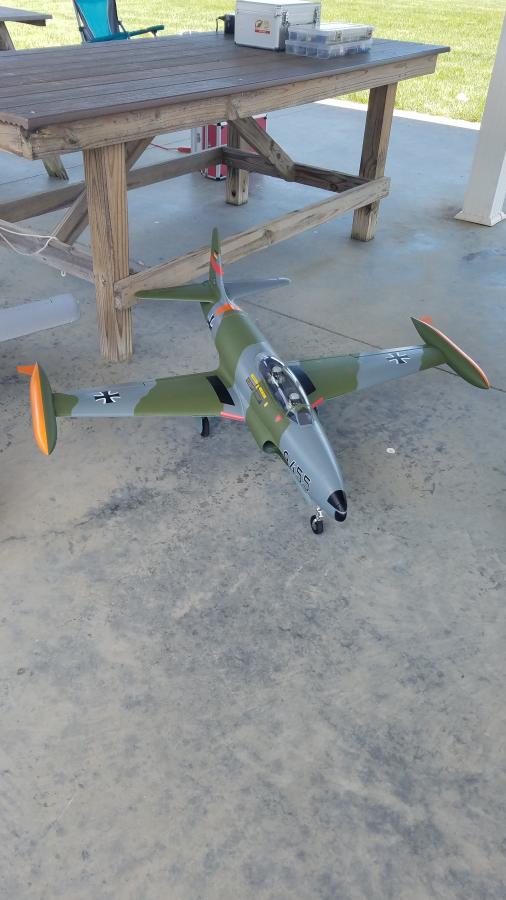

                • finally got to maiden the t33 today, don't know why I was reluctant to do it as It flew great fast and friendly only needed 4 clicks of up. easy flyer love it Click image for larger version

                  • Originally posted by Ron1950 View Post

                    Congrats! I’m no doubt going to buy a backup. This one is too good. I have the silver version, but that camo looks really cool as well... decisions.

                        You definitely won’t be Disappointed. I have loved every flight I’ve had on the T-33. It’s fast!! But I’m more impressed how slow and gentle it can fly. The molded CG marks on the wing where perfect for me.

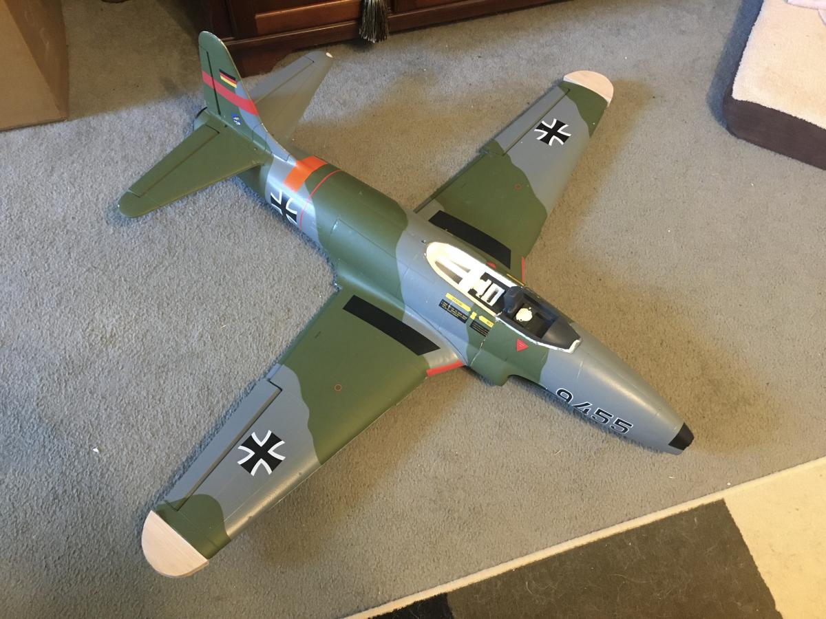

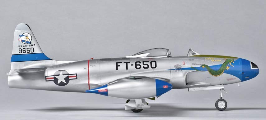

                                      • Still slowly plugging away at my T-33 to P-80 conversion. Most of the inlet rescupting is done. The rear wing fillets were removed and moved to the new loction.
                                        I flat-topped the rear of the battery hatch, below the surface of the fuse. so that a new block of foam can be added and sculpted to match the upper fuse contour, in advance of adding the single place canopy. Clipped off the plastic wing tip mounts for the Fletcher tanks on the T-33 in preparation for the carved balsa wingtips for the P-80. Wingtip blocks ready to carve and install.
                                        Ordered my markings for the P-80 from Callie on Sunday. After much consideration. I chose to use the markings for "Saggin Dragon", a P-80C that saw action in Korea. A fun scheme. Callie is running about a 6 week delivery on custom markings at this time, so perhaps I can time the project to be painted just in time for the markings.
