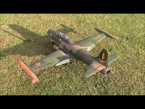

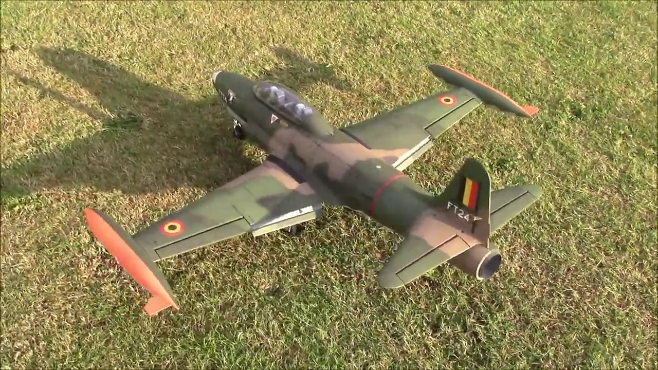

        Here's another vid of my T-33 in belgian livery, with a few hgh speed passes at the end. enjoy !
