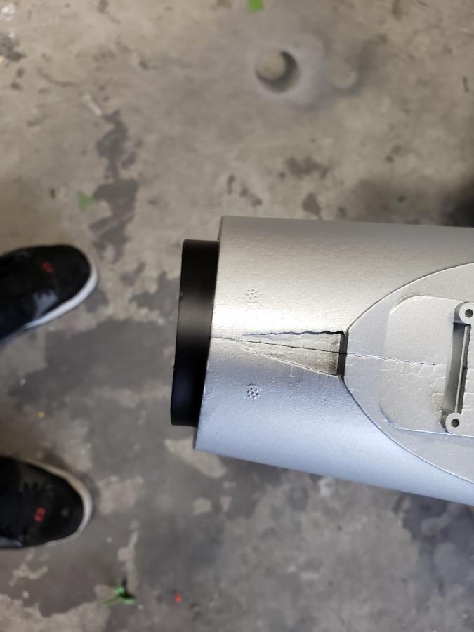

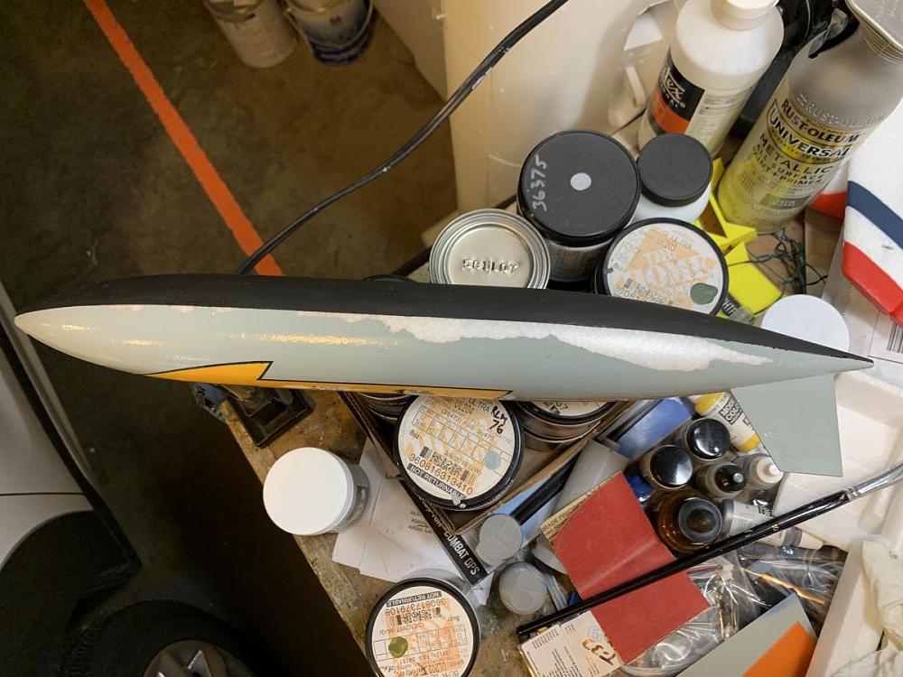

        Grrrrrrrrrrr!!!!! Click image for larger version

              Grrrrrrrrrrr!!!!!
              VDN, Yeppers, been there and it SBT. I started using post-its, yes, 3M Post-its for those types of masking. Quick spray and then pull up immediately. Mantra, "It's my hobby...it's my hobby...it's my hobby. Best, LB

                    Wet newspaper cut to the line or shape you want and then pressed gently into position works well.

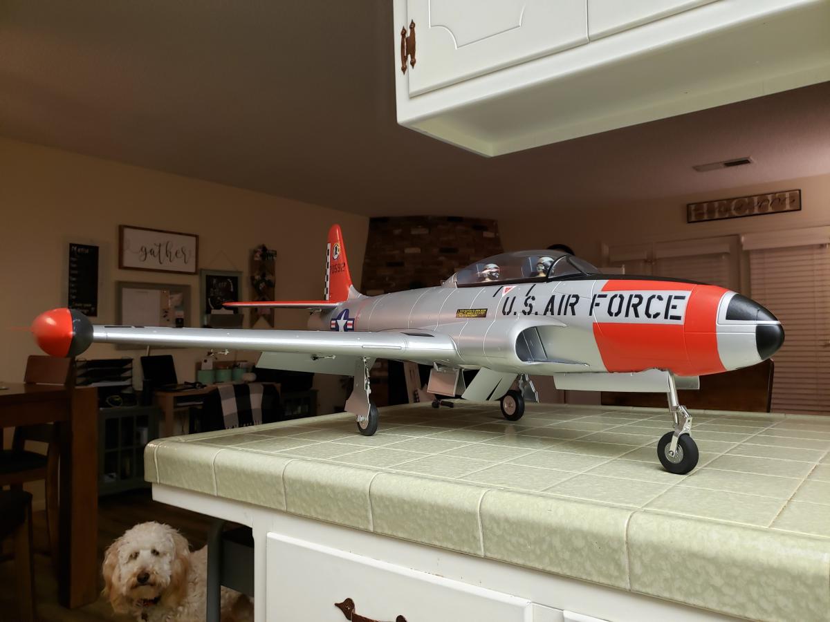

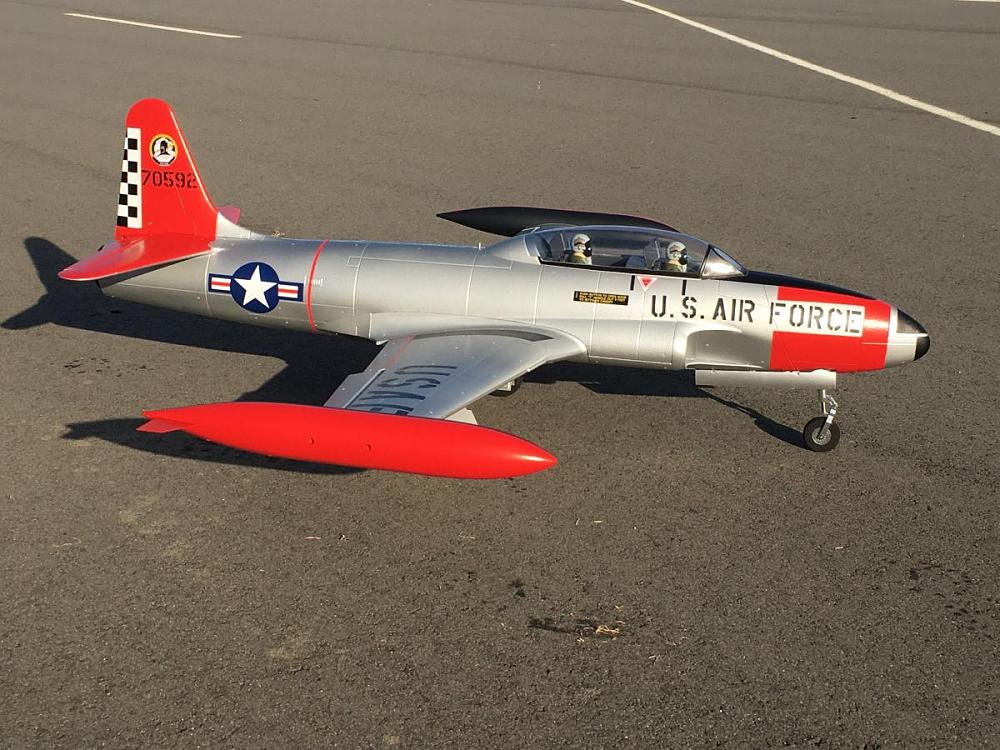

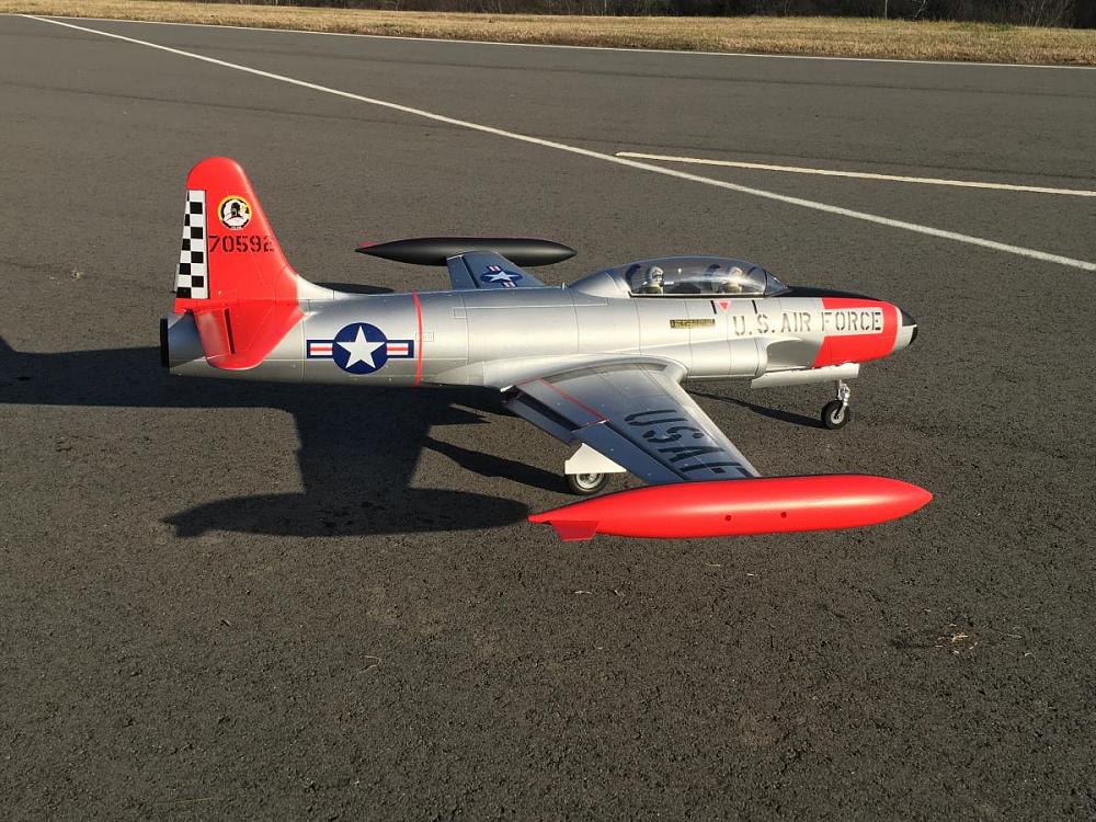

                      Click image for larger version  Name:	D4EC2BB2-B090-4D23-9E85-F6DE0A2EC23F.jpeg Views:	0 Size:	193.8 KB ID:	227573Click image for larger version  Name:	8508B0C8-5EB0-4ECE-B0AD-413F4F10804B.jpeg Views:	0 Size:	164.8 KB ID:	227572 Mine was delivered yesterday but I was out of town. Took me 2 1/2 hours to put together today and that’s including removing the blue box and re-wiring it. Four flights today all on 5200 hobby star batteries, 5 minutes (all my other 80mm planes are 4 minutes with the same pack) on the timer, flew absolutely wonderful. Motion has another winner.
                      I was thinking about repainting it but it has such a good presence and look in the air that I’m not going to.
                      I like speedy and maneuverable planes. The SS is fairly fast and very stable. I like the CG 1/4- 3/8 back from manual and for now am keeping the book rates. I did add a small aileron to rudder mix to have a smoother roll.

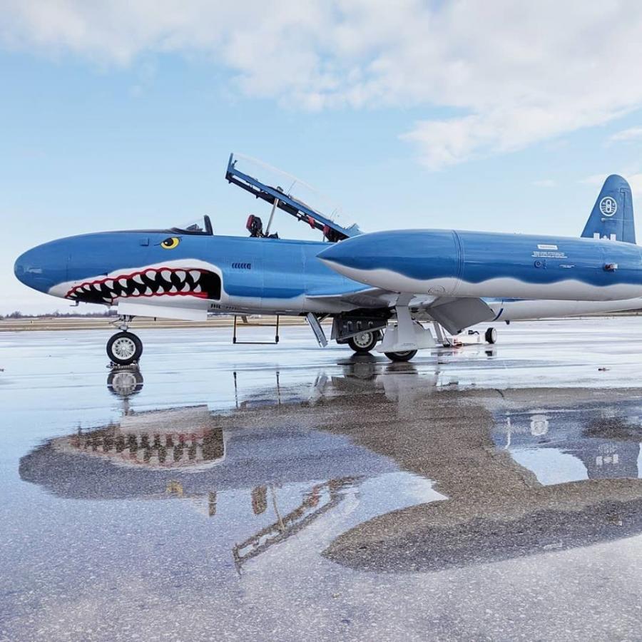

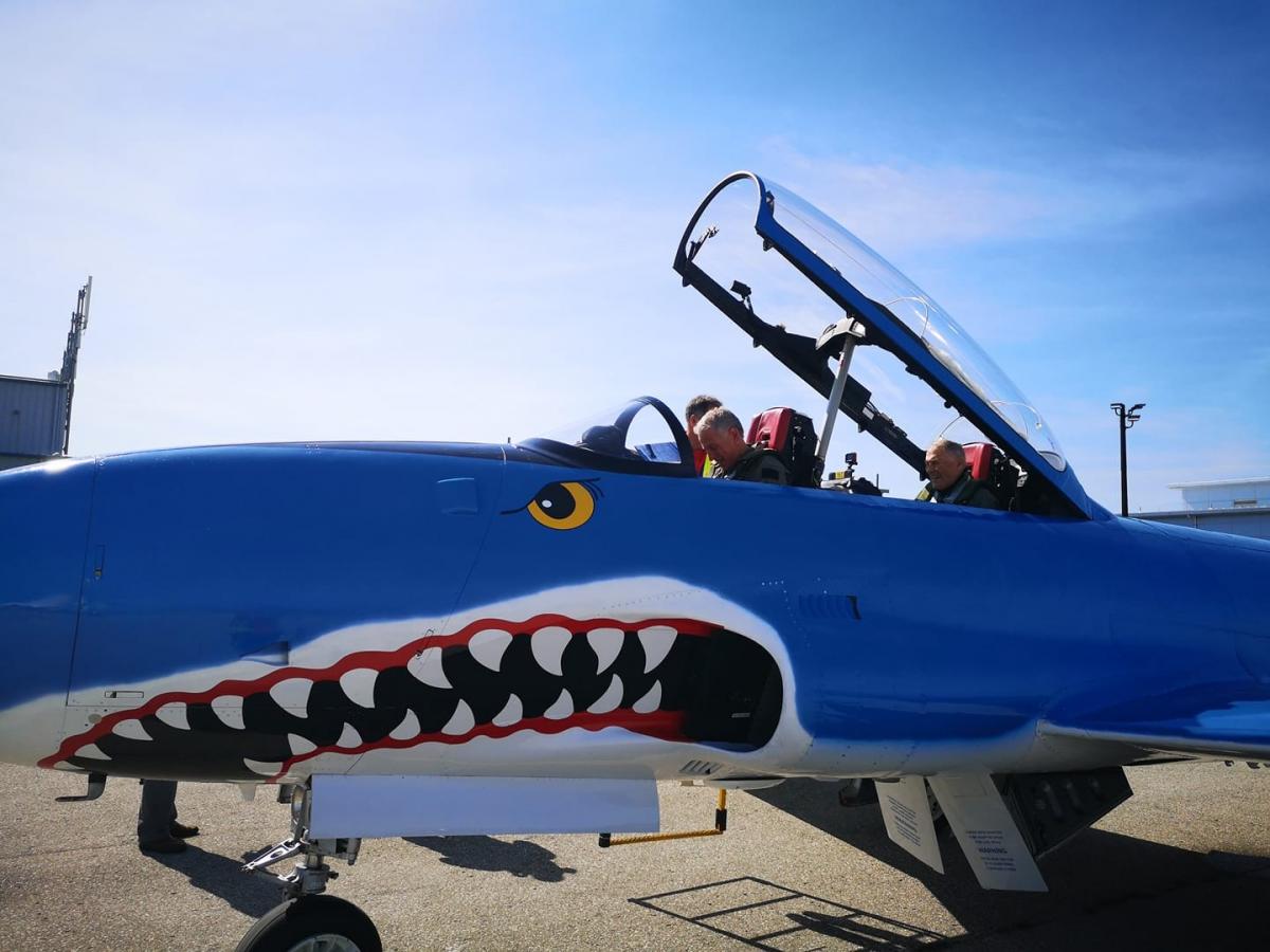

                          Still waiting for mine. Callie Graphics is making custom decals for it. Going with new livery as Mako shark Canadair CT-33 Silver Star. this plane is flown by Waterloo War Birds here in Canada.

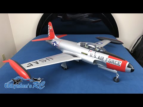

                              Here is my unboxing for the T-33!
