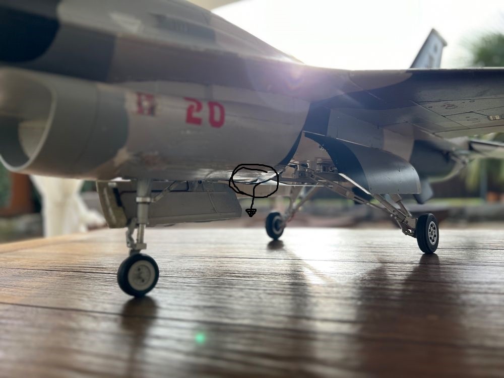

    Originally posted by EDF-Jetpilot
    Thank you. Yes, the plane is really fun to fly and is the perfect size for me. However, I need to reinforce the main landing gear at the bottom of the front fuselage mount and glue it better. Braking with the wheels seems to be putting a lot of pressure on it, and it tore the small plastic part out of the EPO. But otherwise, the new model seems solid. This photo is from the internet, but I tried to narrow down the problem area. Has anyone else had this problem?
    Click image for larger version  Name:	f16-von-hsd.jpg Views:	0 Size:	95.8 KB ID:	434573
    I think it's called the Aros factor! Not on this but on others, usually the door is binding (slightly) somewhere. I usually try to straighten out any rods and clean any paint/debris on the hinges if it is binding. Remove the rod and see how free the door swings. Those gear door servos have as much torque as a wet noodle! I've even had a gear door that was slightly binding and not opening completely and it stopped the retract from coming fully down, another wet noodle!

      @Hugh Wiedman: Here, this is the part with the screw (front main landing gear cover) where the small plastic part was glued back in place and reinforced with fiberglass. The small screw sits in this plastic part and stabilizes the front main landing gear rod to the bulkhead. Heavy braking during landing ripped the thing out. Now it should hold.Click image for larger version

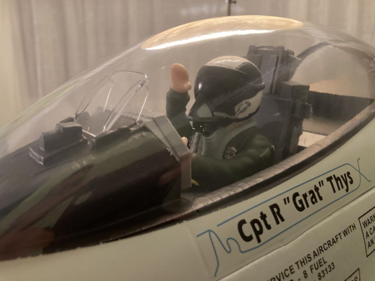

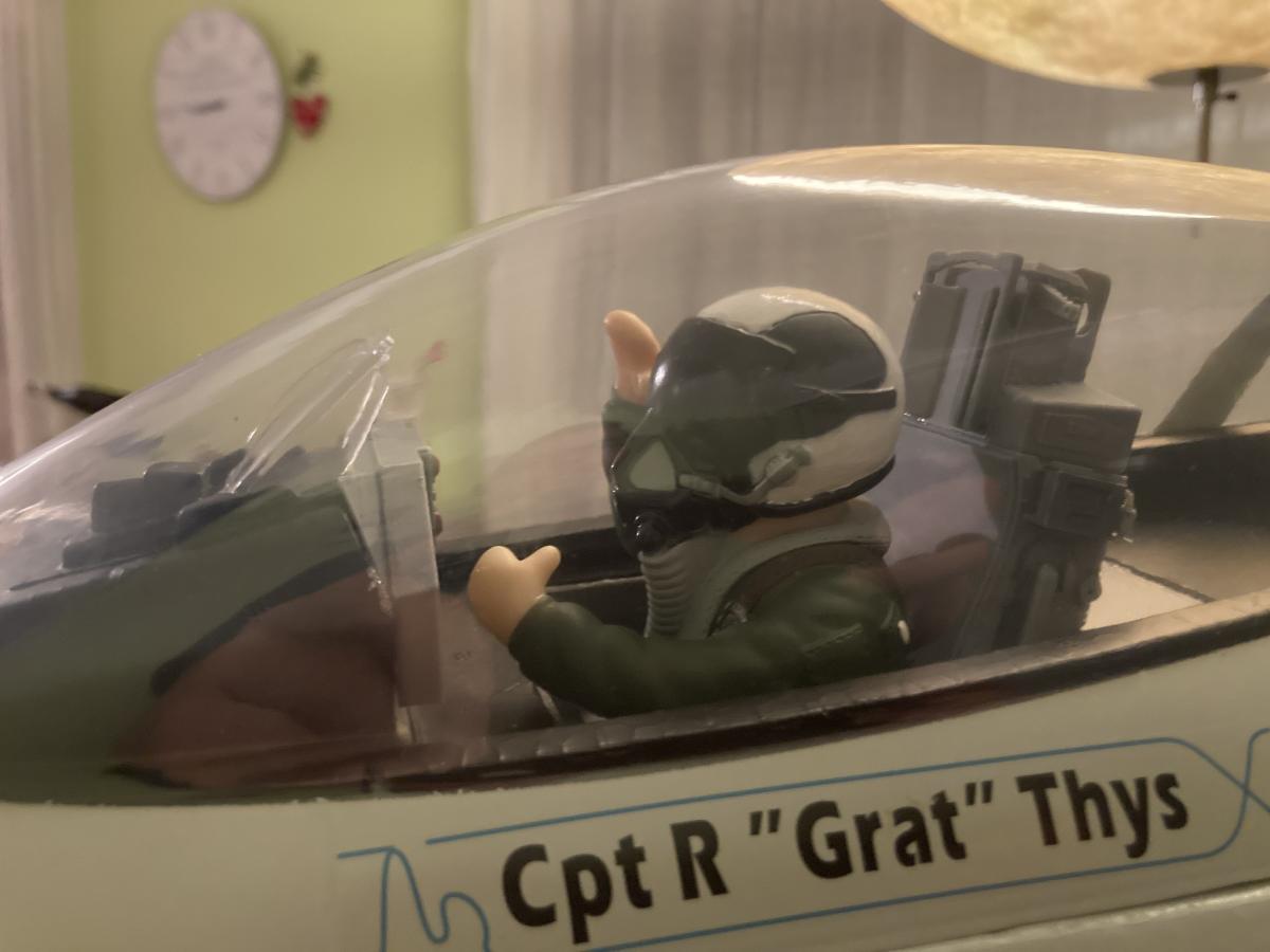

        This is my 3D printed cockpit and a pilot with movable arms that fits perfectly.
        https://cults3d.com/en/3d-model/game/hsd-f-16-cockpit

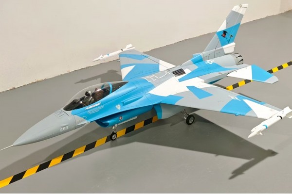

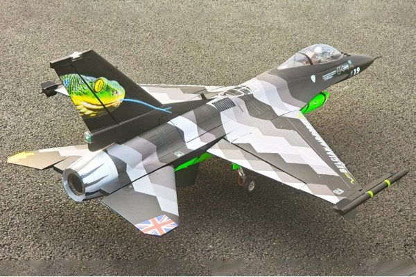

                  Looks like HSD might be coming out with a couple new liveries. I spotted these on a random website yesterday.

                      If that's true, I'll freak out and buy a second one in the Belgian livery (Dream Viper).

                          That is awesome, I will take the Aggressor livery myself if I was to get another F-16, but that Viper livery looks great though.
                            #413
                            That Viper livery has my attention.
