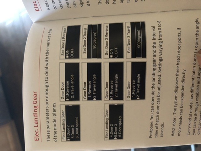

    Not sure if yeh EDF would cause enough vacuum to stop the servos from opening the doors. I’ve never had that issue on my F-16 and have well over 50 flights. The doors do not have a perfect seal so not sure how can there be enough vacuum. I would think that if the servos can close the doors after take off, more air pressure holding them open, they should have enough power to open them. The voltage for all servos in my F-16 are set to 6v and landing gear to 7.4, so voltage should not be your issue. I remember you having and issue with your rudder/steering when you added throttle, what if the issue is RF interference, the routing of the satellite wires could be a problem 🤷‍♂️
    On the MFC you can also adjust the degree of rotation of the gear doors. What if you reduce the closing end point of the servo door leaving the doors a hair open.

      Lcacing some interesting points there. HSD support did walk me through some settings to check which was to verify that the servos, lights and gear were all 7.4V (they were). However, the gear delay which they said should be set to zero was set to 3 seconds. So I changed that. Finally, gear current was at 1000 mAh for 1 but 3 was set at zero! So I switched that to 1000 mAh as well since they said both 1 and 3 should be 1000 mAh. It will be interesting to see how those settings affect it.

        Aros I assumed you had the MFC all setup by now including the gear motor limit currents which need to be 1A (1000mA). This is why I went down the servo replacement rabbit hole...by all means please make sure your MFC has all settings right before doing anything else. HSD Support can give you all the settings and you will have to go through the menu tree in the MFC and double check. In your previous posts it sounded like you already went through the MFC settings including servo voltages etc. Sorry about that.

          PaulZ I am all caught up on the MFC settings. Jason from support has walked me through all the settings to double-check. Turns out there were a few that needed to be changed, mainly the gear motor currents on 3. I'm curious as to why these weren't already the settings from the factory? Maybe just a QC check was missed or something. I plan on testing the gear today (I need someone to hold it for me while I go through the gear cycling and throttle changes).

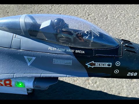

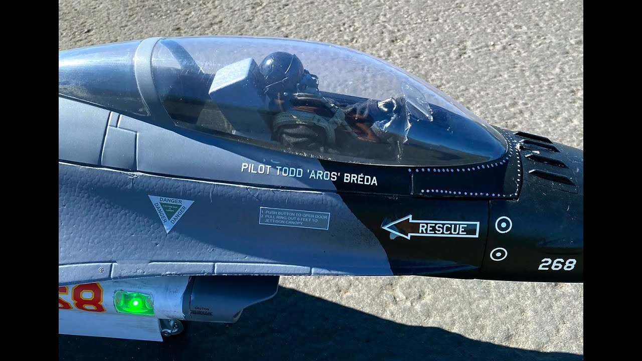

                                Added the quintessential 1/7 scale pilot from Warbirdpilots.com as well as a green LED for the HUD just for fun. All that's left is to add RCGeek's centerburner, a little more weathering and hopefully I have a jet I get to enjoy for many seasons ahead.

                                  Awesome, Aros! I love the pilots from Warbirdpilots, and that HUD LED also helps set off the look.
                                    #237
                                    Thanks bud! Yeah I love his pilots...I always feel so guilty amputating their legs to fit the cockpit but they don't need 'em anyways, lol.
