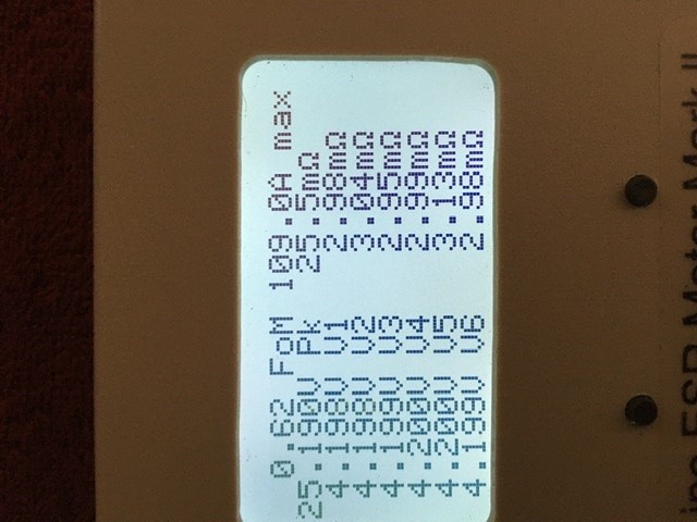

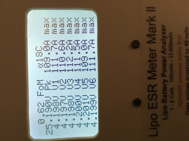

                      C ratings on lipos is just a hype IMO. Every time I see a battery claiming 50c or above I just laugh. We be lucky if we get 1/2 of that, In flight the F16 pulls around 105 amps full throttle. I have a flying buddy that has one of them high end Lipo ESR Meter Mark II, he tested the roaring top 6250 35c and the results showed a “true” 18C with a max output of 108 amps so in reality even the 35c RT will work.
                      I did do one flight with a new set of RT 6250 35c and they performed well. He has not tested my new 45c but My guess they are at least a true 20c or about 110amps output.
