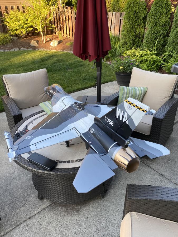

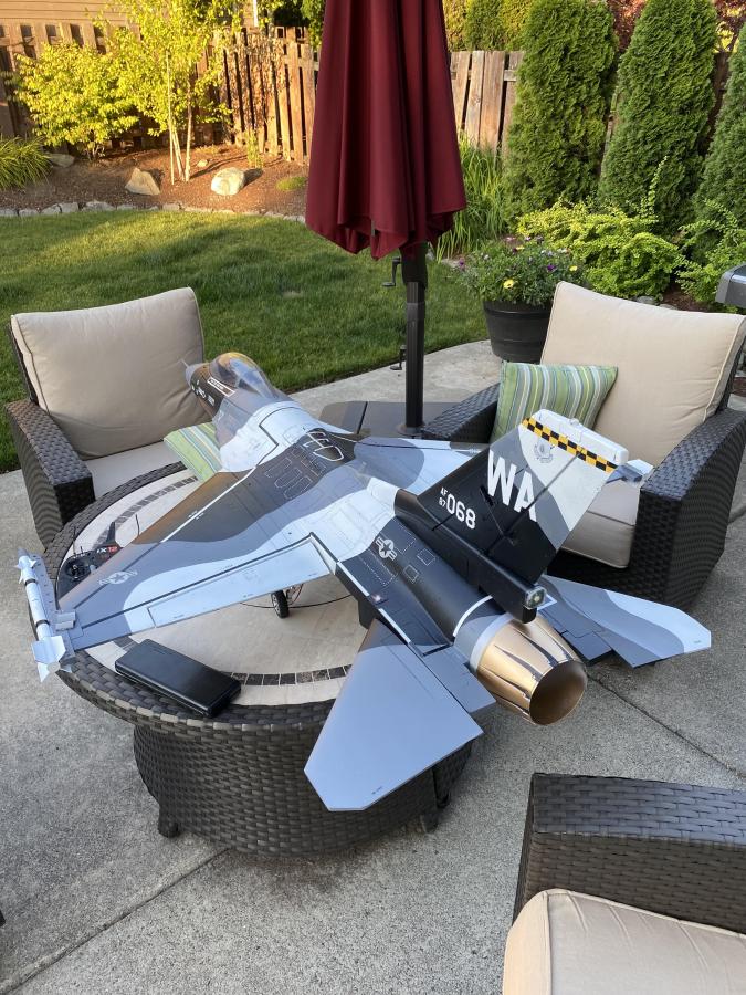

    I brought the big girl out to the patio to get the ailerons in line. Basically all I did was increase the left travel to 150% and kept the right travel at 100%. Just the ol' fashioned eye test and it looks much better.
    Sigh. Why can't this bird just be simple and fly fantastic for me from the start like others seem to have no issue with, lol. EVERY 3 models I've had (V1/V2/V3) gave me issues to the point of questioning my skill level. Just like the LX SR-71...
    My muse...My nemesis.

          Aros Sounds like you have some bad luck with this one. Not sure what to make of the aileron thing...you sure your TX is setup correctly? That should not happen.
            #185
            PaulZ I think it's something in my radio settings but I cannot find the source. All travels said 100%. I need to look at the sub trim menu as I may have forgotten that. These settings came from my old .SPM file from my last HSD F-16 (V2). I just assumed if I had everything working for that, it should translate to the V3. I am going to create a new model from scratch so I know everything is at 0/100% and start from there.

              #186
              Ahh, there you go. I always start from scratch on my new models. It's worth the extra 20min setup time.
                #187
                Yeah in retrospect, I should have done just that. Lesson learned.

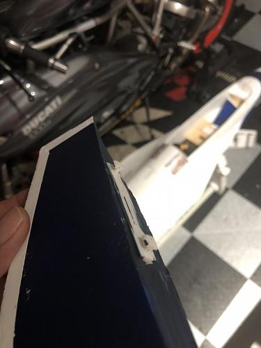

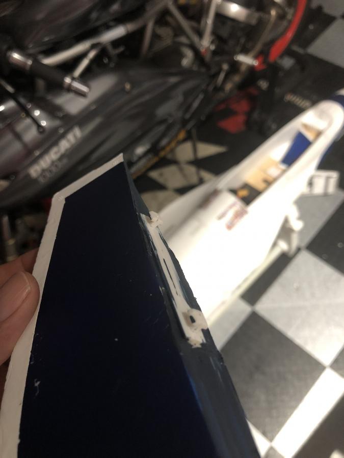

ID:	269061 Since they ventral fins got ripped off, might as well to the mod to make them removable. Use some Freewing F16 weapons attachment hardware. makes it easier to transport.
