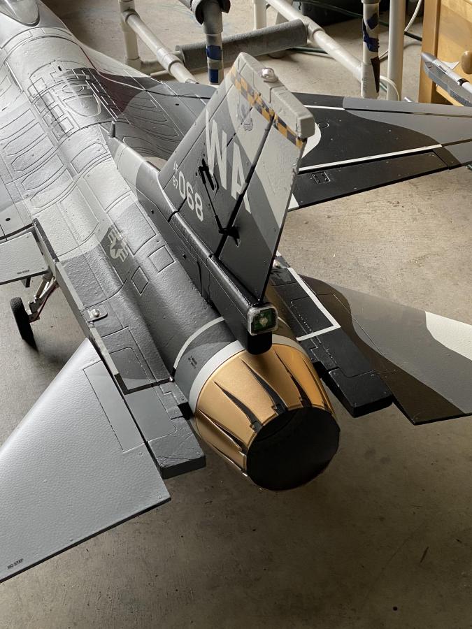

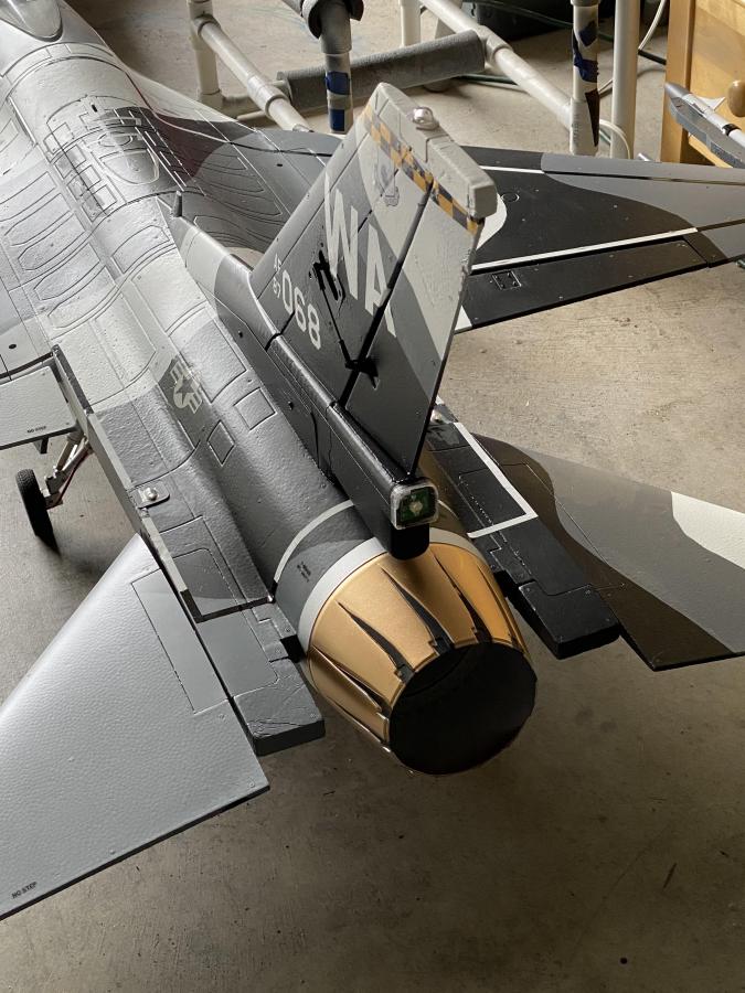

                                        Gave the exhaust a new color....I did this to my first HSD F-16...I like the contrast and "pop" with the Arctic Camo scheme...I noticed some of the full scale Aggressors have this bronze/gold exhaust and I just dig it.
