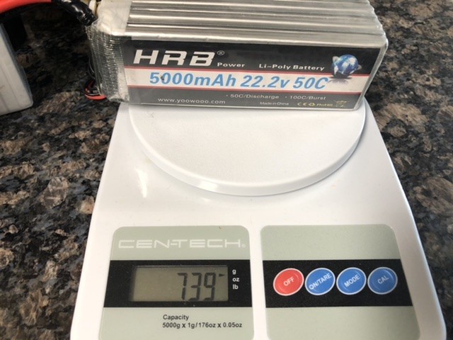

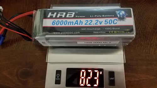

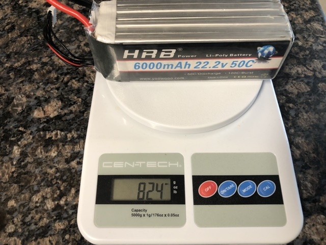

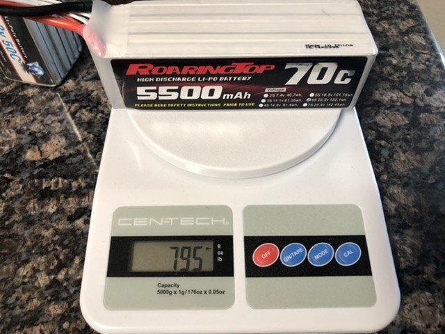

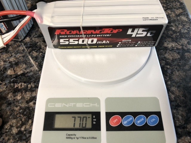

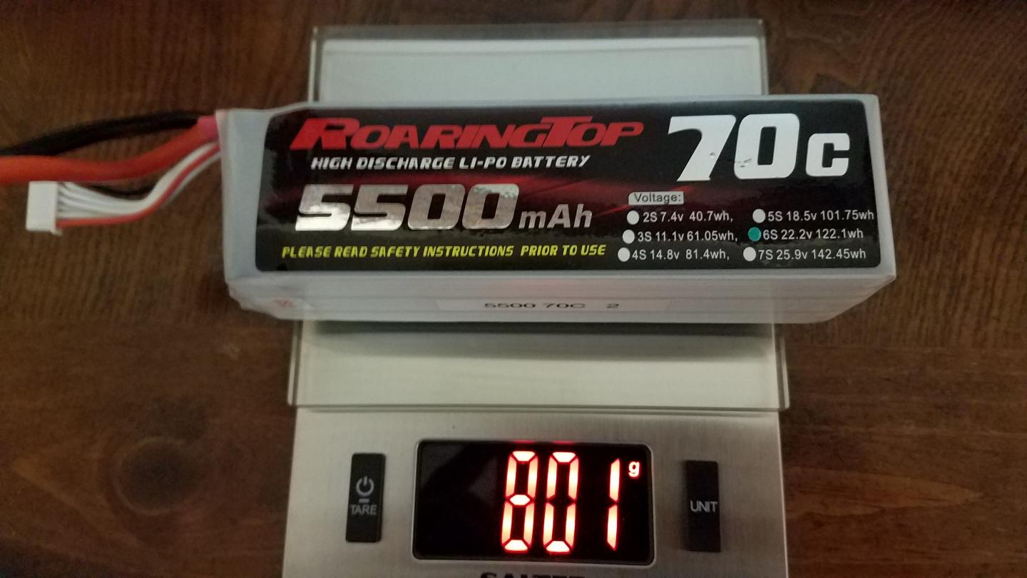

                            Here are the weights off the batteries, I don’t use the HRB 5000’ in the F16 simply because I prefer longer flights, I can essentially use the other 3 in the same position and the plane still feels locked in. I haven’t felt the need to go further back than 175mm (gear down) because as PaulZ mentioned, you end up having to add elevator mix to compensate for a tail heavy plane during landing.
                            From what you described it sounds like you have some gremlins running around. Lol. You mention your batteries are at the leading edge of the black foam, check out where mine are.

                              Oh wow, that's really far back Lcacing ! I need to get a CG stand soon so I can really make sure my CG reading is accurate. Thanks for the photos! Hugh Wiedman no worries! Whew, I'm just glad we weren't way off on the weight spec, lol...Maybe I was really nose heavy after all on the maiden. That certainly would explain the extra long takeoff roll and having to give it a ton of up trim.

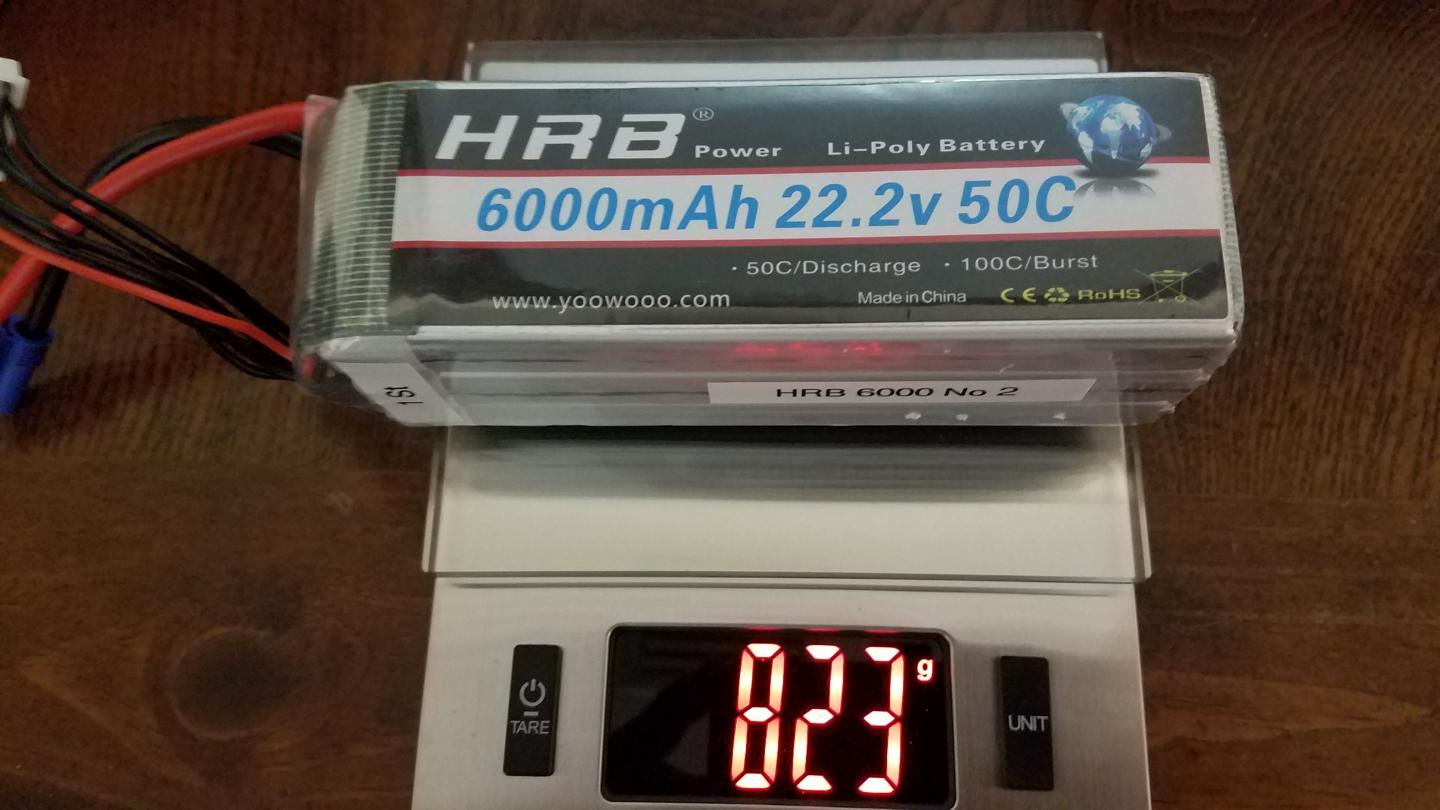

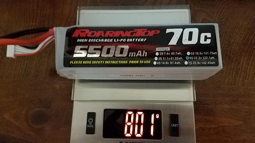

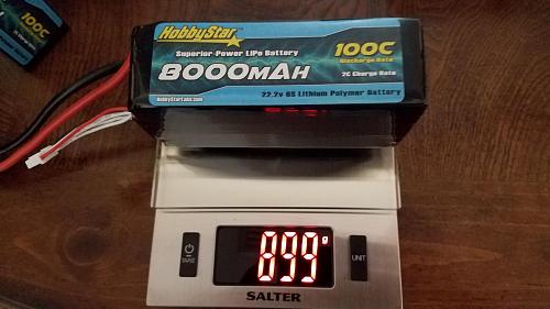

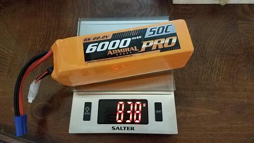

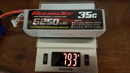

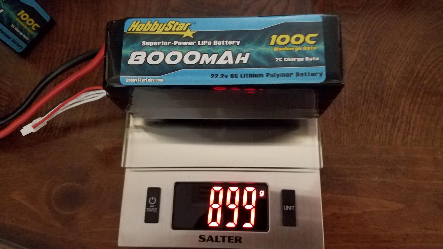

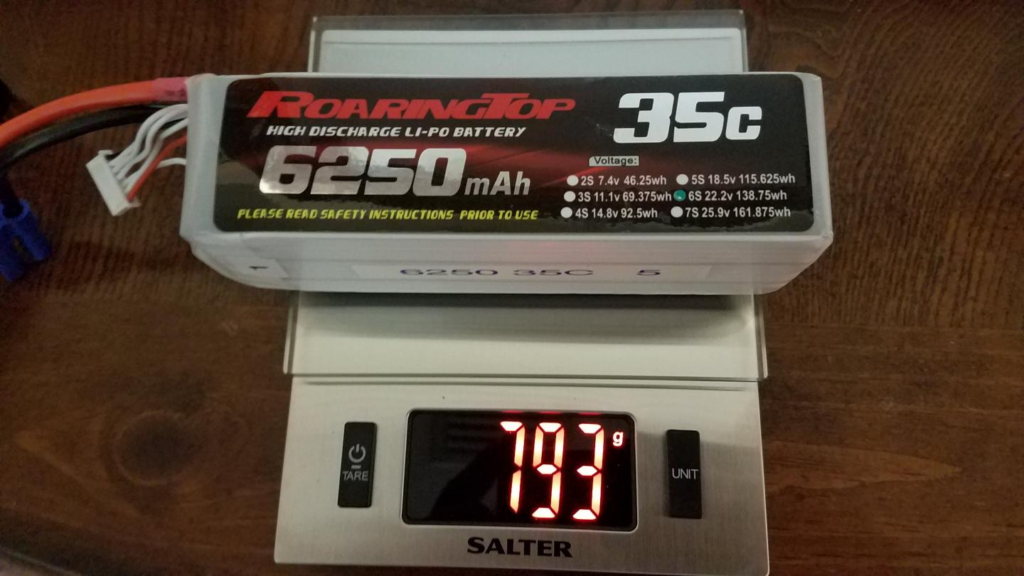

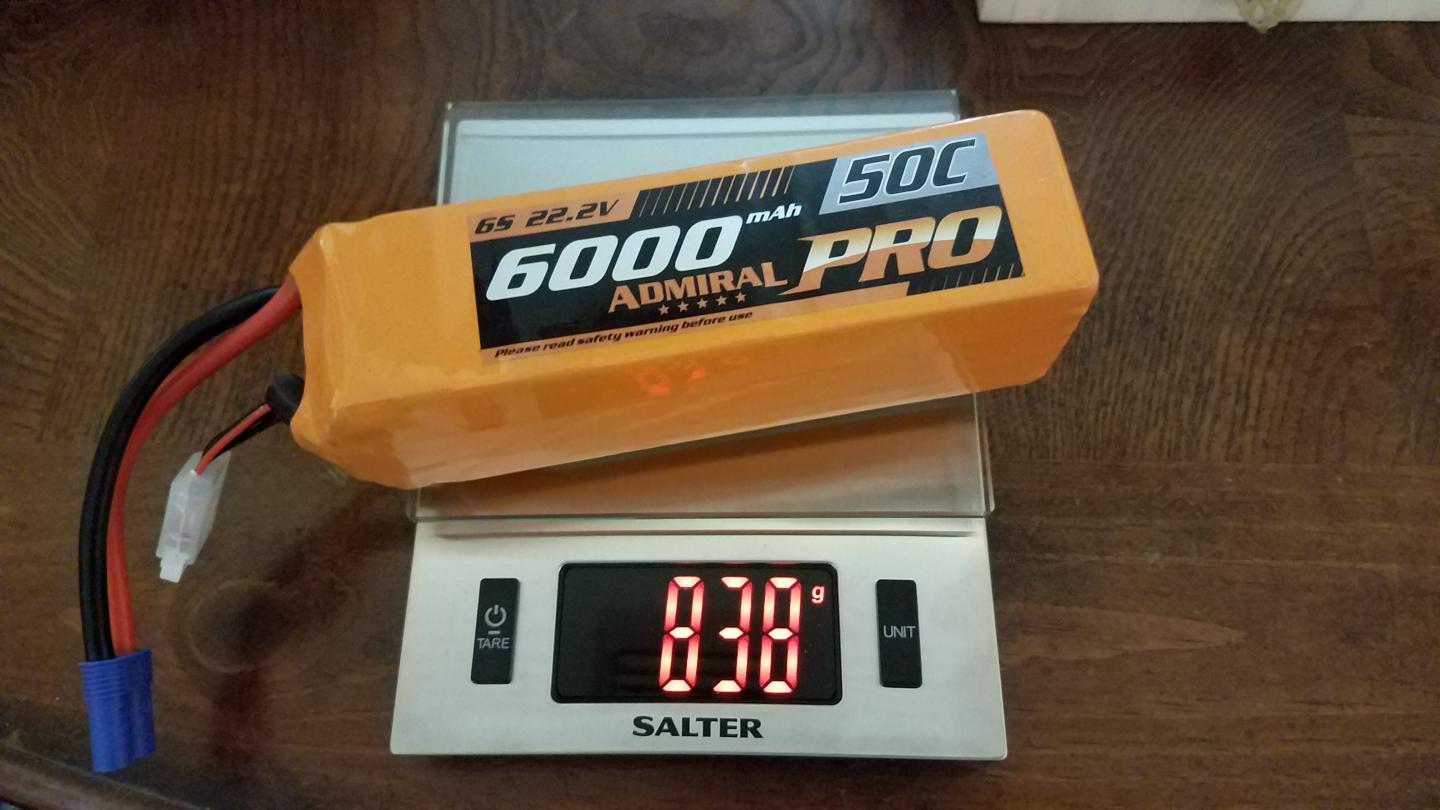

                                      Lcacing Looks like I have almost identical weight measurements given there is about a 3-7 g difference in each brand of battery from one to the next, virtually negligible. I've added photos of the weight of a couple more batteries for those interested, the Admiral 6000 50C, the RT 6250 35C and the Hobbystar 8000 100C. The weight of the Admiral is not a typo, it's the heaviest of the ones listed below (except the HS 8000), but it also tests out to have the lowest actual C from tests using the Progressive RC internal resistance meter (lower even than the RT 6250 35C). A quick table of the 5 with weight and actual C measured follows:
                                      Battery Weight Actual C Cost
                                      RT 5500 70 C: 801 g 35C $120
                                      RT 6250 35 C: 793 g 28C $ 93
                                      HRB 6000 50C: 823 g 33C $ 78
                                      Admiral 6000 50C: 838 g 26C $124
                                      Hobbystar 8000 100C: 899 g 28C $180
                                      And there is a big difference in the power draw on an inrunner when using the RT 5500 vs the Ad 6000 (even though the actual C difference is 35C vs 26C). In my tests, initial full throttle on a RT 5500 70C was 118 Ah & 2810 Watts on the 12 blade 4068-1835Kv inrunner, and on the Admiral 6000 it was only 110.2 Ah and 2478 Watts, definitely noticeable on take-off. So Admiral needs to catch up. I'm not bashing Admiral, I have over 70 of their batteries and never had a problem, they just need to address the higher mAh 6 cell, with lower cost and higher actual C to compete with RT and HRB.
                                      You can see that the Admirals are the heaviest of the 5500 to 6250 mah batteries but also have an lower actual C and unfortunately the highest price. I no longer use the 12 Admirals in anything, just the RT 6250 in all the outrunners (they don't need as high a C as the inrunners from my testing) and the HRB 6000 in all the inrunners. I also quit using the 8 RT 5500 I have, although it has the highest actual C tested, I wanted longer flight times where I was using them in my F-16 and SU-30. Now I only use the HRB's in those (and at $78 per battery, best value) and the Hobbystar 8000 in the F-16. It was too heavy for the SU-30. I know the actual C of that is low compared to the listed 100C, but I was actually surprised it was as high as it was, with 8000 mah and only an additional 75 g of weight, I knew it wouldn't test out anywhere near advertised. But my upgraded inrunner in the F-16 likes it, flies virtually the same as with the HRB, just an extra minute or more of flight time.

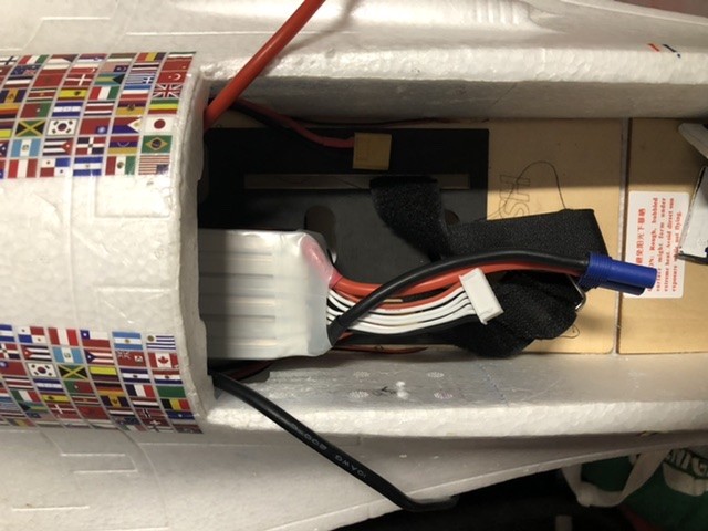

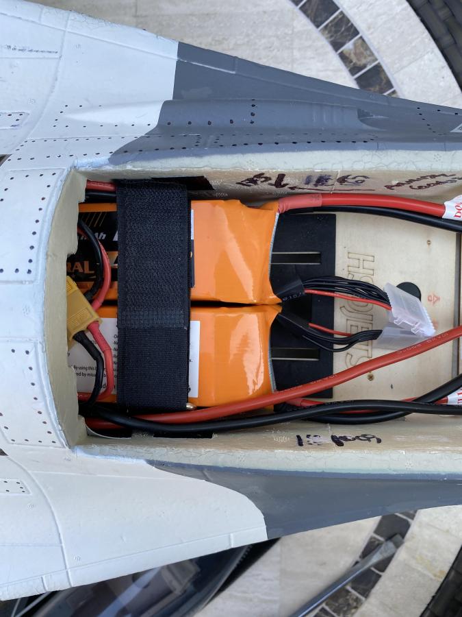

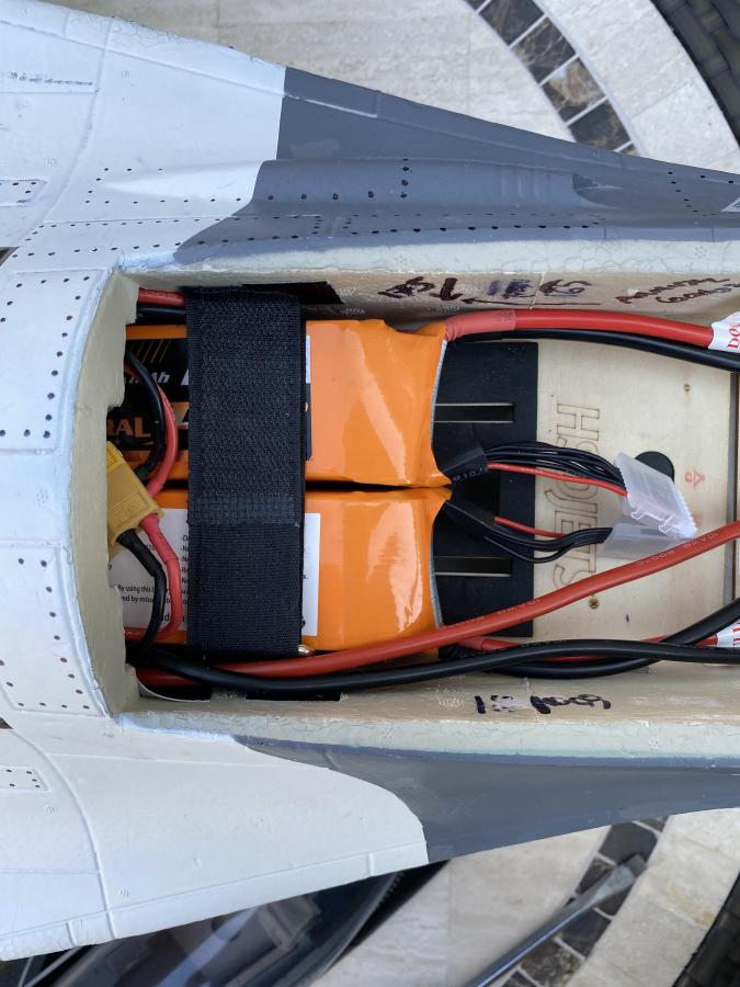

                                          Okay I was able to get a more accurate CG measurement. Here is the location of my Admiral 6000s (photo below) for a 175mm CG which a lot of flyers have found success with. It's quite a bit aft of where I had them for the maiden so no wonder I was having takeoff roll issues and maxing out my up trim. I was probably flying around 160mm if that! Yikes. I am feeling a lot more confident with this placement for the second flight. I also found out about a church in Graham, WA (about an hour drive from me) that welcomes RC flyers and it is a nice relatively long runway with no immediate obstructions. So I may go check that out this weekend.
