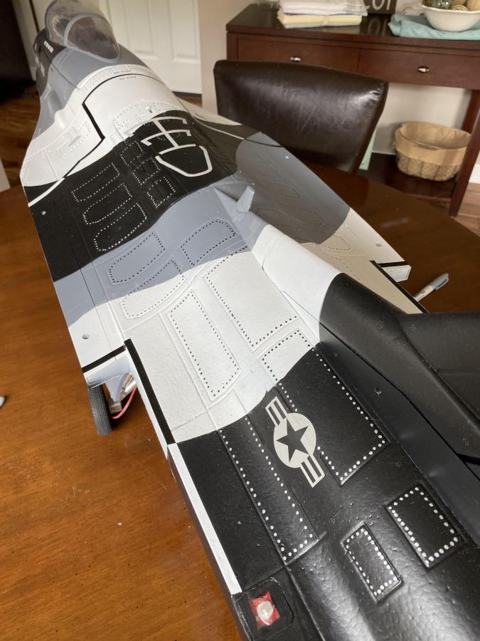

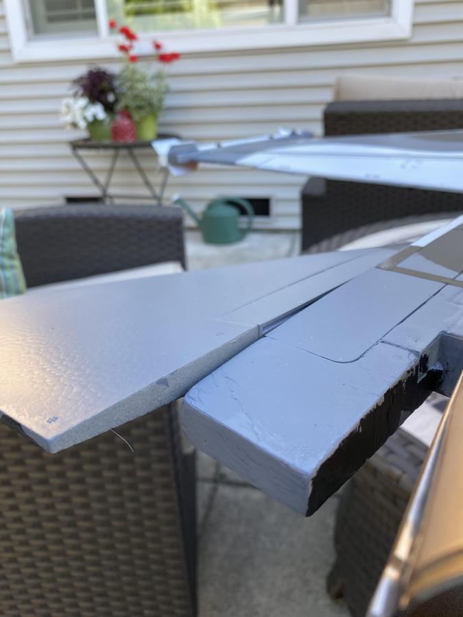

          Can anybody help. This experience I am having with HSD jets has been painful. Purchased the last grey PNP f16. Arrived with nose compressed. Worst part trying to get a hold of someone on the phone forget about it. Unfortunate part of all this I will be heading back to work soon for 4 months overseas. I was on a pretty tight deadline to try to get this thing in the air. Decided I would just keep it although it's been compressed in the front so started programming. This is where I run into more issues had the right airleron servo burnout. Had it almost dialed in through the MFC then ran into issues which caused me to factory reset it. After speaking with Andy at HSD he seemed to be a little upset with me that I factory reset it and he now is having someone have to hand write out the whole manual for me and is telling me it could take a couple days. 20 years in the hobby and its pains me at this level at this price the customer service I have received. Begging for someone to call me.
          • reefbreak
            • Jul 2020
            • 3
            #125
            All the pictures I see online of this jet are beautiful the one I was shipped never was. Can anyone help. I also purchase motions F16 super scale and its immaculate.

              #126
              That's terrible man I'm sorry to say but it appears you got one of the lemons out of the batch. What version is yours? This is my third one and I've never had any problems with mine. I would personally try to return it if at all possible. That nose compression is severe. Sure in a perfect world you could repair it and replace the servo but for what you are paying you should expect better. See if this link below helps at all...Good luck!

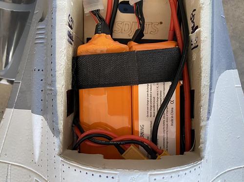

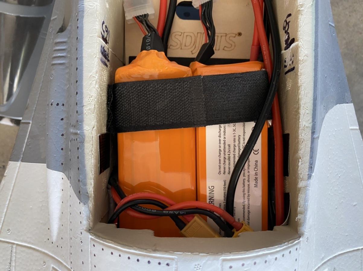

                                  Aros I would recommend to move CG about 10mm behind the book CG. I know that sounds weird but that is where I ended up after a month of testing. My 5000 packs are basically as far back as they will go, they are touching the foam edge that is in there on both sides of the fuselage. I would then trim the elevator for level flight at 1/2 throttle. With this setup she rotates well and lands high-alpha with ease. I do have a mix setup when the landing gear deploys to give it about 5% down elevator. That compensates for the CG moving even further back as the mains are pretty heavy. That is how I have been now flying for a couple months with no issues.

                                    Great info PaulZ , thank you! So where is your CG at specifically? Also, would you mind taking a shot of your battery placement? I am running two Admiral 6000s and they are near the LE of the black foam. I couldn't move them much further aft if I wanted to. Also, are you running on Spektrum? If so I would love your SPM file. I am always searching for that "Sweet Spot" with this girl.
                                      • 8228
                                      #138
                                      Here’s where my battery placement was for the maiden.
