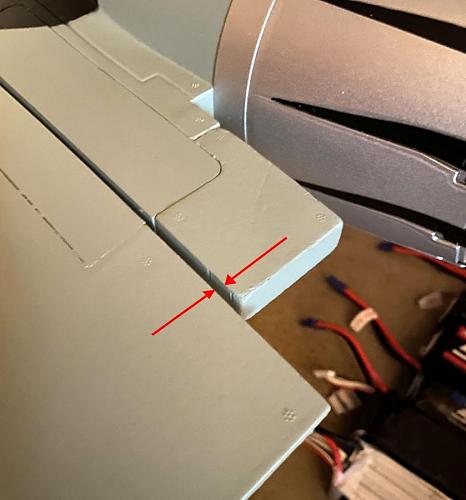

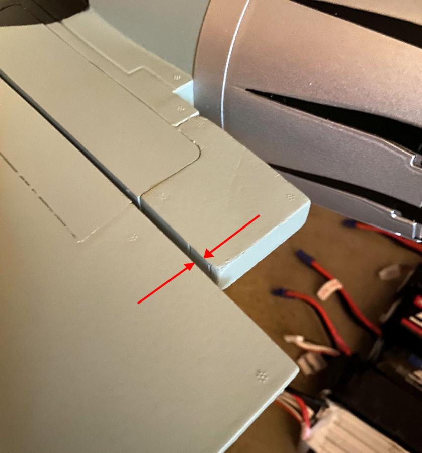

                            Guys, with the the CG closer to 170 and no TH-ELE mix where do you have your elevators for level flight? Manual has them at 5mm from bottom edge of the fuse, I'll start with 2mm and see how she flies.
                              #34
                              PaulZ I haven't been able to setup my new one yet (waiting on the 2S batteries to arrive tomorrow) but I believe I recall on my first two that the trailing edge of my elevators always aligned with the trailing edge of the fuse (see photo)...

                                PaulZ 2mm is about where mine are. Didn’t see any trim adjustment from 168 to 170. The elevators are not neutral even at CG 170 so probably there is still room to move the CG back a bit more. I might try 175 next time I fly.

                                    Thanks Lcacing I just flew a bunch today. I am going to move the CG even further back next time. I was at 168mm and had to trim the elevators right down to the edge of the fuselage, too far in my opinion. The book has CG at 178 and I am wondering if that may be better. Still without the TH-ELE mix...that thing is truly unnecessary.

                                        Yes that is where they "should" be on most F-16's but it will still nose down unless you move CG back closer to 170.
