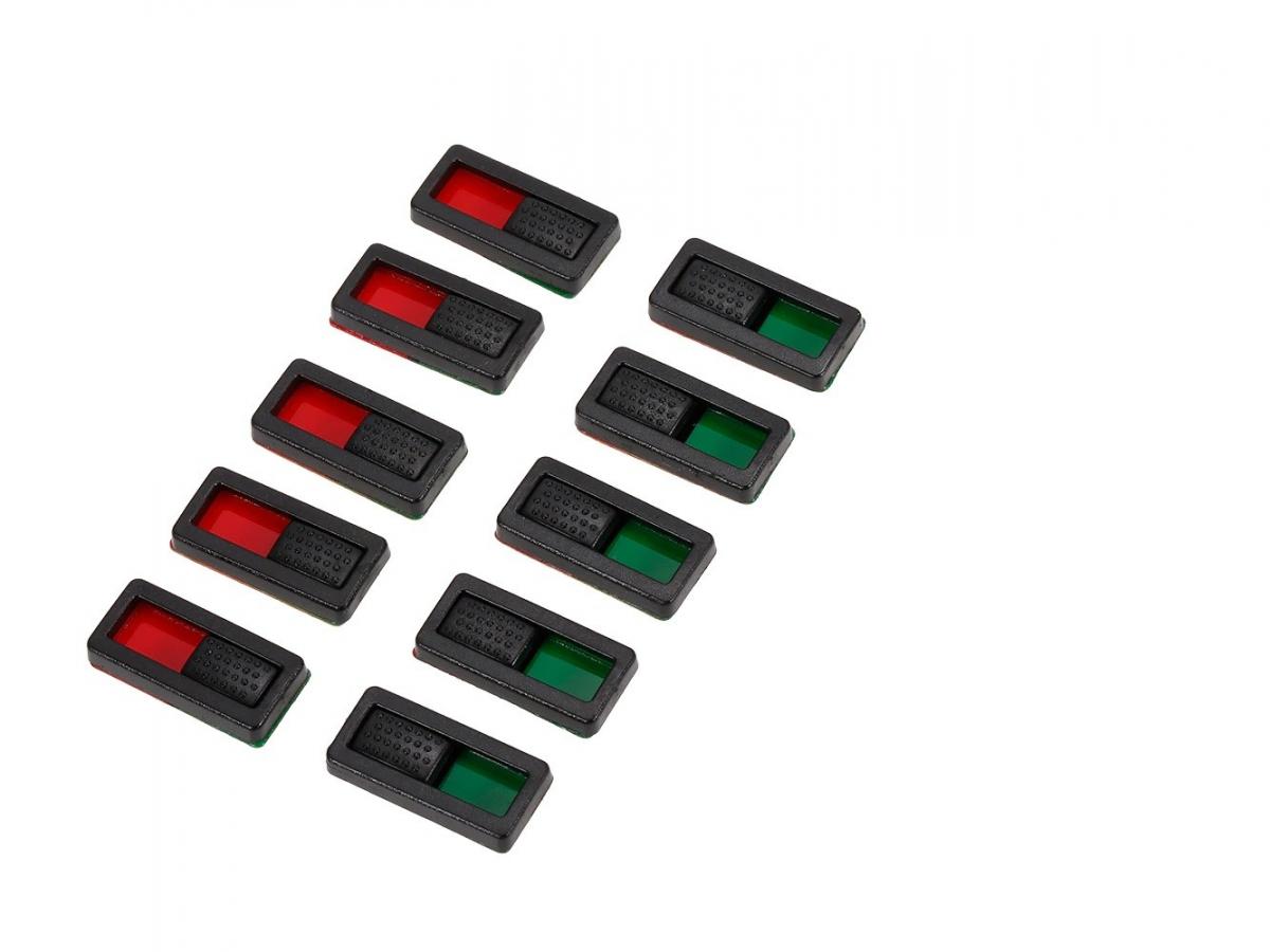

                                • I use these. They are very inexpensive and work like a champ!
                                  • Pretty slick! Tiny, too. 2cmx1cmx0.2cm
                                    Link follows....ordered some!

                                      • Originally posted by GliderGuy View Post
                                        https://www.amazon.com/dp/B06Y6JM98R...V0PQ7GJVGJAB39
                                        -GG
                                        That's where I usually get them. If I'm ordering from Bang Good I'll order some as they are a bit cheaper there.
