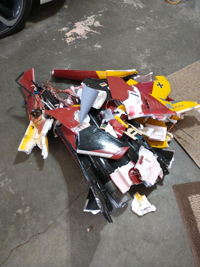

And she is no more... One moment without proper thought and disaster. I flew a normal flight and went to land. On downwind I flipped the gear switch. Without thinking, I then flipped the flap switch. The plane immediately pitched down out of control with no effect from the elevators. My normal procedure was to lower the gear and wait until the plane had slowed to approach speed before lowering the flaps. This time I just didn't do the right thing.
This is the second major crash due to the planes "interesting" aerodynamics. I'm done.
It's more of a structral issue but then again... sorry for your loss.
Hope the MiGs from the next batch have improved on this aspect.Comment
Sorry to hear of this. What a mess! So we can learn from your misfortune, did you go full flaps or 1/2 flaps first? Also, did you have any kind of deployment slowdown on the flaps or did yours instantly go to position?Comment
Sorry to disagree, but this sounds much more like an electrical issue as I've been saying all along. If he was running everything thru the BB and it is limited to 5.1V, he probably overloaded the system with both gear and flaps running... and elevator! Lose voltage with all these operating simultaneously and you will lose elevator authority. I'd like to know if his system was stock or what.Fly low, fly fast, turn leftComment

That's brutal...You pooped in your pants...Expensive....And she is no more... One moment without proper thought and disaster. I flew a normal flight and went to land. On downwind I flipped the gear switch. Without thinking, I then flipped the flap switch. The plane immediately pitched down out of control with no effect from the elevators. My normal procedure was to lower the gear and wait until the plane had slowed to approach speed before lowering the flaps. This time I just didn't do the right thing.
I went to full flaps with no delay. The jet pitched down immediately and I only realized what was happening about a second or two before impact.Comment
“Stock everything”...,does that include the wires driving the 425BBs? Or did you install a larger gauge wire when you upgrade to the 425BB servos?
Bypass the BB with elevator? Stock push rods?
