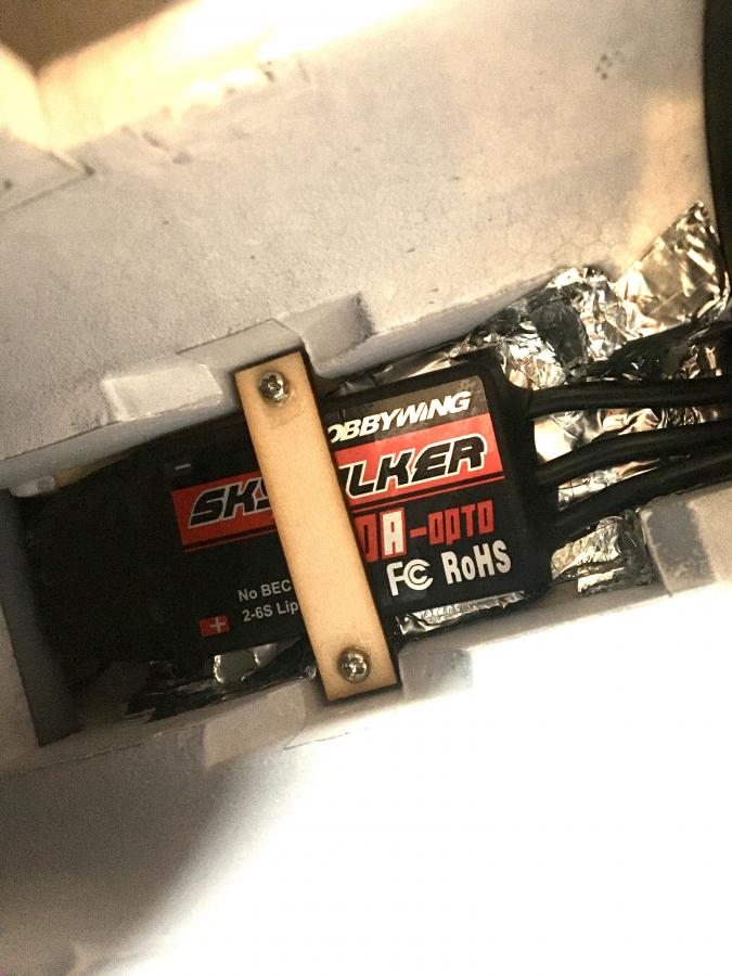

                There ya go! My idea of wrapping an ESC with a foil, was at least a step forward! "But, regardless it will have some effect when placed between the ESC and servo wires to help minimize the potential noise on the servo wires back in that area..." Of course, shielding needs to be grounded to have the right effect, but the bigger claim was the EMF from the battery cables that add to the problems...

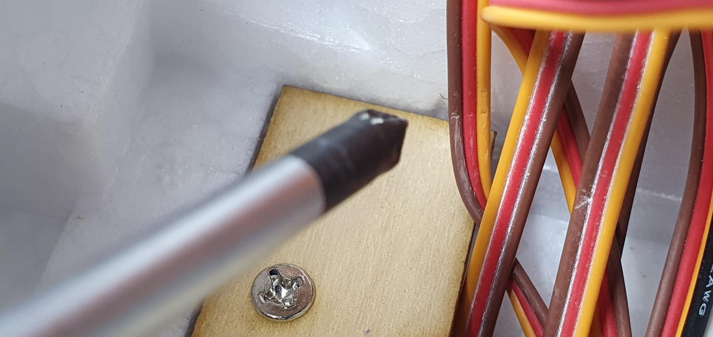

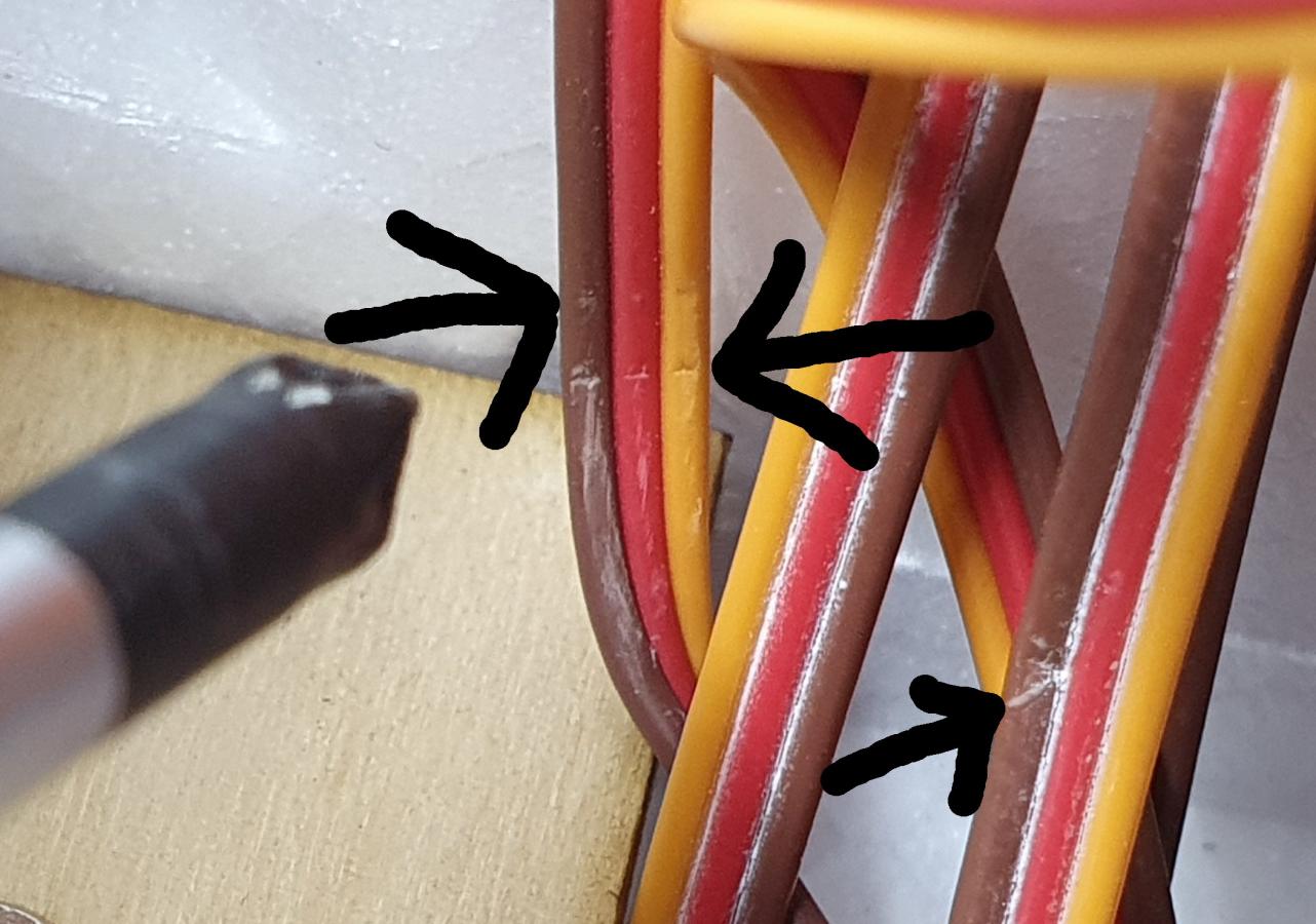

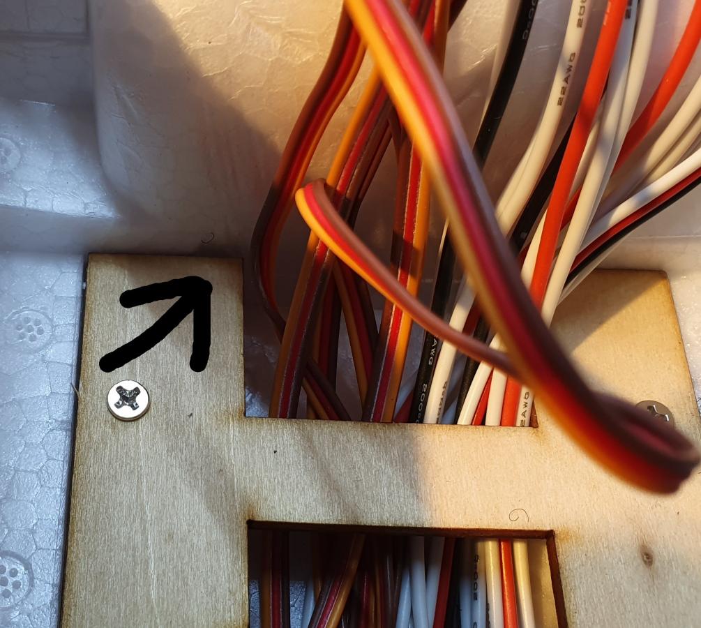

                  this may be redundant, but as the elevator issue is still not resolved (Does it exist or is it all bad luck and misinterpretation? If it exists, then what is the cause?), I am crossposting this post from me from RCG:
                  Under the most rearward battery compartment, there is a "snake pit" of wires that go
                  • towards the blue box
                  • but also directly to the receiver, such as the throttle.
                  These wires are routed below the wooden panel that serves as a battery holder. Fine so far.
                  In my case, at least one servo wire was emerging from below the wooden panel improperly, namely it was sandwiched (by the factory) between the frontal end of the wooden panel and the foam. I had to manually pull it out, and it showed stress marks: You can see the effect of the relatively "sharp" edges of the wooden panel onto the servo wire. All three leads of the servo lead have little horizontal cuts, the lower cut being more pronounced than the upper. You can also see the indentation of the foam from the wire on the pictures. The little cuts as seen here look harmless.
                  However, suppose that the plane flies, the fans emit vibrations, and the edge of the wooden panel actually would saw through the shielding of the servo lead. With bad luck, you could have a short, possibly only temporary while the engines are running and vibrations are strong. This short is on the "active end" of the blue box, i.e. the end from which the control leads go to the control surfaces. Maybe having a short there does cripple / disable the blue box, even temporarily?
                  This would explain why the telemetry from one of the crash reporters showed good readouts from the receiver (including voltage), because the receiver is "on the other side" of the blue box. It would also explain why throttle response was still there, as the throttle is not routed via the blue box.
                  Opinions?

                      I only placed the “shielding” (aluminum self-adhesive pipe tape I had handy) between the ESC and the servo wire run area. The smallest of the barrel-type clip-on RF chokes fits perfect in the area ahead of the elevator servo. Photo below is prior to tucking it in.
                      Will it decrease the probability of an incident occurring? Who knows....but it is easy work to accomplish.

                          Originally posted by HK111
                          Hello,
                          Opinions?
                          Those cuts aren't deep enough. The enamel on the wire is pretty tough and hasn't been sliced. Would take a lot more abuse to slice that jacket. I've seen wires that were completely flattened; pinched; twisted; sliced and stretched and they still worked. However, if there are "quality control issues", and the reviews start piling up with defectives, then bring out General Patton with his riding crop and see who jumps!...

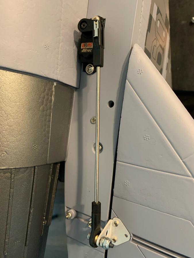

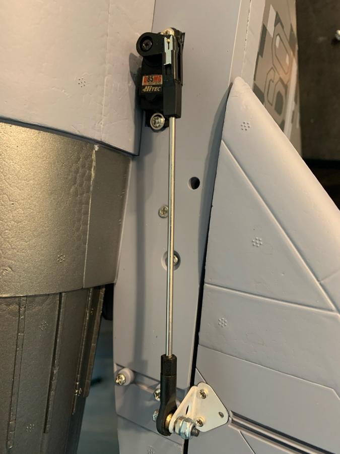

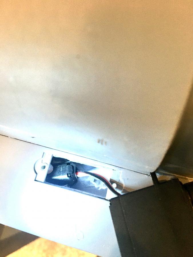

                                  After about a dozen flights with no issues I decided anyway to do my elevator upgrades today. Overall very pleased with how it turned out. Used the F-14 wing swing pushrods with 4-40 safety lock kwik links. Test flights tomorrow. (and yes, I have RF chokes, cap packs, crow in ailerons/flaps, and elevator Y to receiver).

                                        The cone shaped washer/ spacer should go between the ball and horn if you use it. Allows the ball link to be used at greater angles.
