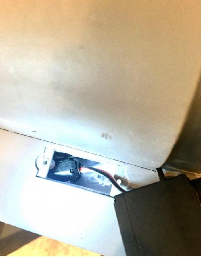

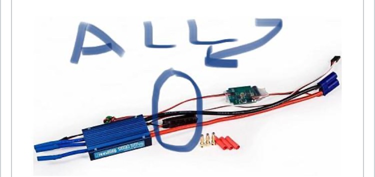

          To start with (search “ferrite” for more posts), the placement was as near to the ESCs as possible on the non-motor side of the ESCs. Since multiple wires can route through a choke, a total of 3 were added to the MiG - 1 on either side of the rear battery and, for good measure, another small barrel-type choke was added up by the green ferrite ring choke (probably overkill).
          https://www.amazon.com/Cedmon-Pieces...8870654&sr=8-4
          Later on, 2 more were added....one at each elevator servo in the rear. See photos....
          Are these the reason my MiG hasn’t had issues in about 400+ flights? Who knows. Just a data point to consider.
          -GG

            Thanks - I know about the caps on the ESC side - which are for voltage spikes to protect the ESC. I was asking about your "chokes" which are at the servos I see. Thanks for getting back to me.
