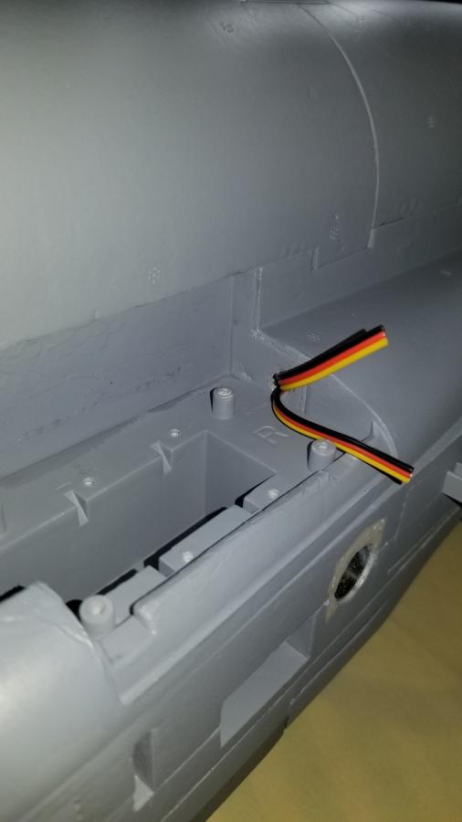

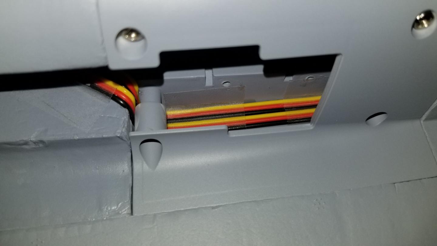

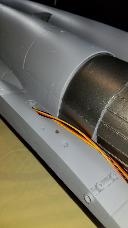

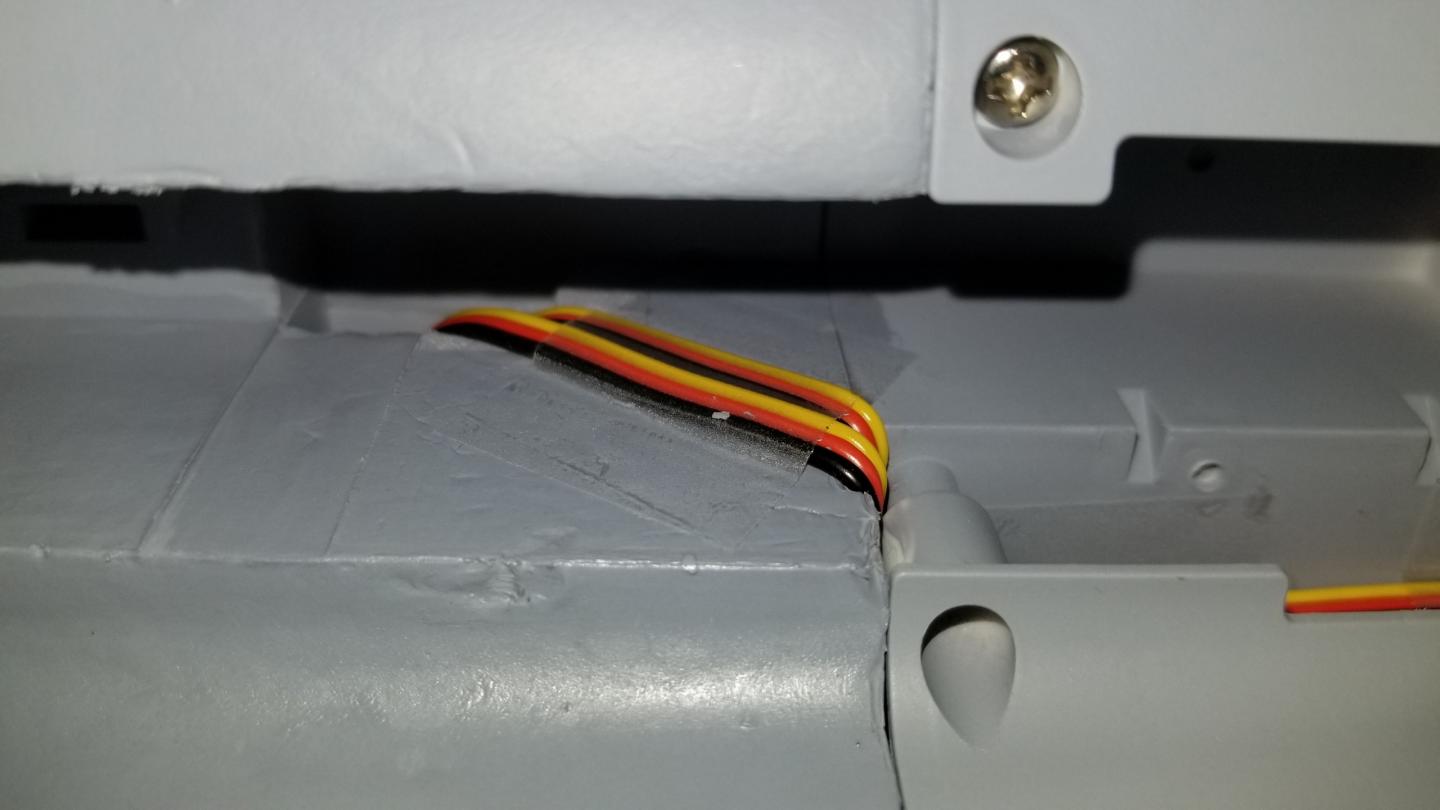

  • RC30Flyer
    • Aug 2013
    • 60
    #2461
    My new tail feather wire routing... as far away from the ESCs and power wires as I could get. Made the extensions out of the same wire I use in my 30 and 40% aircraft.
