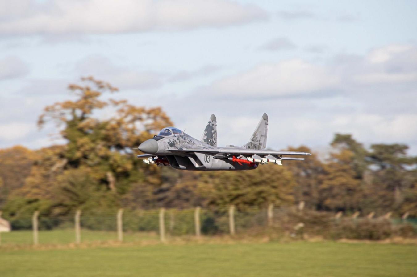

                #2287
                I chalked up another four flights yesterday, no problems whatsoever. Have to say though that it has taken a while to relax with this plane, not for any reason other than reading these 'there's something wrong with this plane and it will probably crash' posts. I expect that sales of this beautiful plane are in the high hundreds or thousands (I have no idea how many they actually have sold) but the crashes are what? around 10?
                If hundreds of people make a plane, some will crash it, either due to bad setup or bad luck. Maybe we should stop trying to identify the mystery and just enjoy the way it looks and flies?
                This is mine rolling into knife-edge flight.

                    "bad setup or bad luck"... I think the first few crashes on video where just dumb set ups and not reading the instructions. Putting the push rod in the servo's outer hole and placing batteries in the front and aft battery spots not realizing there is a middle spot and then flying it very nose heavy. While I think many new owners are now aware of these pitfalls we have to remember that the people reading these forums are a small percentage of the buyers and even those that buy from Motion and got the servo email are a small percentage.
