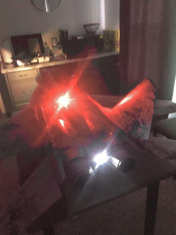

                  • I previously posted a pix showing added lighting to assist with orientation during pre-sunrise and post sunset flights. The small red LED was a miserable failure.
                    Sooooo....I mounted a Day-Brite LED taken from the left wing of my crashed A-10. It has a nice lens, too. Placed it just aft of the latch. Chose the double flash pattern on the control board. If you open and close your eyes while looking at the photo, you will see it flash.
                    Went out early this AM to try it out. SUCCESS! Great visibility even at longer distances. Of course, you can’t see it if level and the wings are in the way. But, who flies this bird level for very long?!?!
                    White position light from the A-10 helps, too. But, there is a plate or rod in the tail about 3 in forward that is a challenge to get past when attempting to run the wires.

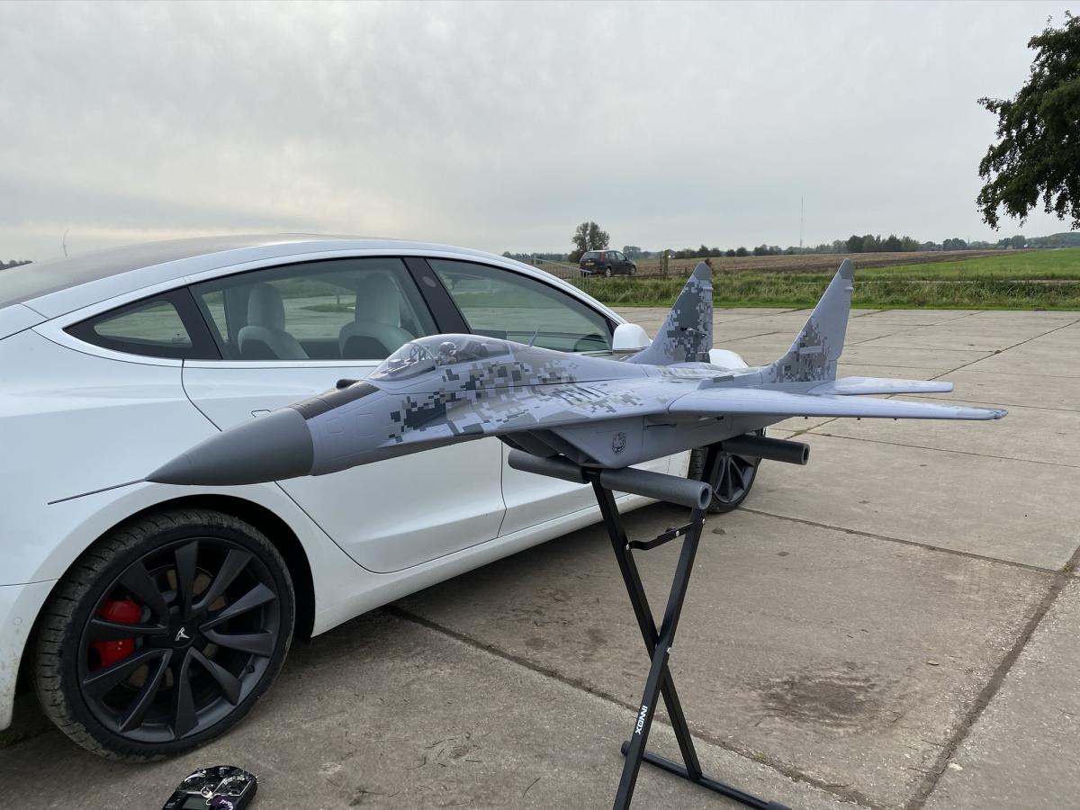

                              • Originally posted by janmb View Post
                                I use stuff like this, for all my large models too (as in significantly larger than this foamie)
                                Keyboard x Stand Sturdy double strut construction, With quick release lock, Adjustable rubber pads, Maximum load bearing capacity: 25 kg, Support depth: 40 cm, Height adjustable from 52 cm (width 87 cm) to 92 cm (width 46 cm), Weight: 4.25 kg,...
                                Add a little pipe insulation foam to the cross bars and this is a percect stand that folds up in one single move.
                                That was a good idea! ->

                                      Yes, I like his idea. I was seriously thinking of trying one of these too.
