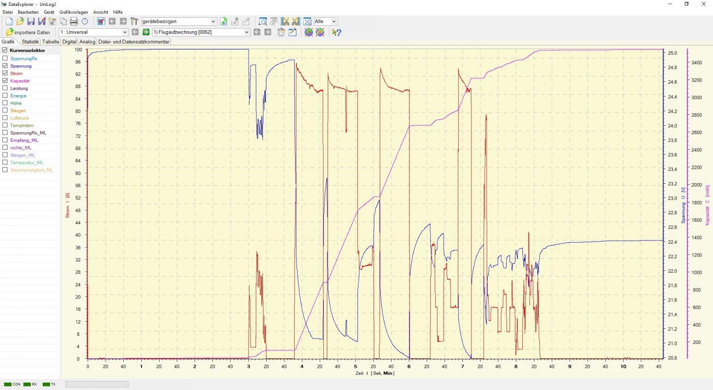

          Congrats on maiden!
          Also good landing and... 6 min 10 seconds flight, not bad! :)
          What were the battery cells voltage after the flight?

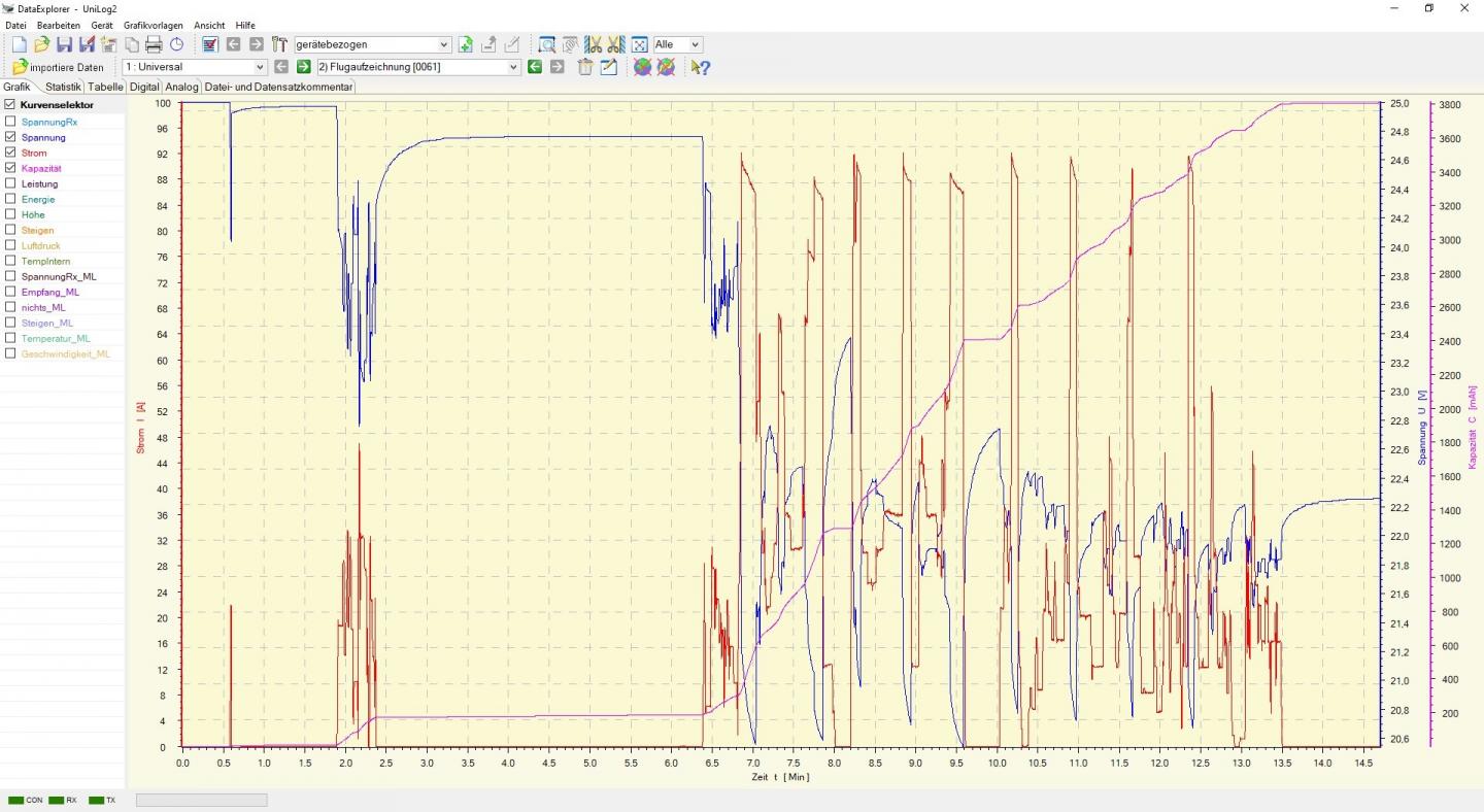

          Thanks, here are excerpts from the telemetry of the two flights. Note that I did a brief taxi run before the maiden with the same battery. RoaringTop 6s 5000mAh 25C.
          Upon landing after the 6 min maiden, less than 3700 mAH were consumed, voltage according to cell checker was 3,73V.
          Spannung = Voltage
          Strom = Current
          Kapazität = Capacity
          Click image for larger version  Name:	Maiden Stock Fans incl V.jpg Views:	0 Size:	144.8 KB ID:	281341
          Click image for larger version  Name:	Second Flight_First High Speed Runs.jpg Views:	0 Size:	127.4 KB ID:	281342

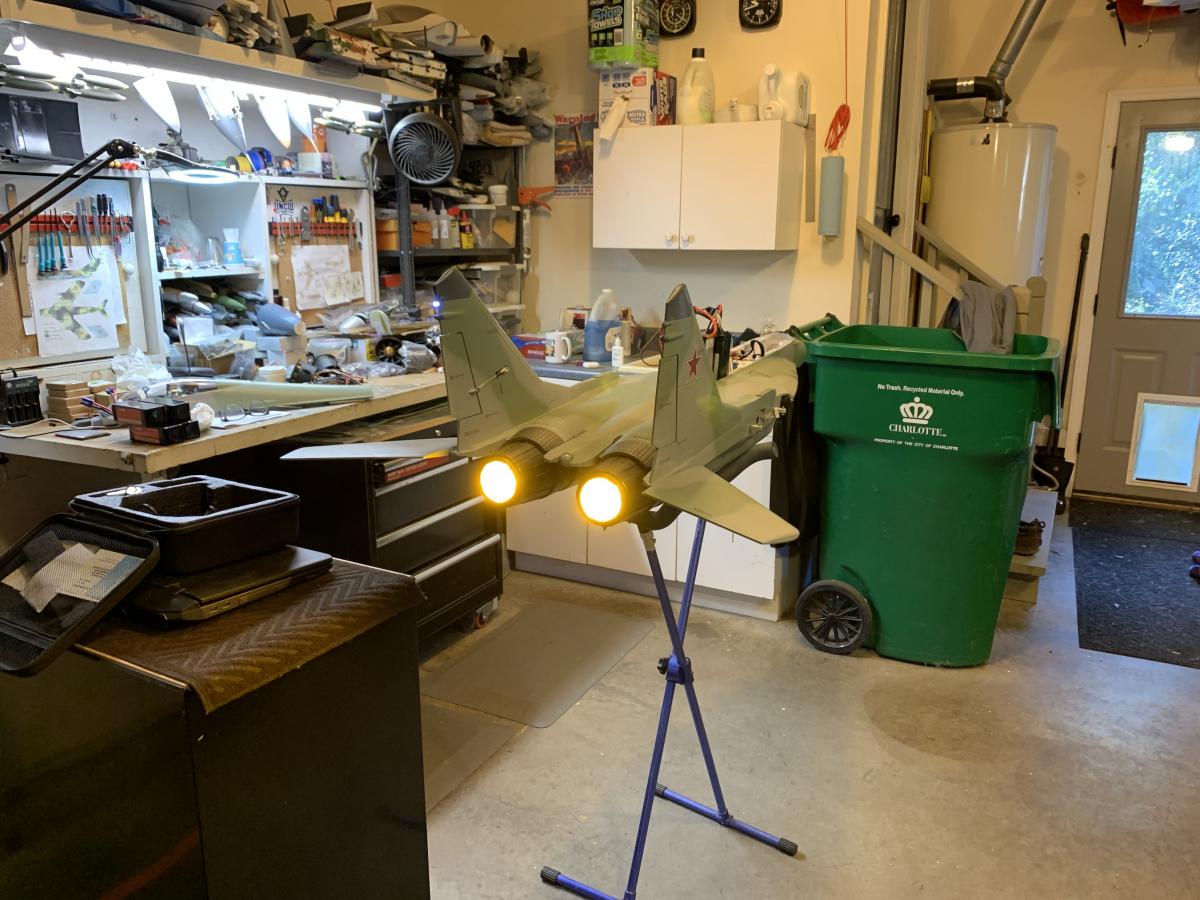

                          I'd like to recommend a new burner on the market. (At least it's new to me.) I believe I've tried them all except Kallend's do-it-yourself kit. This one is right up there in the running for half the price of some that are out there. I thought I'd give this setup a try from RC-Castle. $50 for the complete setup and very nicely designed. Very bright as well. Takes about 3 weeks to get to the US via Air Mail but I think it's worth the wait. The single engine setups are even cheaper. It even has the slight flicker before going to continuous illumination simulating the ignition of the afterburner.

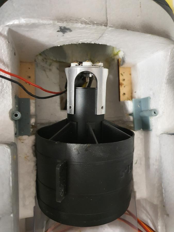

                          Is that the CYCLONE POWER 36MM CENTERBURNER LIGHTING SYSTEM FOR FREEWING MIG-29 TWIN 80MM EDF JET?
                          How does it attach to the motor can?

                              The inrunner LEDs just slide over the end of the can (pic attached is an FMS). They come with grub screws to secure them but they have a decent enough interference fit that it's really not needed.
