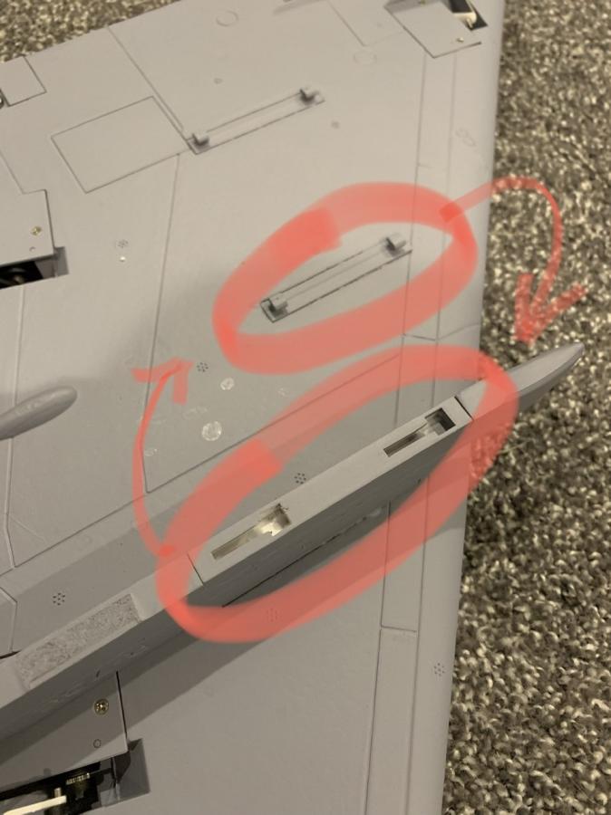

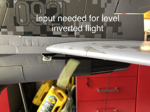

      Great job with the MiG MRC! I flew it twice today with the stock elevator servos with no issue. I’ll push it harder once the servo upgrades arrive. I really appreciate the call from Alpha and the email. The new main wing screw anti-drop design is excellent. On future aircraft would it be feasible to swap the pylon tabs on the wing with the slots on the pylons? I prefer flying without ordnance and just cover the slots with Scotch tape to reduce drag. All those tabs do is slow me down.

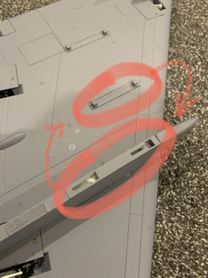

        Click image for larger version  Name:	A4C5E5C7-3F89-4128-A7C2-A8DBE328B415.jpeg Views:	0 Size:	59.9 KB ID:	275190
        The actual impact of these tiny tabs are next to nothing. It provides exactly zero practical difference in flight time.
        Swapping genders is problematic since it would break compatibility with all previous attachments people would like to reuse

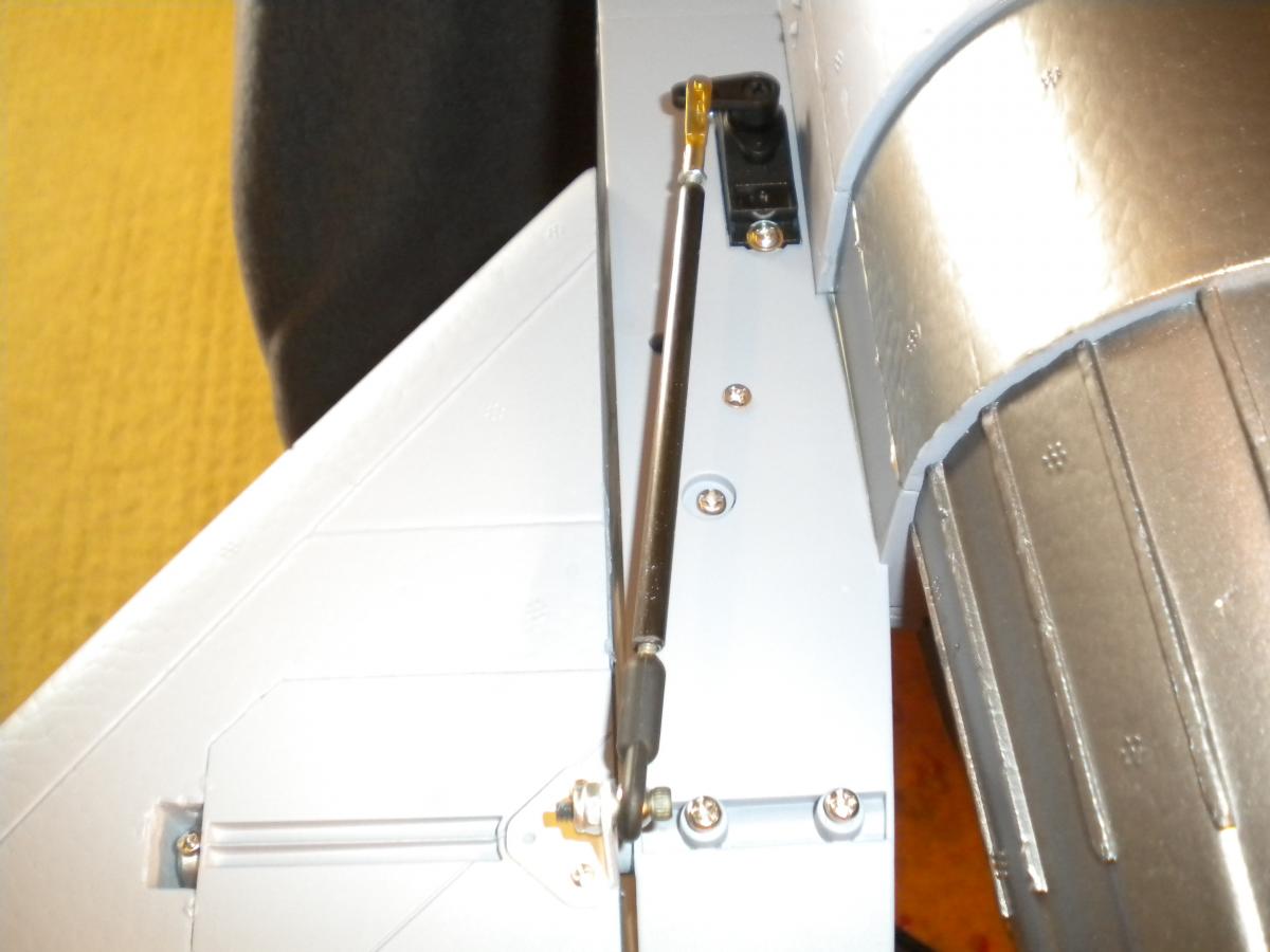

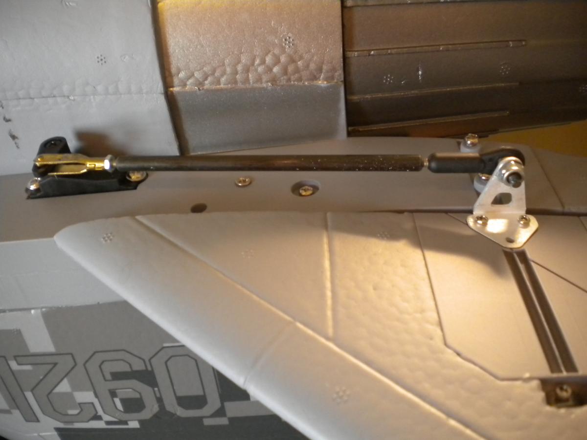

                I haven't seen a RTF weight so I thought I would post mine: 12.8 lbs with RT 5500 45C/ 2 coats of Minwax (no ordinance). Really light for the size.
                I didn't like the elevator linkage so I changed it.
                4-40 all thread
                carbon sleeve
                Sullivan clevises
                Dubro ball links
                Click image for larger version  Name:	DSCN3371.JPG Views:	0 Size:	74.7 KB ID:	275235

                  #1188
                  I still don't like the angle of the linkage, but I will stick with the recommended middle hole.

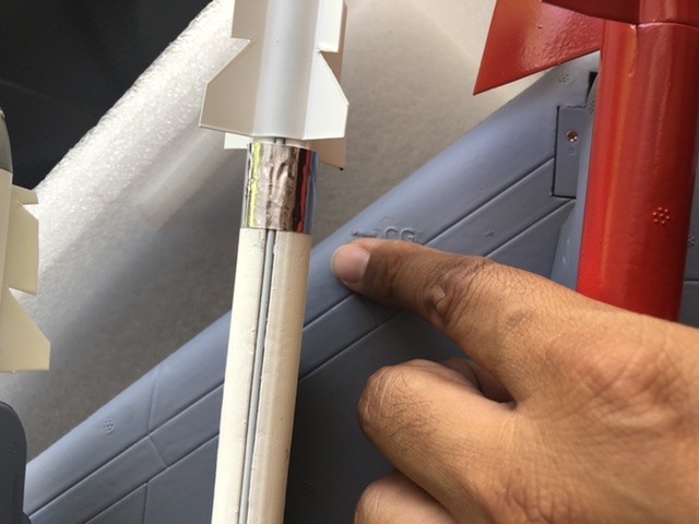

                                        Today was maiden day for my MiG, video coming soon, did 3 flights in less than perfect conditions, cross wind @ 15mph.
                                        First thing to mention is the CG, I decided to go further back than recommended, about one finger width back from the marks. Checked the CG in the air with gear up and down, inverted flight required a fair amount of down elevator.
                                        Also did a stall test, full up elevator until almost zero forward speed, finally the nose just drop straight down, kept the elevator at full up and added some throttle and it kept flying. Loops can be tight, it almost loop at length of the fuselage.
                                        The MiG is set up with tailerons and ailerons and slow rolls looked great. Landing were a bit tough because of the cross wind but the MiG handled it like a champ.
                                        For the next flights I will be moving the CG further back.

                                          #1200
                                          wow, one finger back? I may have to experiment with some CG play
