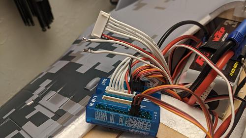

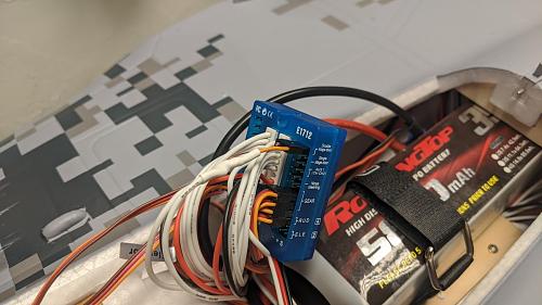

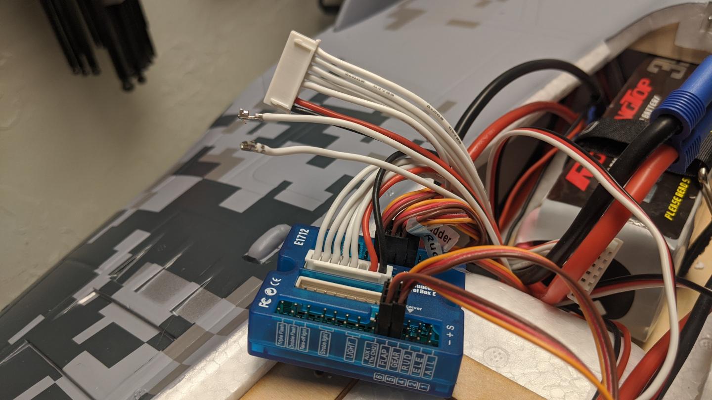

                        A follow up on an earlier post for two stage doors. Here are the pins to move from the wing wiring harness connectors at the blue box. Remove the 3rd wire (next to the red wire) and solder those together and install a connector to connect directly to the blue box two stage door output. Works great and as others pointed out, is not scale but looks cleaner and is cool!! I don't remember who posted the first note about the blue box having two stage door output but credit to them.
ID:	276167Click image for larger version
                              When you splice the two wires together and install that into a plug, there's only one pin that's used?

                                  Yes, just the signal wire.
                                      Perfect. Thanks.

                                        #1399

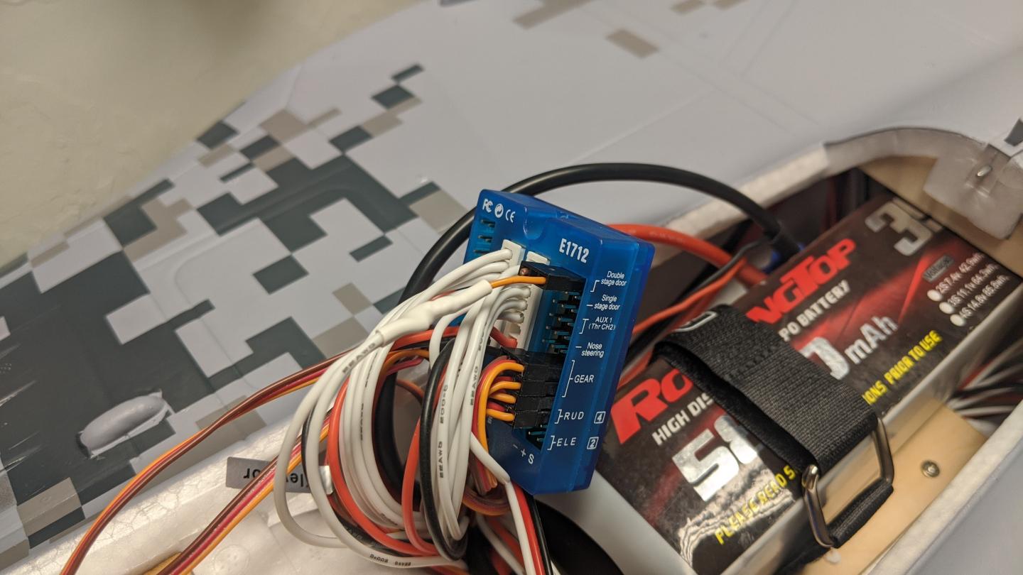

                                        I checked the connector at the wing and it is the 6th wire. Starting with wire #1 being the black wire. I don't want to dig the blue box out of my fuse now that I have it buried and the wiring all secured. So, I can no longer get to the other end of the wing wiring connector but I think these are straight through cables so you would just remove wire #6 on both blue box wing connectors and tie them together or add a connector to each one if you want redundant channels to control your ailerons. The connectors will only contain the signal wire because the ground and power will still come from the blue box. You would plug these straight into your gyro or receiver. To be sure about the cable, take one #6 wire out of the blue box connector and make sure that wing no longer has aileron control before you doing any cutting to your wiring.....
                                        Originally posted by TS8103
                                        I want to partially bypass the blue box for the ailerons. Does anyone have a schematic or diagram on the balance leads. I would like to find out which wire in the balance lead is the signal wire for the ailerons. Any help would be greatly appreciated.
                                        thanks,
                                        Tone
