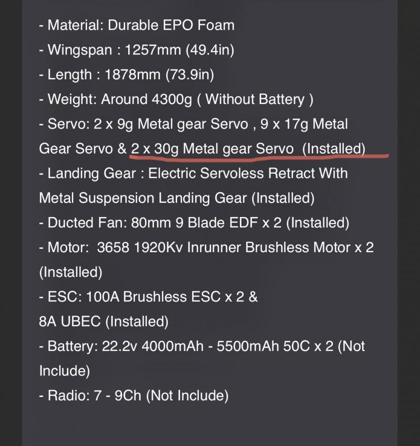

I'm planning on something special for this MiG-29.
Even if it doesn't achieve 1:1 T/W I want to use it as a testbed to see if I can get its hover/high-apha performance to be much better than on my other models by means of using high refresh-rate servos, being run by gyros.
That is, I've already placed an order for several 333Hz capable 20g lil' beasts and sooner or later these should end up powering my stabs and nozzles.
The thing is... I've seen some reviews and each servo easily spikes at 2A current draw when running them at their highest specs... of course, stock setup will not tolerate this so I already ordered an 20A UBEC, and will have to do some serious testing before daring to put such a setup in the air... if the power is too much and causes an Rx brownout, that will be on me.
So, anyone having experience with any similar 'bigger-bird' setups, I am all ears to hear about your reccomendations and tips.
I guess after running some ground tests I'll come to the conclusion that I have to settle at something like 100Hz instead of 333Hz.
Anyway, I'll be glad to take feedback!
I have some previous experience in the field because I've flown flybarless helos, but those are 4 servos, and this jet will be running... 15 (4 to 6 of them running at high rates). 17 if I add FPV pan and tilt. That's crazy.

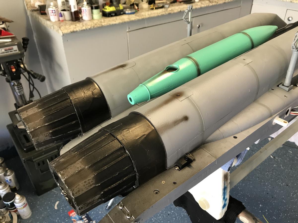

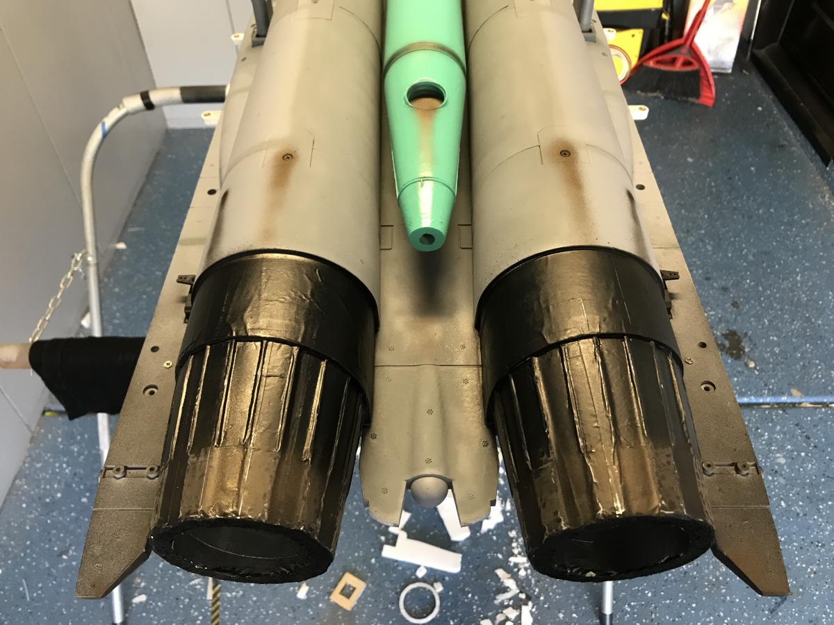

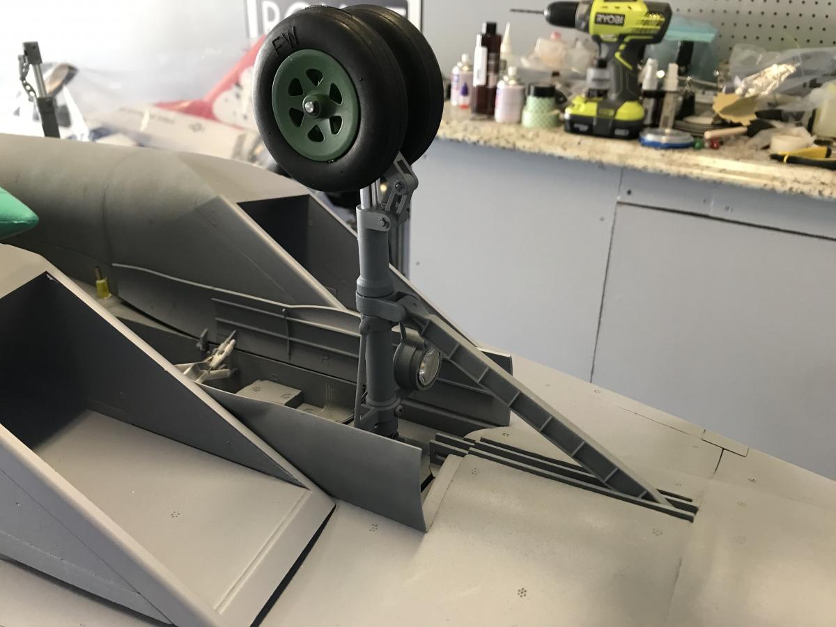

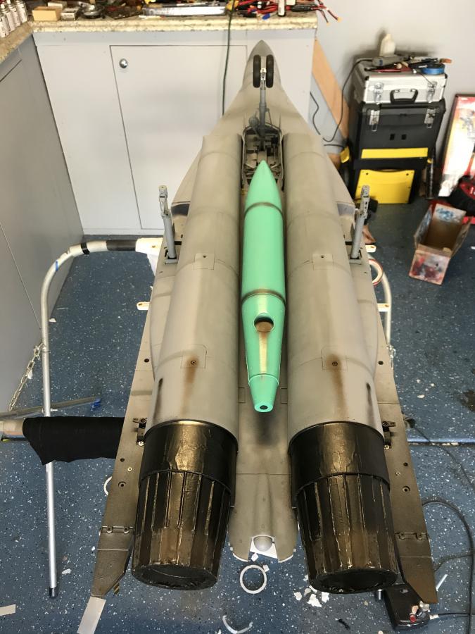

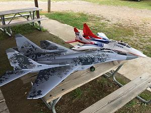

I got my elevator replacement servos in yesterday. It's a quick install and fits just fine. They are a little bit taller but no issues with fitment. I'm currently doing a twin turbine conversion with Xicoy X-45 10 lbs engines. Already plumed the fuel lines and tanks. Did some nice weathering on the jet and made a centerline external fuel tank as well. Still waiting on the wheels and brakes, receiver and batteries to come in. I'll keep you guys posted if you're interested on the conversion build.

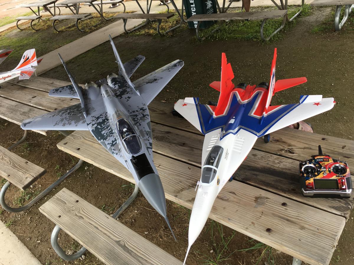

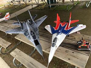

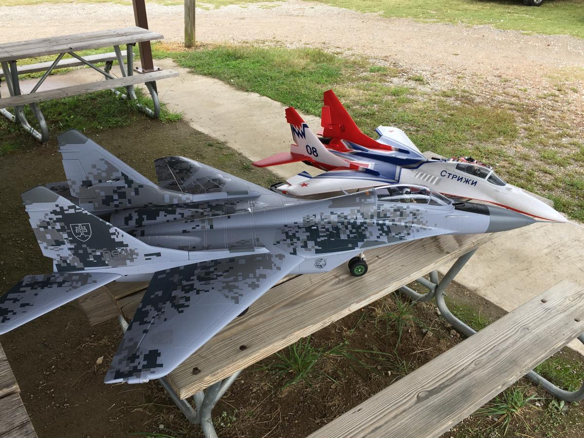

So much fun flying this Mig with Brent, Justin and Justin (and maybe one more tomorrow).
I keep pushing my CG back. Before when I was one finger width behind the CG, the nose seemed to want to tuck when making a flyby. Now with the CG moved a little further back, the tucking has stopped. I will measure and report my current CG tomorrow.
Brent did a new thing with his today. Inverted high alpha into about a 10 mph headwind. He could peg it in one spot and it would just sit there. Tried it on my next flight and it was easy as pie. Brent is also doing a loop to landing. You can tell he's really comfortable with it and is really pushing it to the max on every flight. Today he was trying to burn through some charged packs. Over a 45-minute period of fly, land, change packs and fly again, he made about 7 flights. Most of these were pushing the airframe further and further to it's limits. Even after 45 minutes of constant use, the electronics held up just fine.
Between the 4 of us, we have about 75 flights so far over the past 3 days. We are going to get a group pic tomorrow. Other pics and video coming soon (wi-fi too slow at the hotel to do uploads).PatComment

Freewing A-10 turbine conversion: http://fb.me/FreewingA10TurbineConversionComment
Looks great this far! I'm planning on twin X45 down the road too, but will be flying electric for the first season or so.I got my elevator replacement servos in yesterday. It's a quick install and fits just fine. They are a little bit taller but no issues with fitment. I'm currently doing a twin turbine conversion with Xicoy X-45 10 lbs engines. Already plumed the fuel lines and tanks. Did some nice weathering on the jet and made a centerline external fuel tank as well. Still waiting on the wheels and brakes, receiver and batteries to come in. I'll keep you guys posted if you're interested on the conversion build.

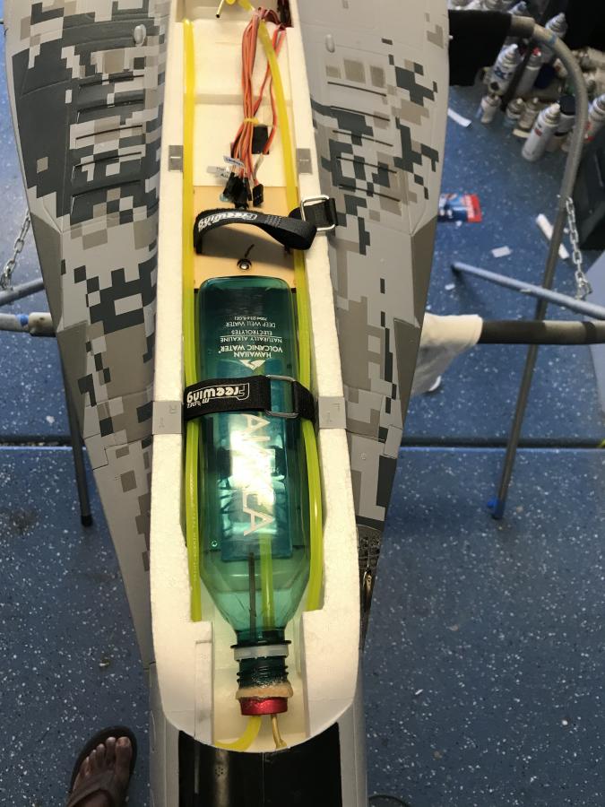

I would be worried about cg shift though. That forward tank is soooo far forward of the cg... Not having the jet yet, I obviously lack enough hands on study to know for sure, but hoping to cram in more/smaller tanks in the aft battery bay, the areas to the side of it, and directly behind it as far as the spar allows. Looking at cross sections from the 3D model, chaining some smaller tanks should make it possible to get 1.5 liters or so in there - far closer to cg.
Awesome! I like seeing all the crazy stuff people do with models. I think you are right that the new servos are a tiny bit taller, I hadn't noticed that. The bottom up to the mounting holes is the same, but the top is 1 or 2 mm higher. It doesn't matter in the elevator position, but it might not work as a drop-in replacement for other models or other positions, especially a servo that lays down on its side in a bay.I got my elevator replacement servos in yesterday. It's a quick install and fits just fine. They are a little bit taller but no issues with fitment. I'm currently doing a twin turbine conversion with Xicoy X-45 10 lbs engines. Already plumed the fuel lines and tanks. Did some nice weathering on the jet and made a centerline external fuel tank as well. Still waiting on the wheels and brakes, receiver and batteries to come in. I'll keep you guys posted if you're interested on the conversion build.
By the way, this seems like a very well-made model in general. Speaking of the servos, notice that the rudder, flaps and ailerons here are in closed bays with lids that screw on. That is more secure, and also makes it easier to change out a servo. Also it looks better, since you don't have a bunch of big black rectangles everywhere. Most foam RTF planes have servos glued into an open bay flush with the surface - cheap and quick but less robust. And that is just one of many details that are improved on this plane, versus past Freewing models (which were already the best RTF foam EDFs in the market).

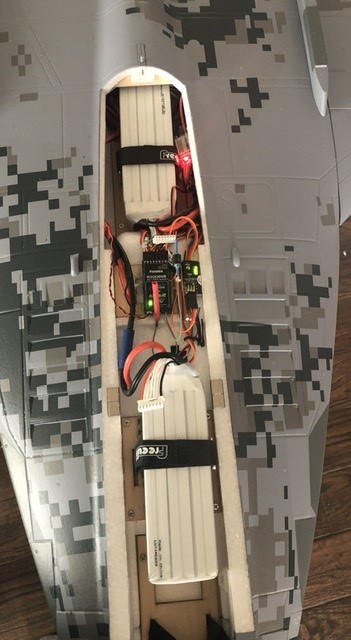

I'm slowly getting a handle of my wiring. If you undo the twist tie by the blue box, you can get some extra slack on the ubec wiring and relocate it to the front bay. I am also needed to use the middle and back trays, and even then my index finger is right behind the CG mark (~10mm). Though it sounds like a lot of folks reporting it flies well with a slightly farther aft CG and less stab downtrim is needed.Argh. Struggling a bit with battery and rx/wire placement. I have Spektrum 5000 and HRB 6000 batteries. With both of these setup, I need to use the rear and middle battery location to CG. The issue with this is that the wiring mess is hard to control and the UBEC seems like it's way too close to what will be a hot battery in the middle spot. I guess I will place my rx in the front battery bay, but I'd like to see some pics of your setups (nothing crazy - just typical single rx with battery at rear and middle.
We have wind gusts as high as 30 mph today, but I am hoping for a maiden tomorrow morning.3 PhotosComment
i want to use exactly same batteries 5000 Admiral. Report a maiden pls, if its good this position of batteries with -10mm CG.Comment
I am doing a single x45, flying off grass I cannot afford the extra weight of the two turbines plus the lead up front on landing and hope to have reliable front retract life, I expect mine to land way lighter than the edf version... Yours wil be a show stopper with the twins and you prob know you will have a s**t ton of power lol.I got my elevator replacement servos in yesterday. It's a quick install and fits just fine. They are a little bit taller but no issues with fitment. I'm currently doing a twin turbine conversion with Xicoy X-45 10 lbs engines. Already plumed the fuel lines and tanks. Did some nice weathering on the jet and made a centerline external fuel tank as well. Still waiting on the wheels and brakes, receiver and batteries to come in. I'll keep you guys posted if you're interested on the conversion build.
As said the 1.5 litre tank in the front battery bay is going to cause a massive shift on CG on this, like having a 1200g battery upfront then ejecting it mid flight, there seem sto be a massive CG range on this plane but still I think that amount of CG shift would do my head in. I think I would be more creative in seeing where else I could put fuel, On another plane I have I have two tanks, one behind wingspar/CG and one infront, the rear emptying first into the front, not ideal but reduces CG shift over having just one bigger tank infront.
If you could make that belly tank functional that would be ideal.Comment
Sure, these are the ones I have at home or are on their way that I was considering for the task:
300Hz capable: KST-215MG, ALZRC DS452MG, PDI-1151MG, PDI-1109MG,
Turnigy servos are high quality at the best price. The Turnigy DMC809 Coreless DS/MG/BB Micro Servo provides great strength and precision at a micro size.
https://www.banggood.com/es/3PCS-KST...r_warehouse=CN
https://www.banggood.com/es/ALZRC-De...r_warehouse=CN
https://www.banggood.com/es/JX-PDI-1...r_warehouse=CN
Normal 50Hz digital servos: Turnigy DMC809, Votik 9495 MG-D
