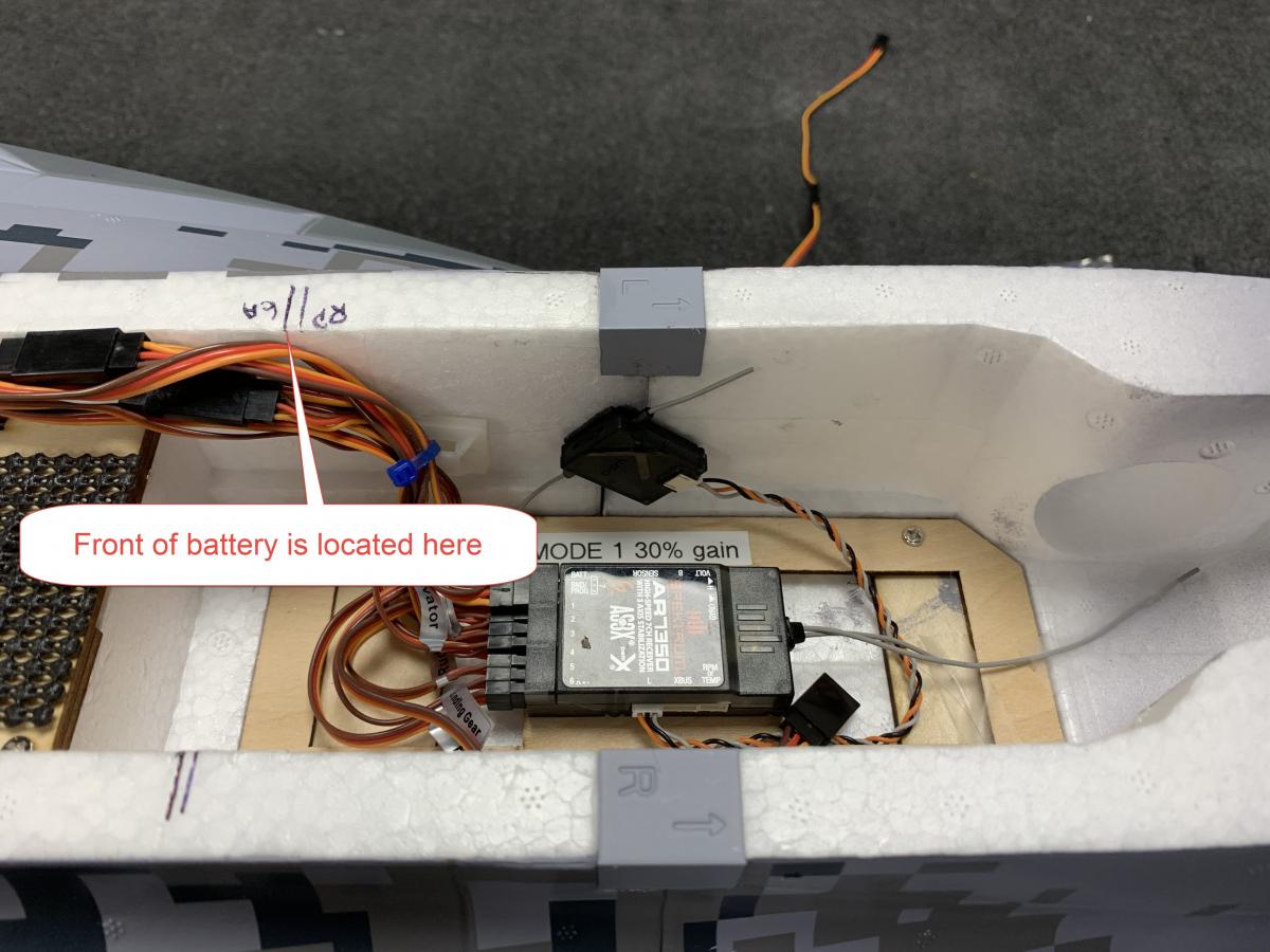

    • Originally posted by Dan B View Post
      Hey Guys,
      Lots of good feedback on my crash, just wanted to post another pic that shows the pre-crash location of my electronics and RX (AR620). I never had an electronic glitch before in all my years of flying, but looking at this setup now there is a LOT of spaghetti there with potential to be crash worthy. With the RX behind the battery it would be shadowed when the plane was flying towards me. Come to think of it, every MiG crash video I've seen is when the plane is flying towards the pilot. Hmm...
      I had battery left after the crash (3.83v), but; Loss of RF signal due to proximity of battery? Electronic interference that could be resolved by additional RF chokes? Brownout? RX with additional satellites? Bypass blue box? Lots to ponder on my next build!
      Good point indeed.
      How many satellites did your rx have when you crashed?
      The rx position wouldn't be a concern in itself, but satellites are mandatory for all spektrum full range models imo - at least two in different axes.

            • Could be language differences but "cannot" and "mandatory" are not appropriate when stating opinion. And not so "obvious" though it could be a possibility.
              • I think the key in Dan's case was the RX was situated between the two batteries, and also surrounded by a bunch of wiring, which most likely caused a loss of signal when the plane was head on and maybe a little nose high. In this case I would have installed the RX in the forward battery tray (actually, that's exactly what I did on mine) with the antenna as far away from any wiring as possible.
                • With these big batteries and a ton of wiring, I always use satellites in all of my jets. Yes, the AR620 is a full range Receiver and supposedly better than even the "wired" receivers Spektrum has put out. Their quote. However, there is no capability to use satellites with this receiver and therein lies the problem... imo.
                  Fly low, fly fast, turn left
                    Placement is important, and I agree the forward tray would be a better location. That being said, looking at his location I wouldn’t be so sure to say that was the problem. I’ve seen some AR620’s recently in jets in far worse set ups with no issues. Again not the best practice, yet somehow they get away with it.

                            • One more point of reference, this is the set up in my Avanti. AR620 is about the same proximity from battery as my MiG. IF I conclude that the battery was a direct interference of the RF signal on the MiG and therefore lost the signal when it was flying towards me, then should I also expect my Avanti battery to block the signal when it is flying away from me and crash? I have over 85 flights on the Avanti (I mark my batteries each flight) with no issues. Maybe I just got away with it in the Avanti, but this is the reason I wasn't concerned using the same AR620 in the MiG. Yes it's also obvious the MiG has a $hitload of additional wires, and looking at the Avanti I also bypassed the control board. Many, many variables. Looking back now, of course I would do several things differently, but I'm still not ready to say 100% what the cause was. Appreciate everybody's opinions. Not trying to get into any debates, just sharing information so everybody can interpret it in a way that helps them.
                              Several valid points have been discussed, thanks to all.

                                  Dan, again, sorry for your loss. My best advise would simply be that good rx setup is a must on spektrum (and any other radio system really). A single rx with builtin antennas may seem like a tempting choice, extremely easy to install etc, but it is very vulnerable since you have no dispersion of your antenna locations and thus very easily end up in the shadow of bulky batteries or other shielding materials such as CF. Arguably not the most common problem in foamies, but still something to keep in mind.
                                  I don't fly spektrum on full range without at least 2 well placed satellites working different axes, preferably 3.
                                  • Well, having used an internal-antena receiver pretty much settles the issue.
                                    Can't 100% blame it on the receiver with absolute confidence but it is probably safe to say that this was most likely the culprit here.
                                    For a jet this size, I think (personal opinion) using redundant receivers (Something like the RX8Rs or using satellites at the very least) should be a must.
