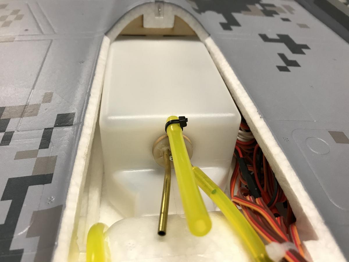

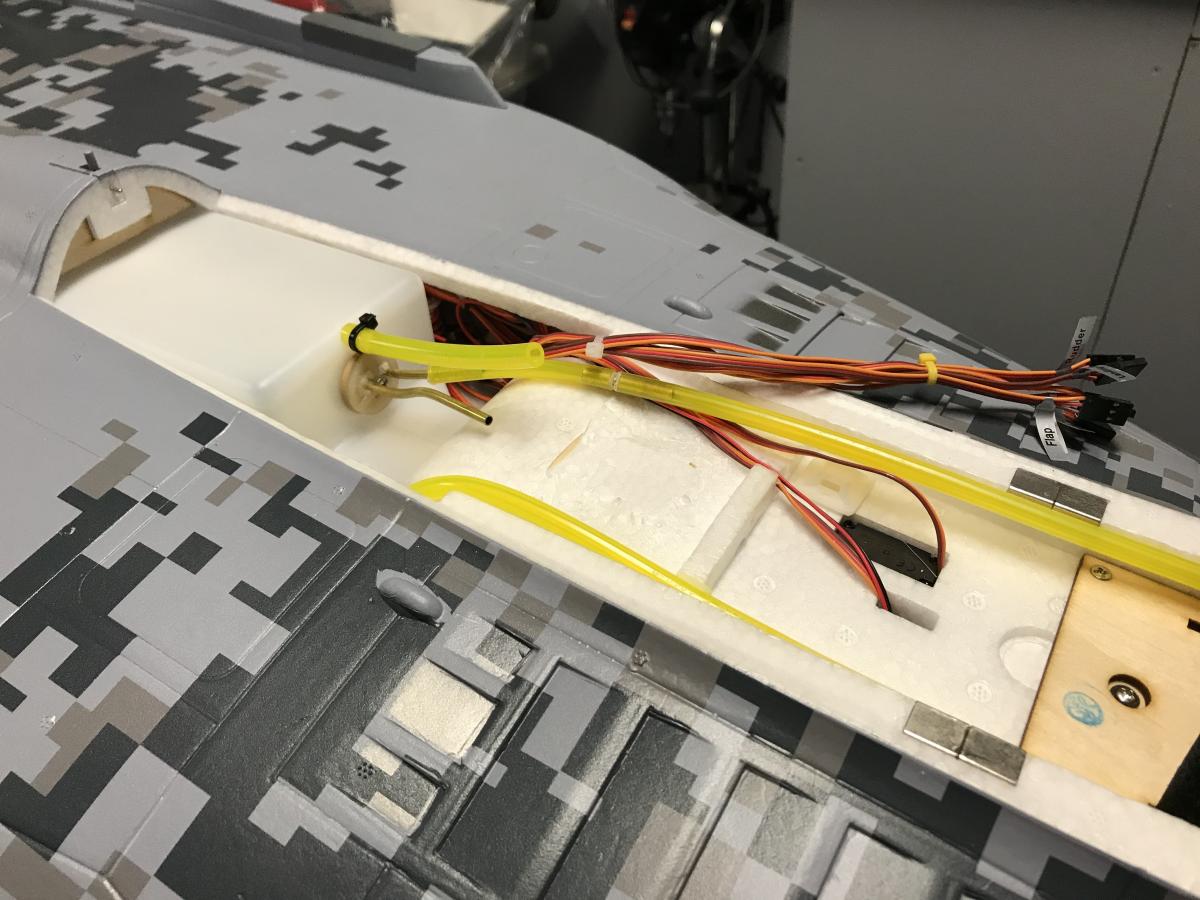

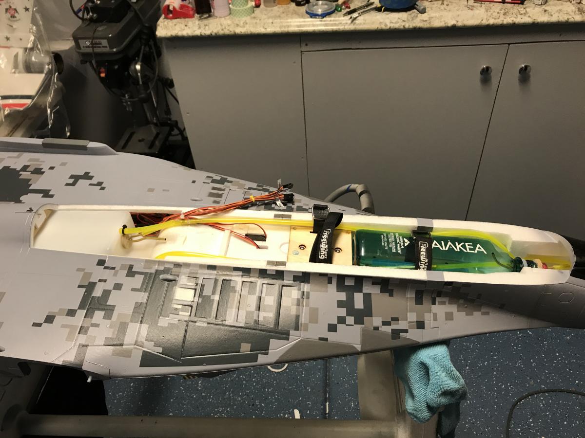

    I'm currently doing a twin turbine conversion with Xicoy X-45 10 lbs engines.
    janmb, they beat you to it, lol!
    Originally posted by Scale Master View Post
    Already plumed the fuel lines and tanks.
    Isn't that fwd fuel tank a bit too far from CG?

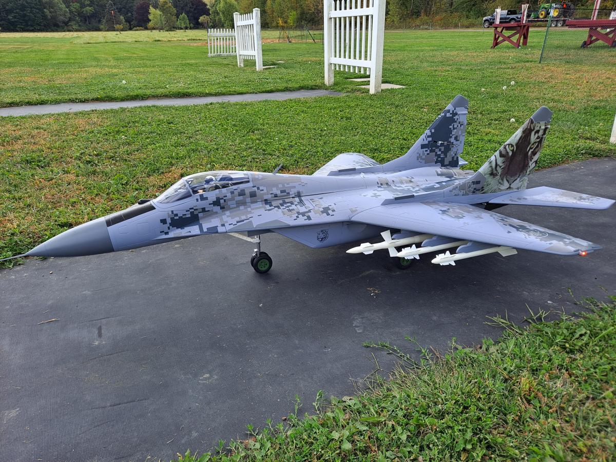

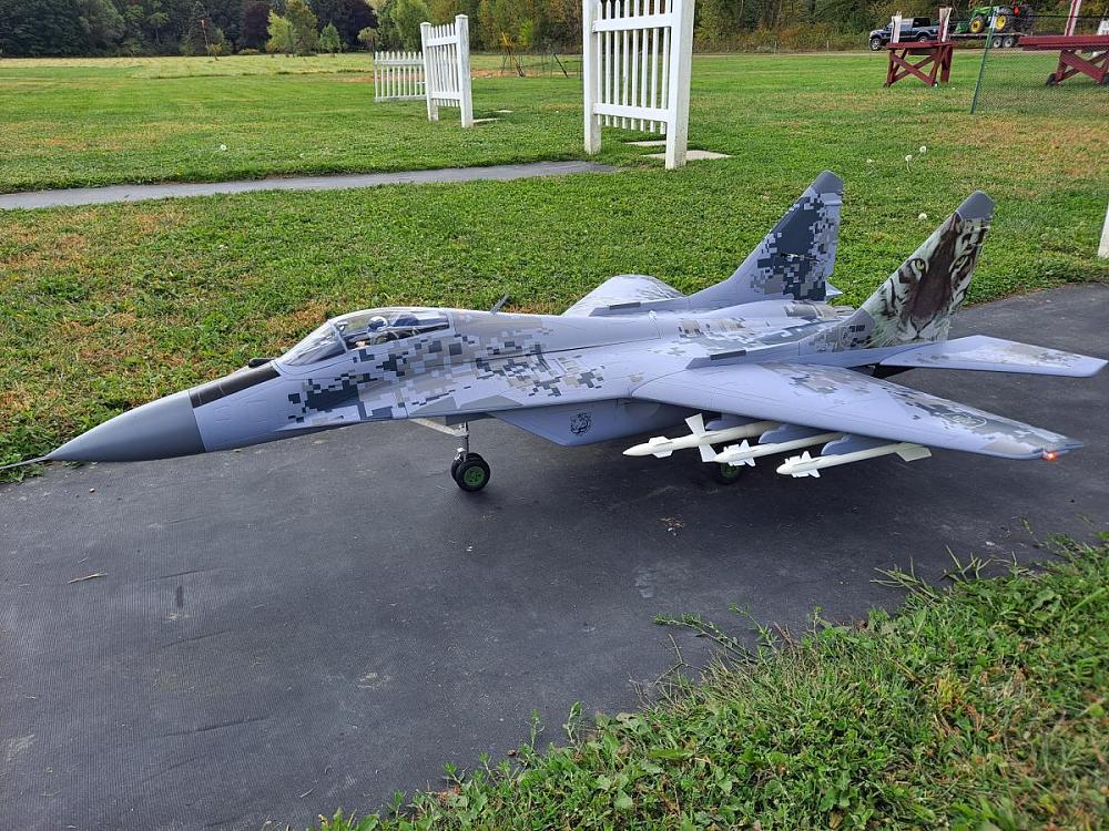

      • hey, I got my maiden flights in today, everything went great. I'm using RT6250s and had about 35% left after 3:40 on the timer. Balanced just a bit behind the CG and I needed only a few clicks of up trim. I'm sure the CG can be moved back farther a bit. I love the way this plane lands, Its really easy to hold the nose up and its a floater.
        It gave the impression of being slow, but I think its because its such a big jet. Looking forward to many more flights!
        Time to share "first time out" pictures. Its a BIG baby!
        Click image for larger version  Name:	20200926_132950.jpg Views:	0 Size:	174.8 KB ID:	276844
        Click image for larger version  Name:	20200926_124623.jpg Views:	0 Size:	268.3 KB ID:	276845

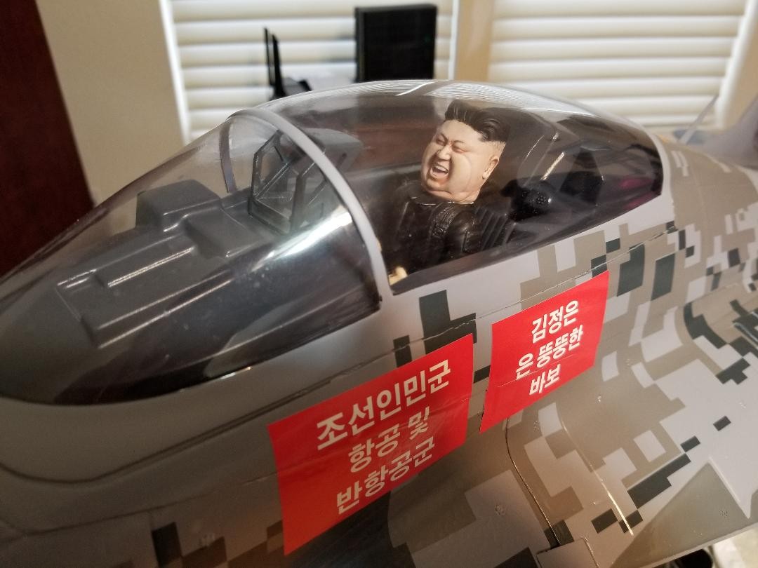

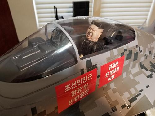

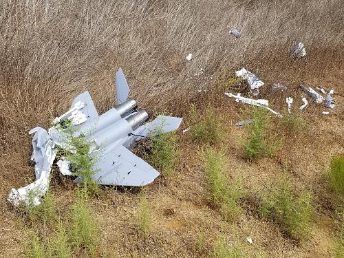

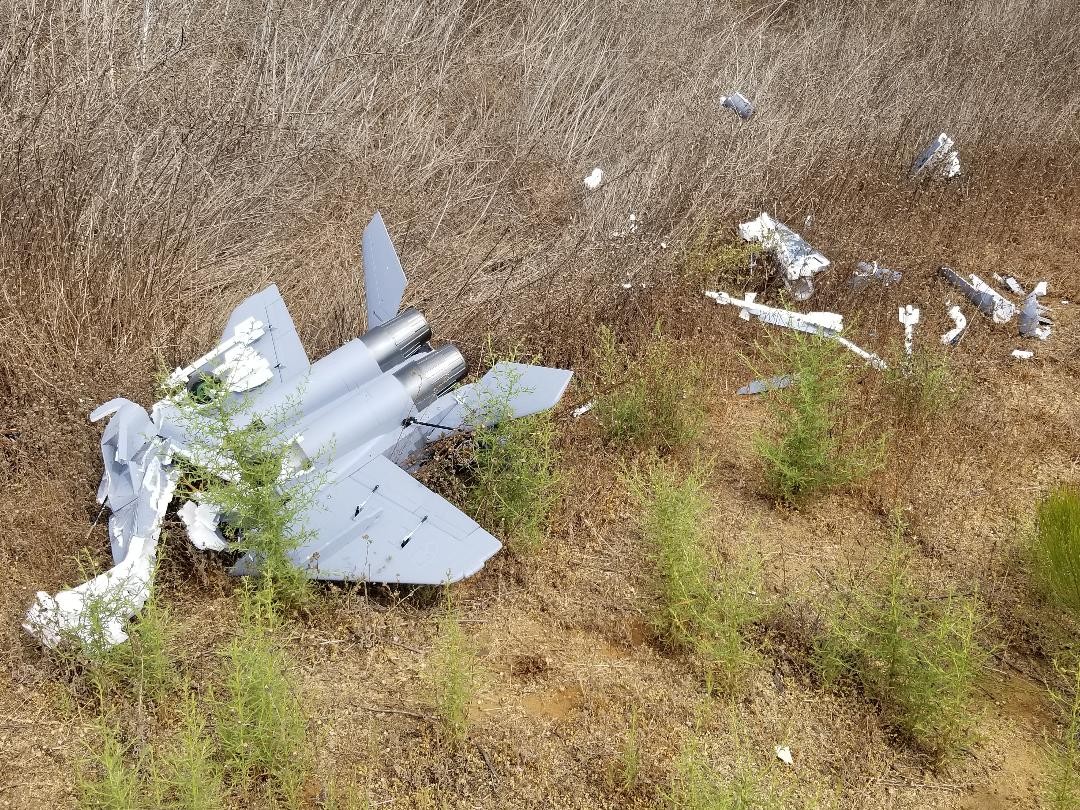

          • Sadly, the Dear Leader did not survive. Reversed ailerons. I am not quite sure what happened, but most likely I made an error when first setting up the radio (maybe I was looking at it upside down and backwards and didn't do the rotation correctly in my head), and then just failed to notice it later, having in the back of my mind "I already did that."
            I could have sworn before this incident that I never fly without checking all control surface directions before every takeoff, but the picture says otherwise. So, I guess was in a hurry and didn't do it this particular time. Anyway, I shouldn't bother to tell y'all to "always check right before flying" because everybody knows that. But..... always check right before flying.
            Worst of all, the Dear Leader's head was not found.

            • Soooo sorry Gringotuerto - But many of us have done this in the past for one reason or another. It's part of the RC plane hobby.
              In my case, it was an F-4U Corsair, and I was surrounded by a crowd of kids....talking to them instead of concentrating on what I was doing.
              Still hurts. I feel your pain.
              -GG
              • Been there done that ! Now I say to myself that even if the wiggly bits wiggle is it in the correct direction ?
                Sorry and sad to see this happen to such a nice scale model -- never seems to happen on the beat up foamie trainer does it !.
                Move on my friend ---------
                • My heart just sank. So sorry.
                  • Ouch. :'(
                    • Bummer
                      • Oof, sorry to see mate. This hobby can be cruel.
                        • Originally posted by GliderGuy View Post
                          Thanks for the kind words everybody, but I'm fine. In fact, I just ordered another one and another set of batteries. And it turns out the Kim Jong Un who perished was only a body double! The REAL Kim Jong Un is rising out of the resin tank on my printer right now. Dear Leader is not so easily defeated, he will fly again!
                          • Maiden and two additional flights in the bag. She is a sweetheart to fly...sorry for your mishap Gringotuerto. I hate to hear that.

                              Click image for larger version  Name:	IMG_8978.jpg Views:	0 Size:	124.3 KB ID:	276981Click image for larger version  Name:	IMG_8979.jpg Views:	0 Size:	80.1 KB ID:	276982Click image for larger version  Name:	IMG_8980.jpg Views:	0 Size:	125.2 KB ID:	276983

                                Yeah roger that, and I've already taken that in consideration. Unfortunately the way the model is made the rear tank are can barely fit a 21oz tank and the center area option can only fit a smaller 12-14oz tank max and still have the ability to close the top canopy hatch. When flying with 2 X-45's you need at least a total of 48oz if you want to get 3-3.5 min of useful flight time. The fuel burn will be a lot lower as flying at half throttle will lengthen the total flight time by 40% or so. CG isn't an issue as the forward tank burns off first and and the rear last, so when it comes time for lading she will land slower and lighter than the EDF version. I'm using NO UAT, just s felt tip clink in the rear tank, and a regular clunk in the forward tank.

                                    Yeah roger that, and I've already taken that in consideration. Unfortunately the way the model is made the rear tank are can barely fit a 21oz tank and the center area option can only fit a smaller 12-14oz tank max and still have the ability to close the top canopy hatch. When flying with 2 X-45's you need at least a total of 48oz if you want to get 3-3.5 min of useful flight time. I have a total of 45oz. The fuel burn will be a lot lower as flying at half throttle will lengthen the total flight time by 40% or so. CG isn't an issue as the forward tank burns off first and and the rear last, so when it comes time for lading she will land slower and lighter than the EDF version. I'm using NO UAT, just s felt tip clink in the rear tank, and a regular clunk in the forward tank.
                                    Yeah definitely see the challenge.
                                    I think you overestimate fuel consumption though. Unless you plan on hovering for the entire flight, a twin X45 setup will mostly fly between 10-40% throttle, in which case the fuel per minute is far lower
                                    My twin P20 in my A-10 of similar weight gave me 5+ minutes from just 32oz total...
                                    Normally I would say no uat being a bad idea, but having seen how ridiculous amounts of air this turbine can suck up without flaming out, I'm tempted to go without as well
