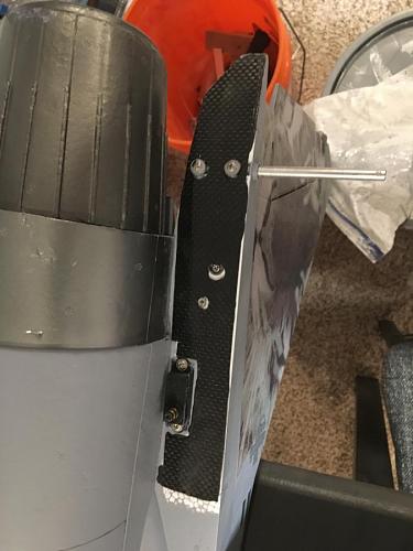

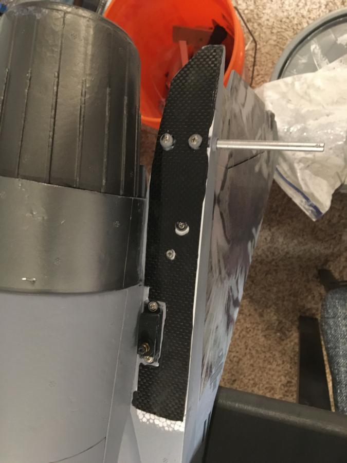

                        Hi Henrik - Some expressed concern about the plastic support box for the FFSs potentially separating from the foam after many, many flights. I added some 0.5 mm carbon planking to the bottom to address this. Also adds a bit of stiffening to this area.
                        Be sure to extend the front edge of the carbon enough to cover the front glue joint between the plastic box and foam.

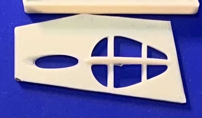

                                  Here's a file to print the "flare canister".
                                  https://cults3d.com/en/3d-model/vari...flare-canister
Name:	Flare Container.jpg
ID:	290763Click image for larger version

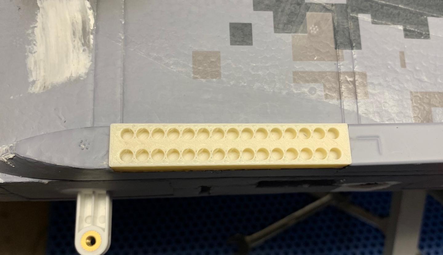

                                    #3537
                                    I know I'm being picky but the L and R on the stabs there really bug me.
                                    • t33jetman
                                      • 515
                                      #3538
