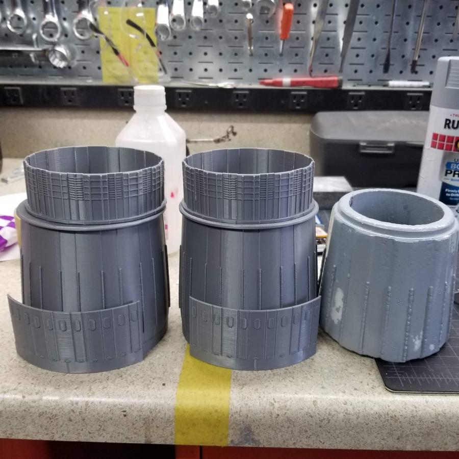

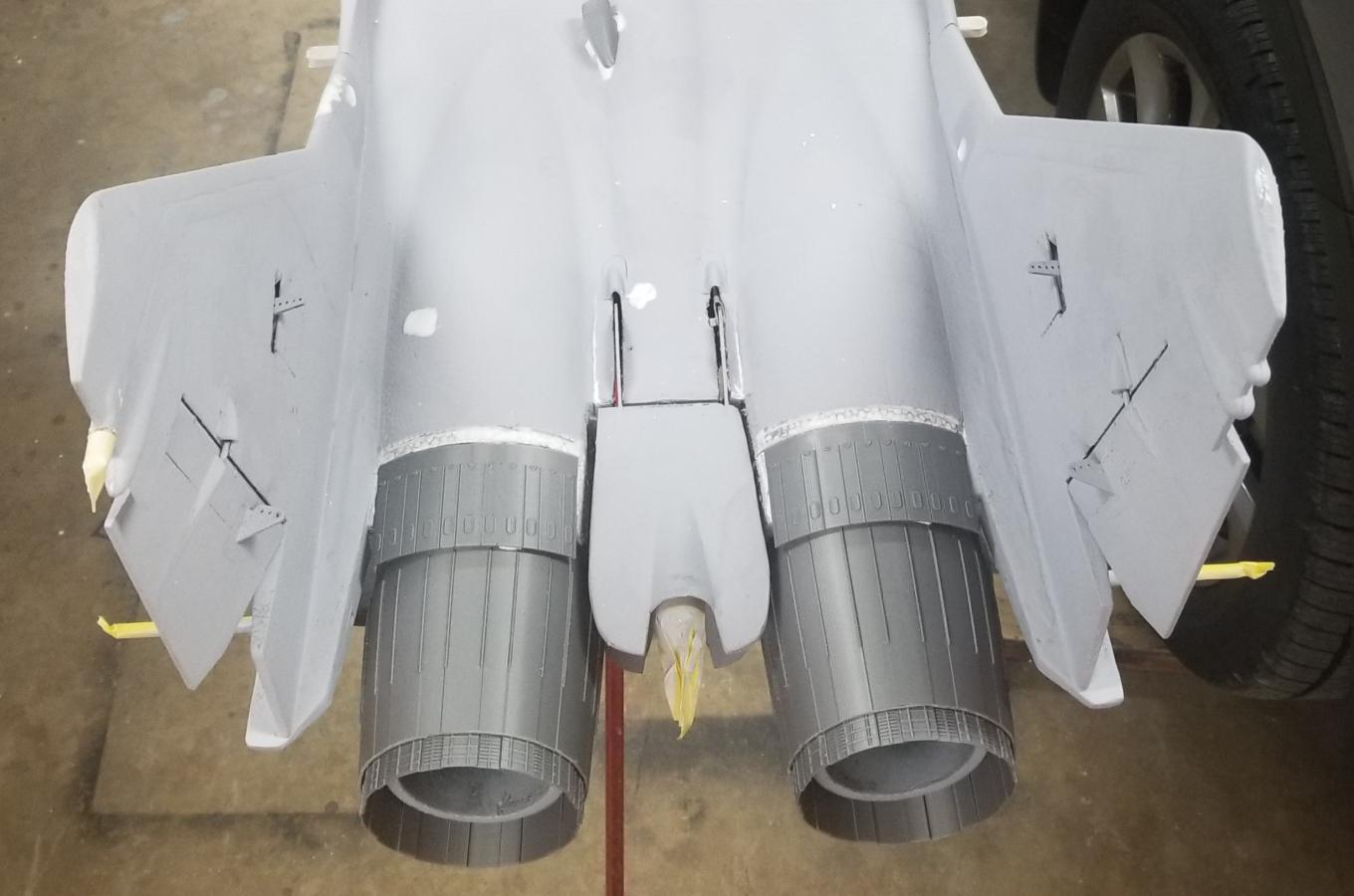

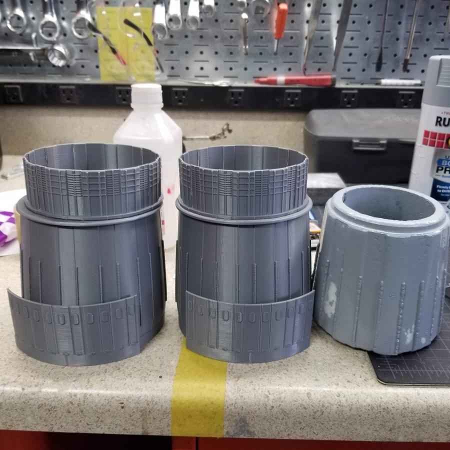

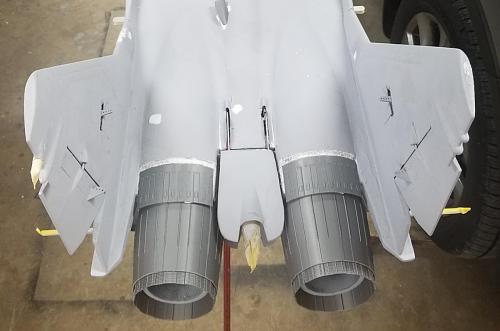

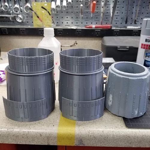

        3D Exhaust Nozzles by Frank Born , from Germany , can be found on Face Book , if interested
        Click image for larger version  Name:	20201211_154027.jpg Views:	0 Size:	91.2 KB ID:	290093 . Click image for larger version  Name:	received_830770101077959.jpeg Views:	0 Size:	102.7 KB ID:	290092
          Hey Jetman, yes Frank Born is on Facebook but there's nothing there about the 3D-printed nozzles, no information. Is he selling them, or is he offering the STL files? Are the STL files posted somewhere where they can be downloaded?
            The files are not anywhere, so I would contact him directly on face book .

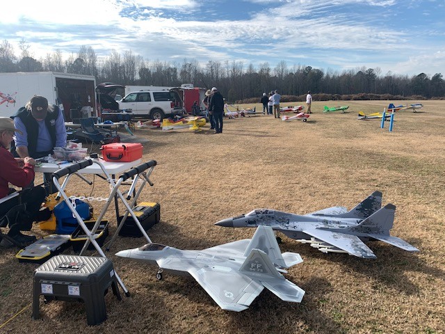

                With rain forecast all day tomorrow, I wanted to fly a bunch today. Winds settled down by 11AM. Beautiful sunny day 45 F to 50F. Almost calm after 11 AM. Flew until a bit after sunset.
                MiG = 16 flights (my favorite)
                F-4 = 8 flights
                P-38 = 9 flights
                I kept 3 four-station chargers and 16 batteries cycling continuously and my truck’s alternator cranking the amps out. Had a few folks from the highway stop and watch Whew! Time for a shower and something to eat. Fun times!
                -GG
                  Some patience, please. There’ll be either a moulded version available for purchase or I’ll make the files available, decision will be made in the next days.

                    It's a beautiful design Frank. Well done.
                      Frank Born
                      Thank you Frank, nice to see you are on the discussion group here. Your design looks great!
                                The files for the nozzle are available for a fee on cults 3d.
                                In addition, I've uploaded a file for the ventral air scoop that was omitted by the designers of the model. This one is for free.
                                https://cults3d.com/en/3d-model/vari...pgrade-nozzles
                                https://cults3d.com/en/3d-model/vari...tral-air-scoop

                                    Purchased the files this morning only the main body left looking good thank you for your designs.

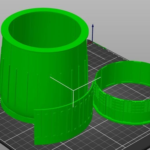

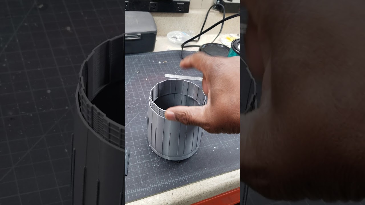

                                      STL files:
                                      https://cults3d.com/.../freewing-mig-29-upgrade-nozzles

                                          those are some good looking nozzles t33jetman. I hope Frank sells a ton of them. Excited to see your MiG's completion. Watching your progress updates have been awesome.
