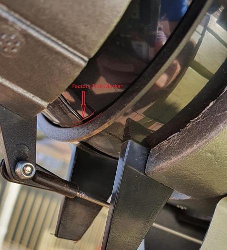

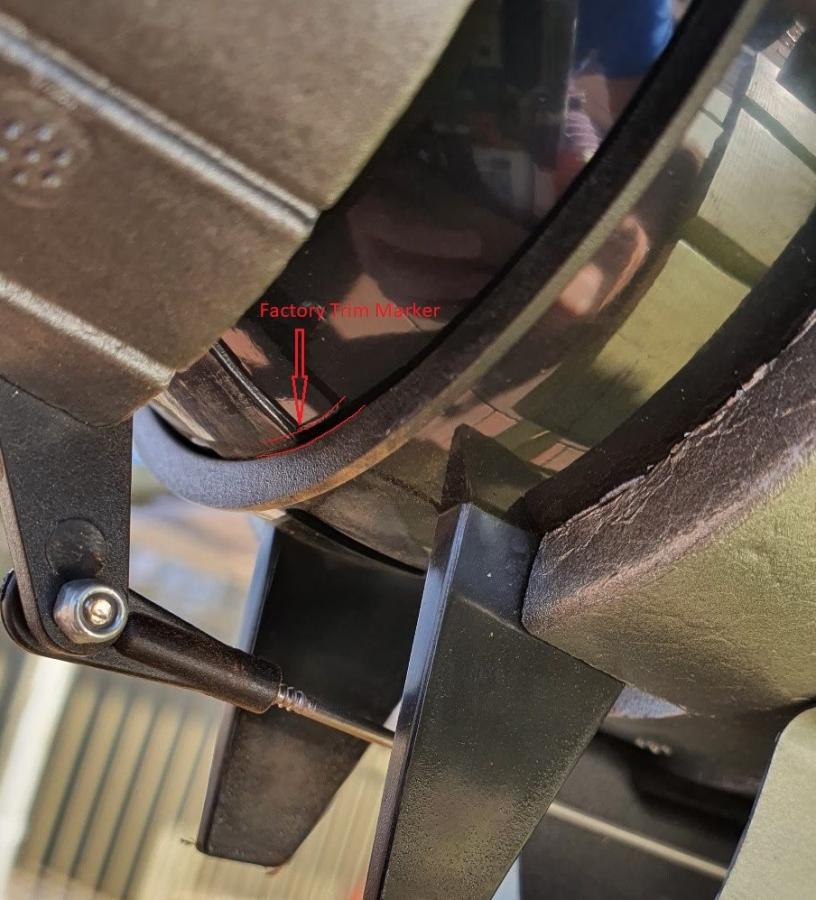

    The stock nozzles seem to have some pitch up built into the thrust angle, which makes you wonder just how much up trim it would need if they didnt.
    My strategy was to match the TV pitch trim with the elevator trim that was established with the stock nozzles (i.e. no notable change in pitch between throttle on/off). This required two trim clicks of up trim from the factory setting (using its own trim clicker and later zerod out mechanically).
    You can see here the centre trim marker molded into the nozzle, versus where I trimmed it to fly straight and level with my existing CG/Ele trim. The plane is trimmed for ~1mm reflex and 10mm behind book CG.
    Click image for larger version  Name:	20201223_073912.jpg Views:	0 Size:	91.1 KB ID:	291283
      May not have any direct relevance, but that’s about how much UP trim there is on both my SebArt MiGs. When left on the factory marks, both planes would do a shallow dive on full throttle. If anything, I prefer to have them climb slightly on power up.

        Yes I learned my lesson on the SU35. The compensating up trim on the elevator meant the plane would balloon up as you throttled down on final approach. Tough plane to land in that configuration lol.

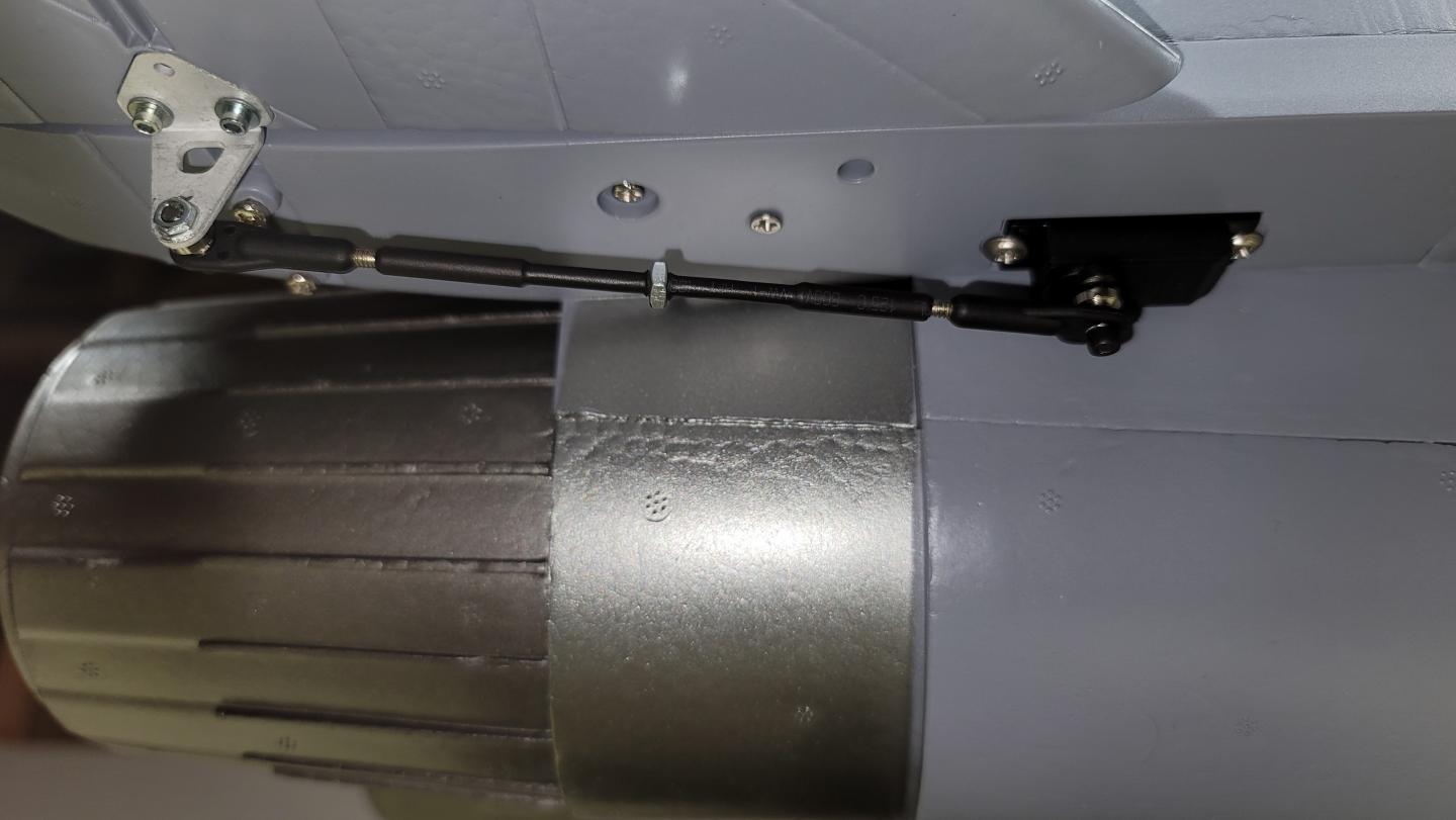

            Pic of my finalized elevator pushrods. Local hobby store had the 4.5 inch Hangar 9 Pro-Links, but I opted to spend $5 over $17.99 and make my own.
                      Sorry, but thrust line is a terribly poor way to solve trim issues. It is (obviously) highly throttle dependent, and you don't want your model's trim to be dependent on neither speed nor throttle setting.
                      The model needing lots of elevator trim needs to be solved as much as possible with CG (and can be somewhat helped with a little reflex).
                      For my part, VT nozzle neutral position will be somewhat lower than the stock nozzles. Fixing that thrust line issue is half of the point with installing VT at all for me.
