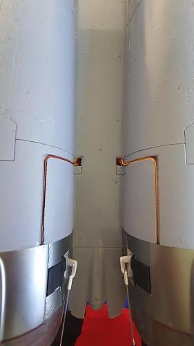

    Well first flights with the TV nozzles this morning.
    Recommended keeping it a few mistakes high as it takes a bit of time and effort to get the nose pointed down once you're done waggling the sticks.
    Install is a breeze, really well thought out design. There's a couple of panel lines marked under the fuse - make an incision there and you have a clear run to push the servo wires up to the battery area.

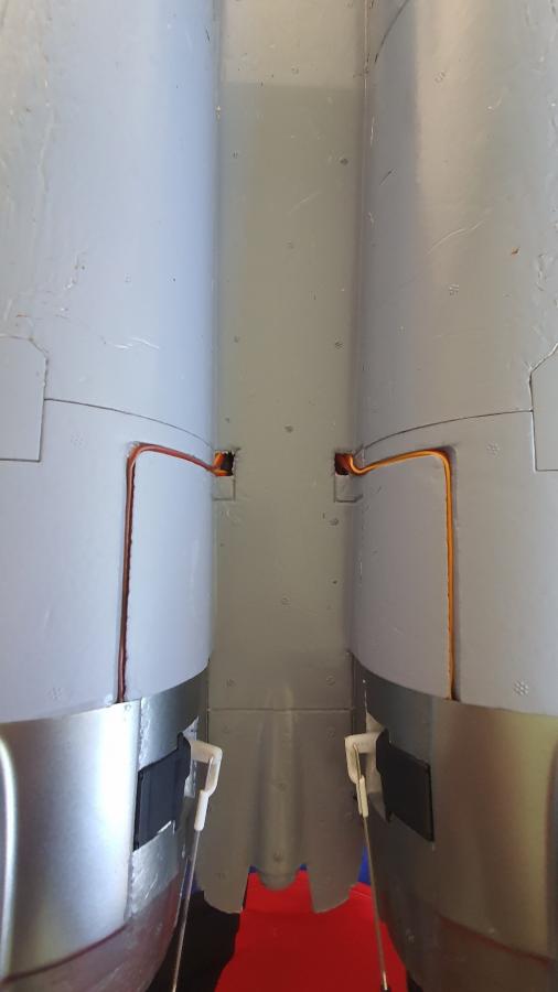

      Congrats on remaiden!
      Pics of the wire routing?

        #3563
        Sure thing (battery bay wiring loom is... classified)

            #3565
            I assume that you used the wire thingy to get the wires passed through? Nice job!

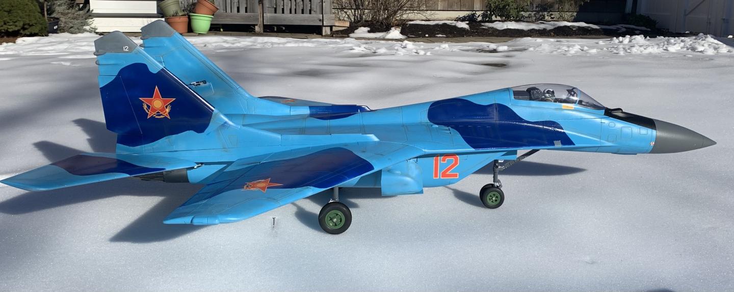

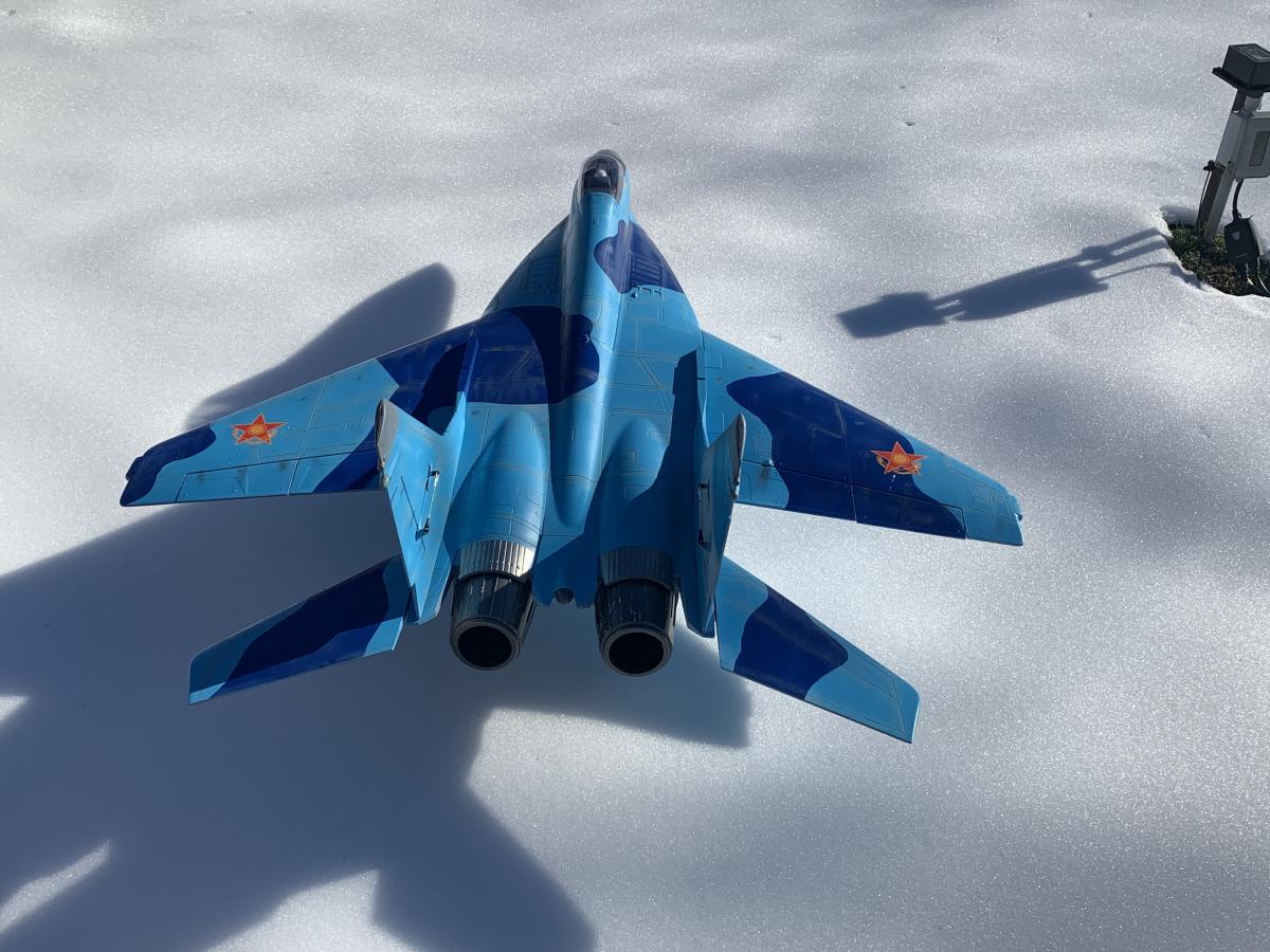

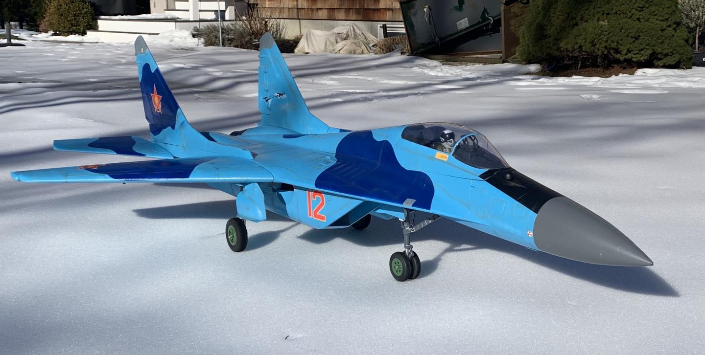

ID:	291205Click image for larger version
ID:	291204Click image for larger version
ID:	291203 Colors of Kazakhstan with some light weathering .. Callie graphics of course

                  #3568
                  PUN, Super repaint. Beautiful bird. Best, LB

                    #3569
                    Thank you Sir!

                          #3572
                          Yep the beloved go-get-em wire from freewing made light work of it.

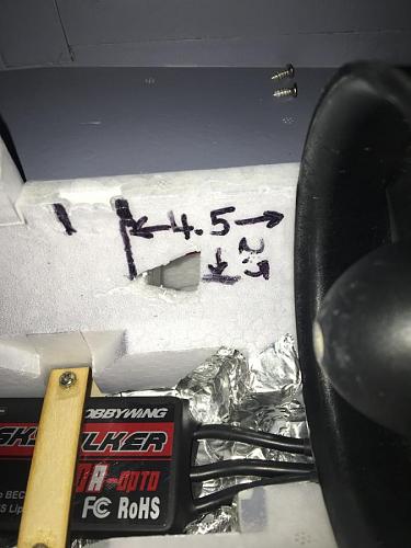

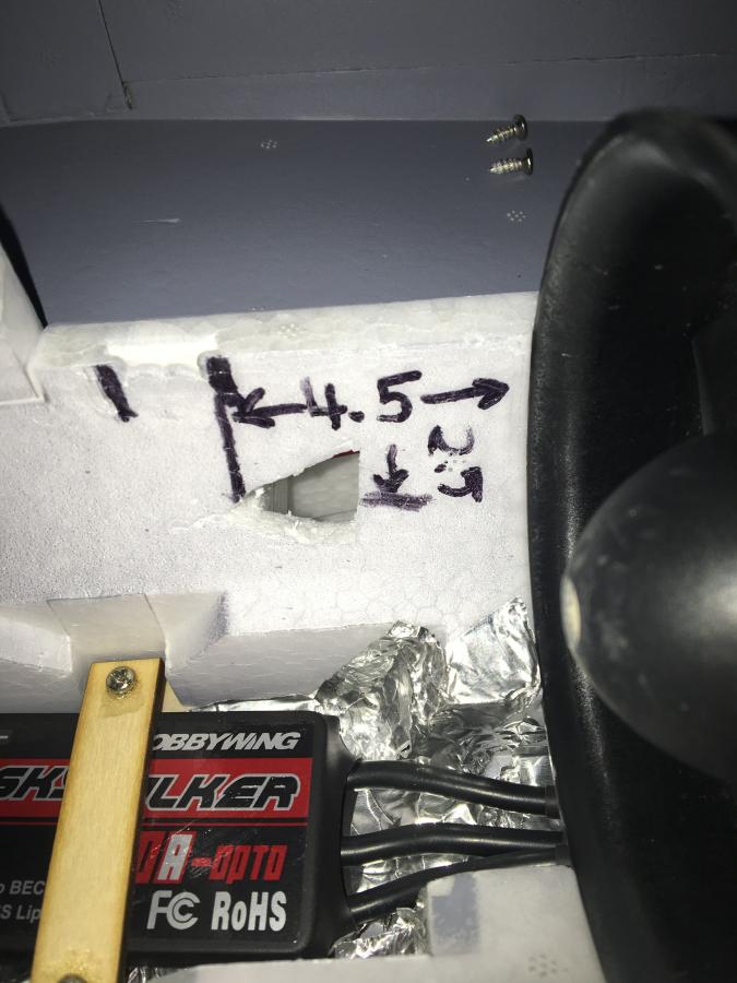

                                The lack of cooling air flow vents in the battery compartment has been mentioned as a concern in prior posts. I also would prefer some airflow for both batteries and the BEC. Soooo.....I implemented a very EASY fix and verified with smoking Q-tips held in the rear battery area. MAN!!! What a difference. The lid on mine fits with a slight gap, so air inlets shouldn’t be needed.
                                Note: The vent cuts are made on the intake wall nearest the center of the fuselage....do this for both left inlet tunnel and right inlet tunnel.
                                There is an odd shaped foam wall with an air passage around it (the air gap is toward the fuselage topside) in the guts of the center fuselage, so start the cut no further forward than the 4.5 cm ahead of the fan as shown. I centered it at 2.5 cm from the edge, and made the base (fan side) of the triangle 1.5 cm wide.
                                After doing this on both fans, there is significant air flow moving from the rear battery to the fans. I will experiment with smoke with the lid on. If I don’t see smoke being sucked in, I will add some intake vents somewhere or a thin shim on both sides of the lid seat area to hold a thin gap open.
                                This is an EASY modification to get some cooling air flow for the hot summer flying to come.
                                It ain’t pretty work, but it is totally enclosed, so I didn’t focus on craftsmanship.
                                You can see the aluminum pipe tape RF “shielding” that I added....might help and might not. Doesn’t hurt.
                                I found a tiny piece of rock embedded in the foam ahead of one fan and saw the damage it did to several blades before it was shot out and into the foam. It is a good idea to periodically inspect even these somewhat protected fans. Who would have thought?
                                -GG
