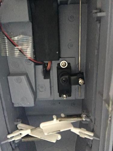

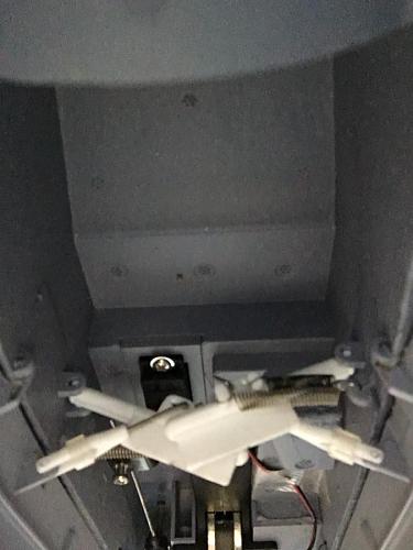

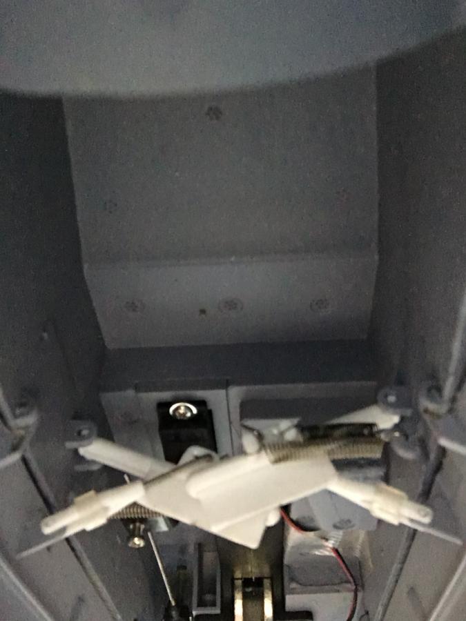

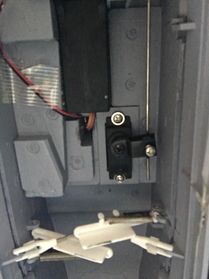

          I am rebuilding my Mig 29 after crash. If anyone could take photo's the front landing gear doors to illustrate how everything goes back it would be very much appreciated. I checked Youtube nothing there and nothing in the manual. I know it's not rocket science nut??
          Text 803 206 9396
          Thanks for any help.
          Duke2275
          • GliderGuy
            • 1417
            #3485
            Duke2275
            One photo looks rearward and one looks forward. At one time I added a second spring (the small black one) because I thought the doors were blowing closed and jamming my nose gear from full retraction. Turns out it was a bad gear servo. But I left the second spring on. The stock spring arrangement is to hook onto the pin nearest the door. I moved mine to the inner pin when experimenting and never moved it back out.
            Hope these help.
            Click image for larger version  Name:	image_65210.jpg Views:	3 Size:	59.3 KB ID:	289165Click image for larger version  Name:	image_65211.jpg Views:	3 Size:	60.8 KB ID:	289166
            • duke
              • Aug 2013
              • 45
              #3486
              Thanks GliderGuy
              As they say, a picture is worth a thousand words. All back together.

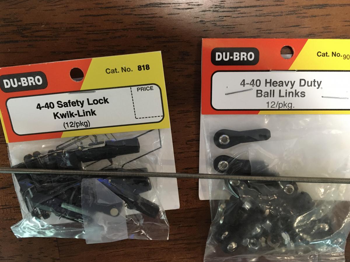

                              Good info thanks!
                              I guess some titanium pushrods would work? Anyone have the size off hand?

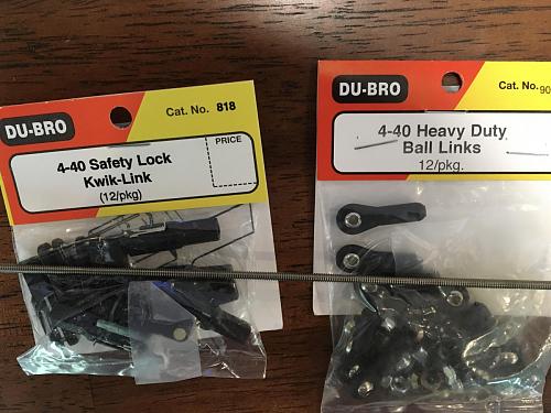

                                These have been reported to work (currently out of stock):
                                https://www.motionrc.com/products/fr...ng-pushrod-set
                                Or DU-BRO 4-40 threaded rod and hardware in the photo.
                                Head Evan’s additional suggestions. FYI - Setting the flaps and ailerons so they sit “up” (reflex) a bit has been shown to improve the flight characteristics.
                                -GG
                                Click image for larger version  Name:	794DDCC3-C0FC-4145-8563-17AC9381C764.jpeg Views:	0 Size:	137.9 KB ID:	289613
