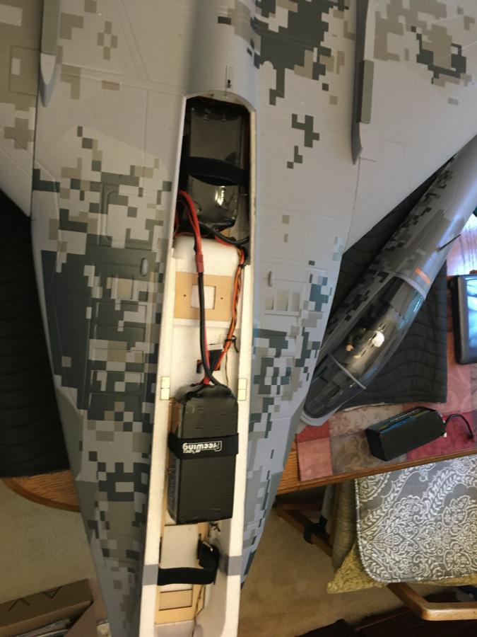

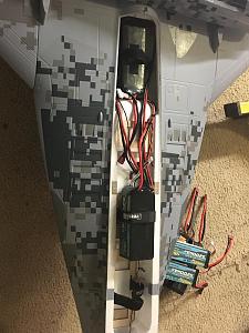

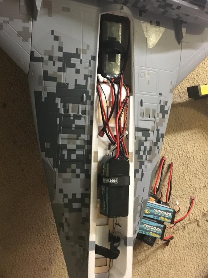

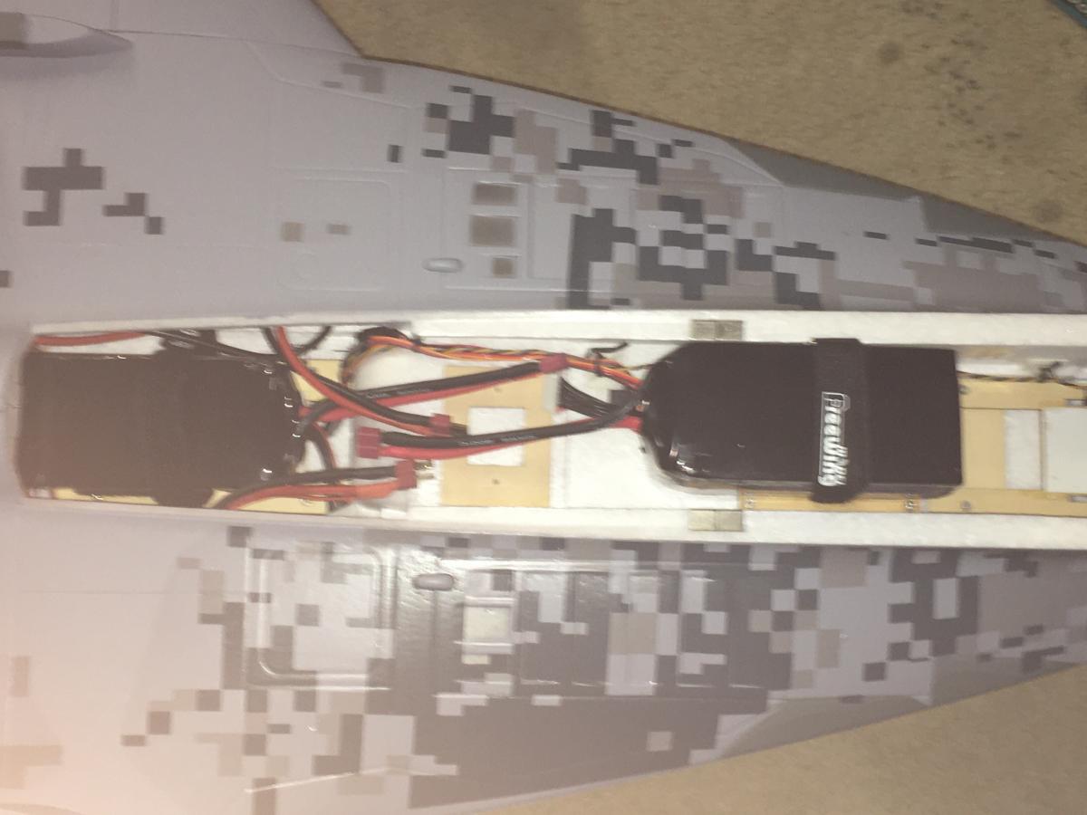

                              Argh. Struggling a bit with battery and rx/wire placement. I have Spektrum 5000 and HRB 6000 batteries. With both of these setup, I need to use the rear and middle battery location to CG. The issue with this is that the wiring mess is hard to control and the UBEC seems like it's way too close to what will be a hot battery in the middle spot. I guess I will place my rx in the front battery bay, but I'd like to see some pics of your setups (nothing crazy - just typical single rx with battery at rear and middle.
                                • 5401
                                #1495
ID:	276656Click image for larger version
ID:	276655 I'll add some pictures. These are my 640g 5200 and 760g 6200. The pic with a battery in the forward bay is balanced on the mark. The one in the middle is balanced a finger width behind.
                                  • 5401

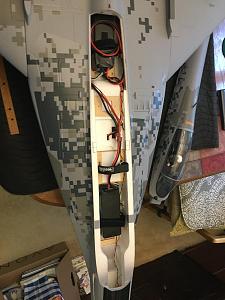

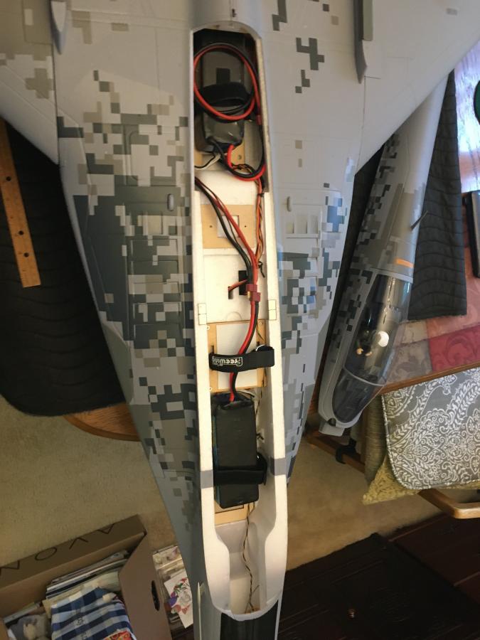

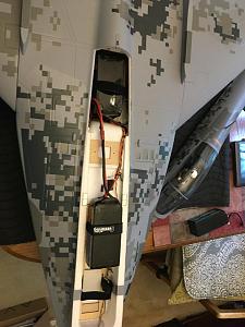

                                  Click image for larger version  Name:	7E911BC5-9CB1-4C39-A353-A73139763AF2.jpeg Views:	0 Size:	77.3 KB ID:	276658​ Here are the different balance locations with 6200s. The lighter picture has them a little rearward for the slightly tail heavier balance.Click image for larger version
                                    Hi e007 - I wanted to get the UBEC away from the middle battery due to a lack of room between the battery and the canopy/lid. If you have soldering talent and can make good connections, I didn't hesitate to cut the wires on the UBEC and soldered in an additional length of 2-conductor sufficiently long enough to allow the UBEC to fit nicely out of the way in the wing root. In my case, I tucked it away in the right root. My RX sits in the front bay all by itself. Nothing magical about these UBEC wires....just conducting dc supply current.
                                    Using 2 Admiral Pro 6S 6000 situated in the rear and middle bays. I used several zip ties to keep things tidy. Balances spot on the CG mark which may be more nose heavier that some like. But...I am pleased with the way it flies, and it only requires the smallest of forward stick when flown inverted.
                                    -GG

                                      #1498
                                      Man that looks so tidy with the blue box hidden away. You just solder in an extension for the LED and use regular extensions for retract and steering?
                                        • 5401

                                          Thanks, as I have noted I bypassed the MCBe and sub'ed extensions to run the ailerons and flaps to my receiver that is under the battery tray. The retract doors and WT lights go to the MCBe along with the retracts. I simply use a regular extension and remove the signal wire and trim the plug that plugs into the MCBe for the lights.
                                          The tailerons, rudders, and steering also go direct to the receiver. I used shorter extensions for the tailerons and rudders since they didn't need all the length. I added a extension to the steering, nose retract and nose light. It's a lot neater but not as good as my F-18, A-4v or Avanti if you look in my pictures in RCG.
