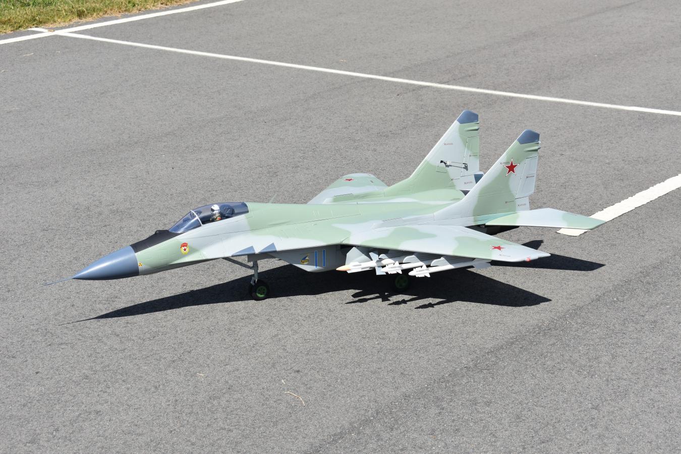

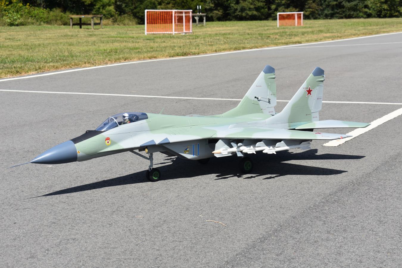

Successful maiden today! Flight was with the replacement servos installed. Only got 2 flights on her. Needed some up trim at factory CG but not too bad. Seemed really "twitchy" to me in the roll channel at factory throws so I reduced them to half of recommended for the second flight. That was much more to my style of flying. Second flight, I moved the front battery a 1/4" aft and took out some up trim but it looked tail heavy in the turns so I'm going to go back the original CG. Seems like a pretty honest flyer overall. Lands well and isn't a handful to fly. Definitely a keeper!
