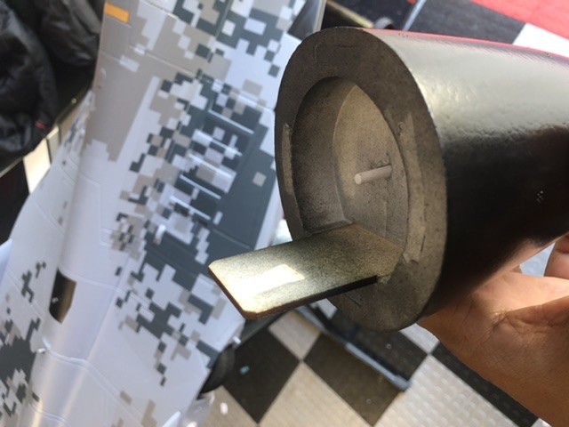

            This is how I store the pitot tube after each flight and during transport. The nose cone can be put on by just making a small indentation on the bulk head.
