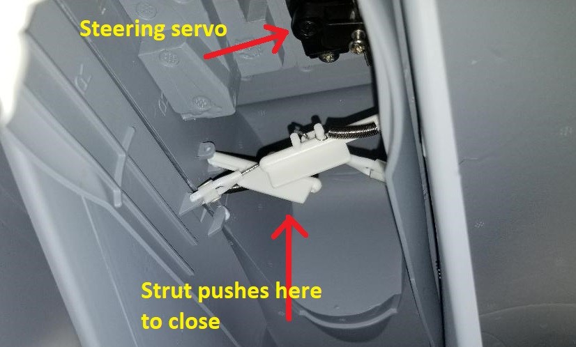

    Going back several pages where there was someone who had one of the nose gear doors catch on the strut and jambed up the retraction, I mentioned something about adjusting the "rod". Now, I'm not sure about whether or not this came into play but the owner indicated there are NO rods for the doors. Well, in fact, there ARE rods and the length of each rod determines how far each door goes open and whether or not the doors close flush. He went on to say that altering the strength and length of the spring fixed his situation.
    1. For those of you who don't have the plane yet, below is a photo of the front gear door design. When the gear is up, the rod length sets the position of the door. The spring sets the opening force. Several people reported removing the spring and shortening it a bit.
    2. I didn't see mention of this anywhere in the manual, but I noticed that the model comes with a Y-cable for the elevator. I had set it aside and forgotten about it. You have the option of using this Y-cable instead of going through the box, which might have the advantage of lower resistance. I didn't measure resistance, but the wires are parallel directly from the Rx (and therefore half the resistance) for that length. Also it results in one fewer pin connection in the path than the stock "cable-box-cable" arrangement. So overall I'm guessing the current capacity is a tiny bit higher. I'm going to change it out, just because I want to maximize elevator performance. It should be self-explanatory, but also somebody posted a video of how to change it out (in Chinese, but visually clear):
    Link to video on Y-cable:
    Pic of front gear door mechanism:

      I did the original post on this. Sorry....I meant to state “no servo-activated door rods”. My bad.
      What I finally settled on was to move the “stock” springs to the anchor posts nearest the centerline of the fuselage...there are 2 spring posts on the white plastic activation rods.
      RESULTS
      - Doors still close easily enough w/o placing too much load on the gear retract servo.
      - Not 100% a solution. If I don’t slow down before hitting the retract switch, the door(s) “may” blow in enough to catch the shaft and/or wheels and hangs.
      - If I hit the retract switch right after take-off and under full power, original spring anchor post position would allow the gear to hang 80% of the time. After moving the springs’ anchor points, it’ll hang maybe 10% of the time. Great improvement.
      Total solution that works 100% of the time = Take off, climb to downwind, leave flaps down, slow to less than 1/2 throttle, level out, retract gear. Note: With the spring on the original post, this worked only 90% of the time.
      I’m OK with the results. I can still make jet-like climb-outs after take-off with gear and flaps down.

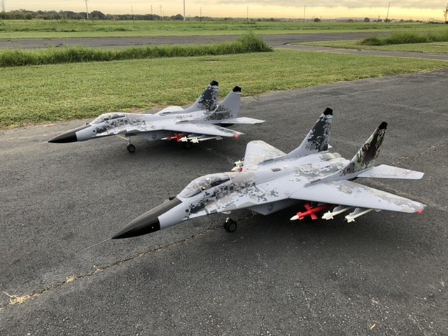

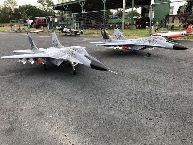

            We now got two MiG’ at our field!!!
                    Thanks for the tip, I didn't notice those until you mentioned them. Seems easier than physically shortening the spring, and should have similar effect.

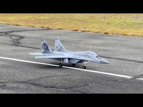

                        Flight number 3 love it!!

                            Great job!

                                    Excellent flying!
