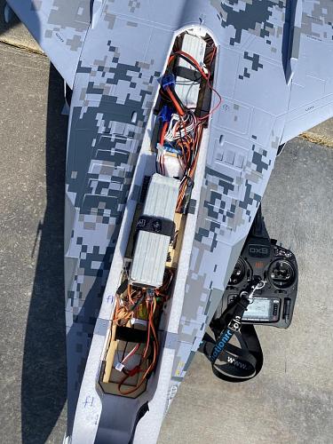

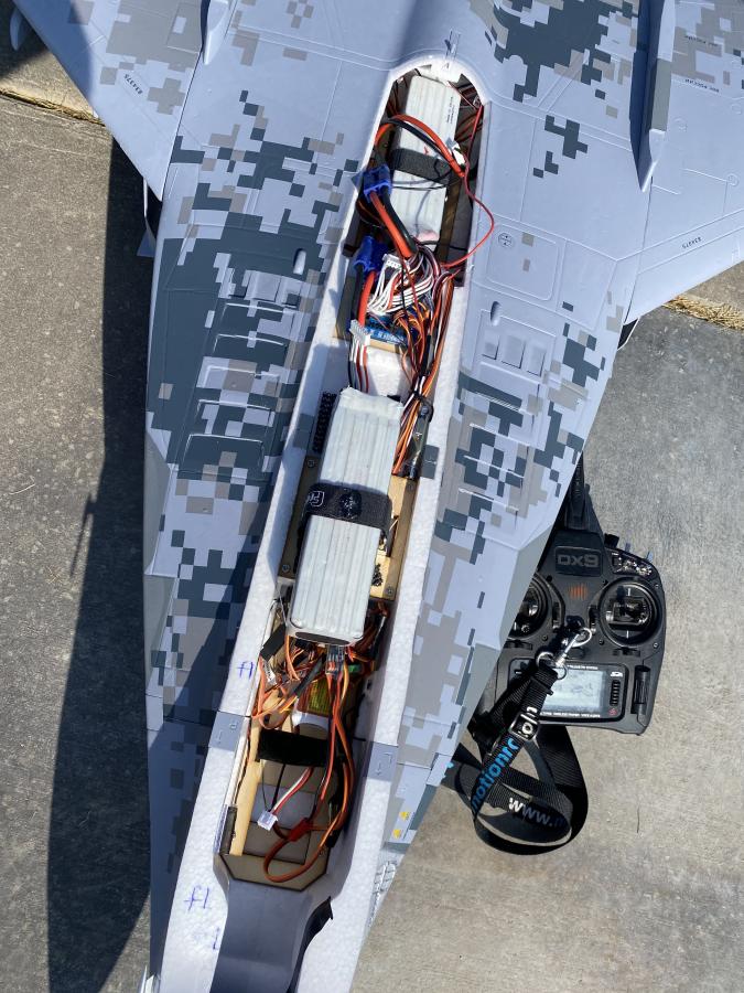

                          I said generally, not always. I got mine to almost an inch aft of the marked CG with light 4400mah RTs while doing some testing, and out of a nose high power stall she proceeded to do a rapid double back flip before settling back into her tail slide. Power to idle and a hard roll to the wing, and she dropped the nose and flew away. Power to idle alone would not recover the jet this far aft, you have to roll off on a wing. The pitch which was fine before when closer to being on the CG marks, was obviously hyper sensitive at this aft CG and required mid elevator rates (usually flying the jet on high) from take off to touchdown, and a very gentle thumb even on 30% expo to fly her back down in one piece. The double backflip and recovery took close to 200ft of altitude, so user beware.
                          I might also mention that mine has almost 30 flights on it now, and the stock 17g elevator servos have performed great when set up per the manual. This includes unscale rapid G onsets, negative and positive, from low to high speed. It also includes power dives with intentional pull outs 10-20ft over the runway, as well as falling leaf full deflection slams.
                          For those wondering. You can get her to CG 1/2” aft of the CG markings with 4400mah Roaring Tops right here, using the middle and aft bays. My jet has a sound system just slightly forward of the CG and RC Geek centerburners well aft of it. Moving the middle position battery aft allowed me to fly it with a CG around 1” aft of the markings.
                          okay....i keep seeing various batteries on the middle position. i just cant seem to get the aircraft to cg there.
                          Spektrum Smart 5000mAh 50c, which are spec'd at 660g each. I have to move the rear battery forward, and the front bay battery against the rear most wall to balance out.
                          in that configuration, gear down, it will just teeter nose down when lifted at CG marks, then gently settle level. (indoors, not wind impacted)
                          Anyone video their cg configuration and balancing?

                              Spektrum smart batteries tend to be on the light side. I've always felt that with these smart batteries, we aren't getting a true mah and "C" rating as stamped on the label. The typical 5000mah, 6s batteries in my collection each weight between 750g to well over 800g - Gens Ace, ChinaHobbyLine, Turnigy HD, Admiral, Revolectrix.

                                          Just maidened mine......upgraded servos installed. Overall, I'm pretty happy with it. It flies well and is easy to land.
                                          2 things though: I was hoping to get a little longer run time (4 minutes MAX on RT 5500 mah....I'm pretty hard on EDFs though) and my CG is 5mm aft of the marks and I still needed 5mm of up elevator. The plane does not fly nose heavy to me, but that seems like a lot of up trim (and alot of drag)
