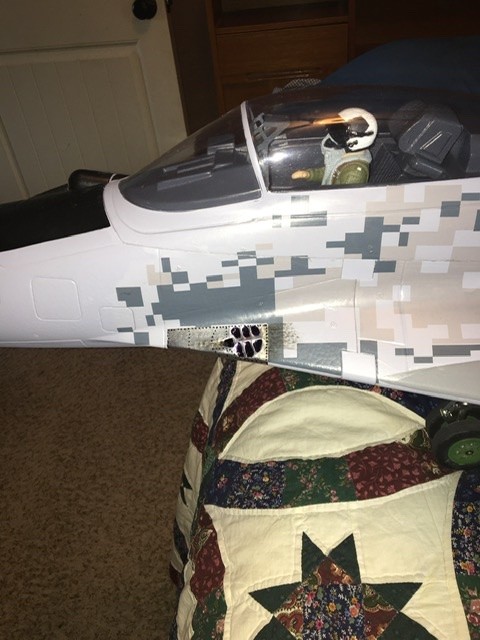

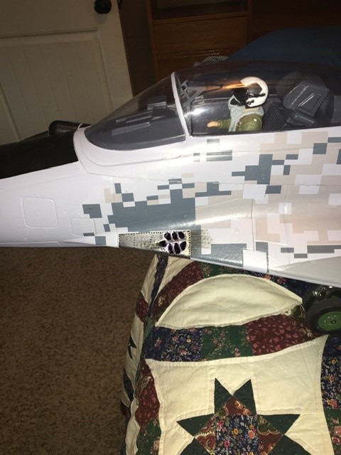

                                    Click image for larger version  Name:	5D23D23C-2763-44AE-9A18-D95EE6ED3072.jpeg Views:	0 Size:	74.6 KB ID:	275896 Had some time on my hands and thought I’d dress up the gun port. Several of you have said you are doing a 3D printing of this area. I thought I’d try some aluminum metal duct repair tape.
                                    Not perfect by any means, but standing back a few feet...it adds to the MiG IMHO. Don’t zoom in too closely. 😃
                                    Added some smoke effects and rivets/screw heads, too.
                                    -GG

                                      GliderGuy looks pretty good to me!!! I was actually messing around with some HVAC tape today doing the same thing. I was using it on a scrap piece of foam, also thinking of using some fine sand paper to dull up the tape before applying it.

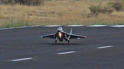

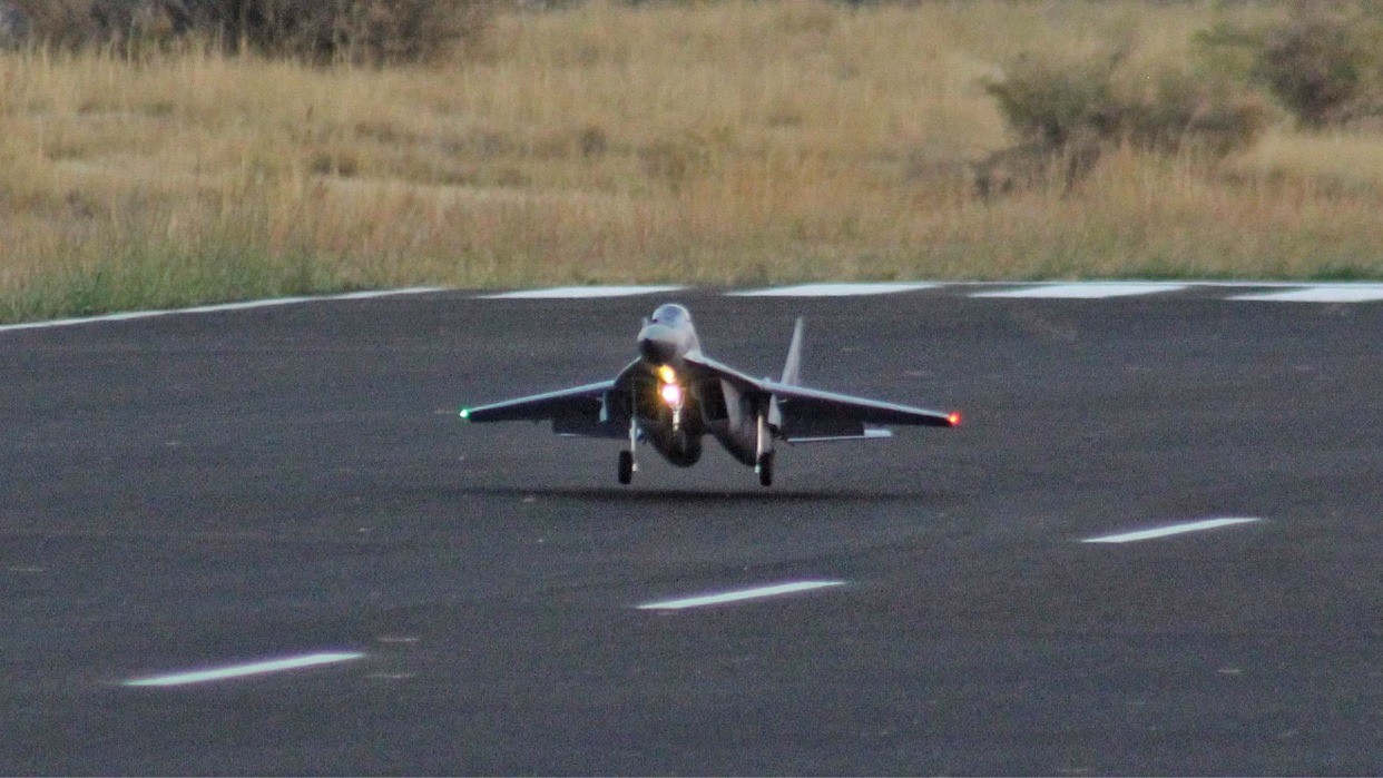

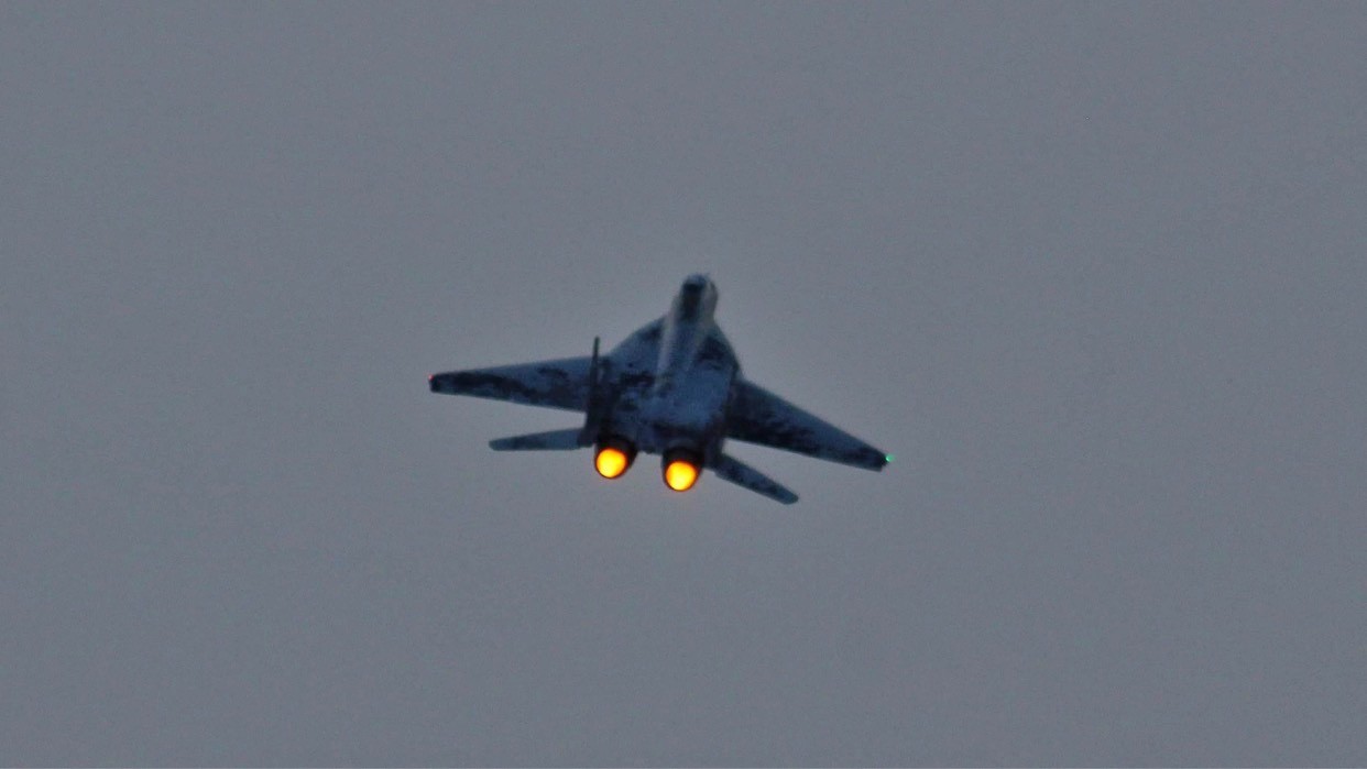

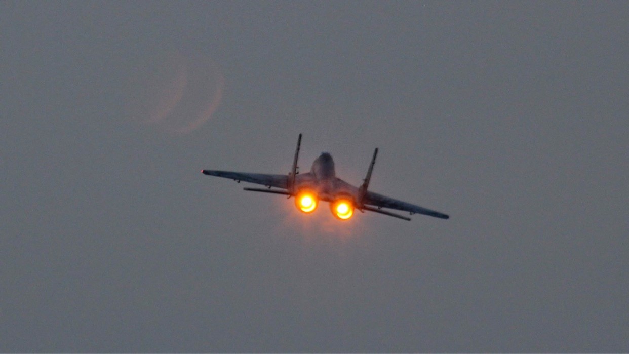

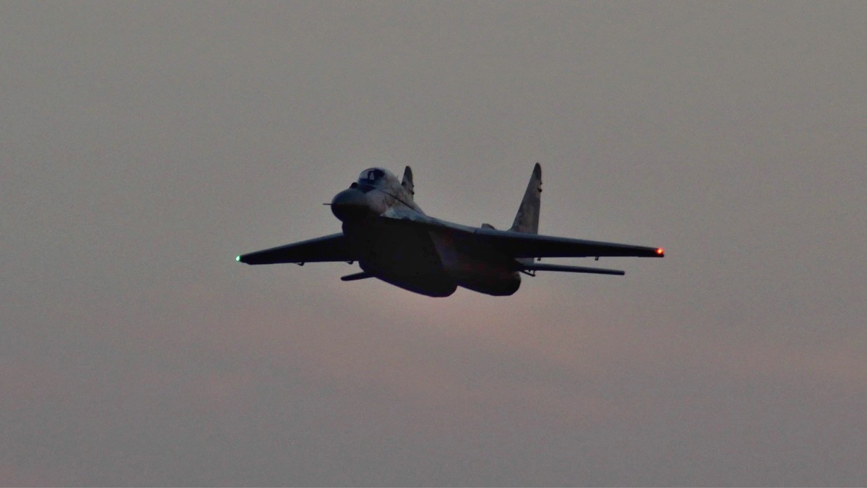

ID:	275927Click image for larger version
ID:	275926Click image for larger version
ID:	275925Click image for larger version
ID:	275924Click image for larger version
ID:	275923Click image for larger version
ID:	275922Click image for larger version
ID:	275921Click image for larger version
ID:	275920Click image for larger version
ID:	275919Click image for larger version
ID:	275918Click image for larger version
ID:	275917Click image for larger version
ID:	275916Click image for larger version
ID:	275915 Sunset flight tonight. Went live on FB after Jeremy got some of these great shot of my jet.
                                        Rocking the RC Geek centerburners.
