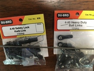

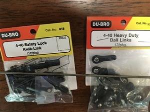

      • Click image for larger version  Name:	12E47086-AB6F-43A2-A97A-804264A108EC.jpeg Views:	0 Size:	25.7 KB ID:	274909 Since the loss of an F-4 due to ball link failure, I went overkill on the MiG. The stock elevator pushrod is much improved. But, I built new ones using 4-40 threaded rod, and heavy duty DU-BRO race car ball link hardware with SAFETY LOCK KWIK-LINKS for the servo. Overkill for sure, but easy to do for piece of mind. DU-BRO also sells the threaded rods. I don’t ever want to see a bird going down like the F-4 did.

                    There is absolutely no reason not to beef up the linkages and use good ball links/clevises with locking mechanisms. It costs next to nothing compared to the value of the model, and provides a more precise, less sloppy, less prone to failure setup.
                    Sure, the stock setup looks fine, and probably is, but a ball link that actually locks is a nice reassurance. Especially considering there is some angle to work with, and a worn out ball link may eventually be pulled off if unlucky.

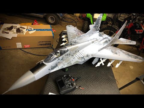

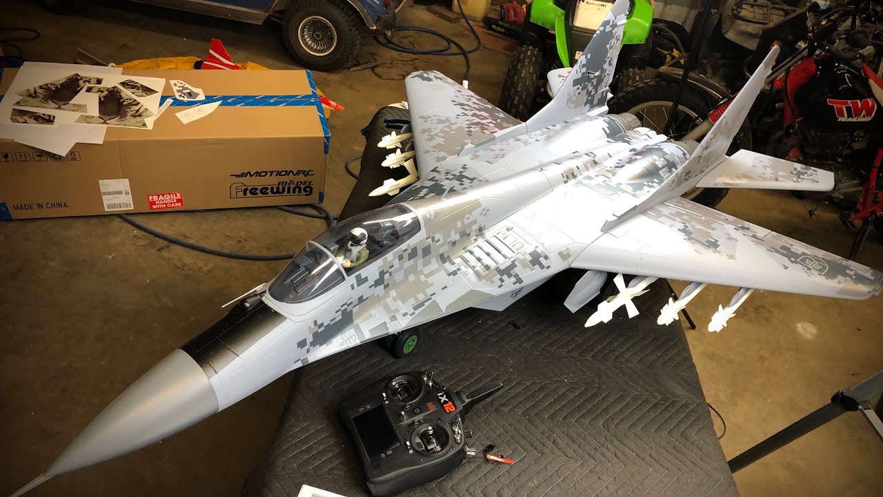

                          • My unboxing and build, and a gooniac afterburner install!

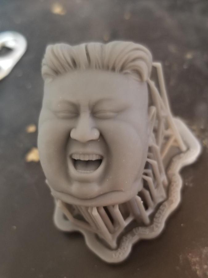

                                • I got my North Korean decals from Callie. I also found this head on CGTrader, so I'm going to replace the pilot's head with the Dear Leader himself, downloaded from this link:
                                  https://www.cgtrader.com/free-3d-pri...-laughing-head
                                  Just finished printing him on a Form3:
