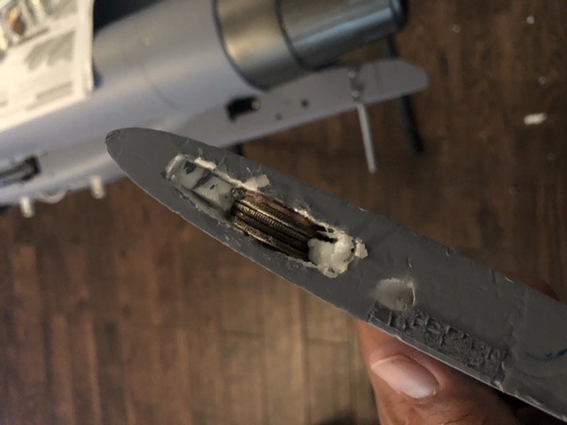

                          • If anyone is interested, it took 4 $.25 and 1 $.01 to statically balance the horizontal stab.

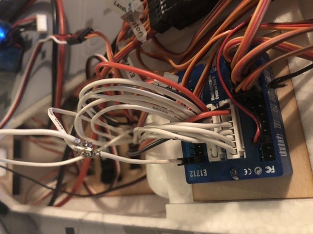

                            • And also did the retract door mod. Instead of running an extension, you can simple remove the first signal wire next to the power wire in both ribbon cables. Add a signal only servo lead and connect all wires and plug into blue box.
                                      There you go, pouring more money into a PNP. (My F-14 took $.80 per stab )
                                        That's awesome! Will definitely be doing mine this way.
