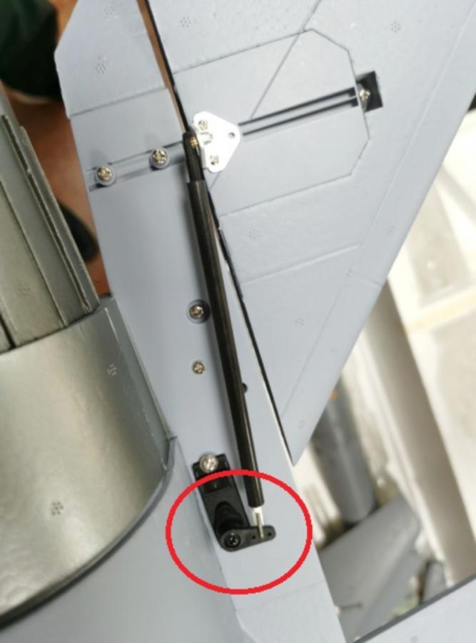

                              Some tips for those maidening their new birds:
                              1) I know this goes without saying, since pilots operating this MiG-29 are Expert level modelers, but it's worth emphasizing that the MiG-29's elevator servo horn must be set up per the manual as shown below. The middle hole is the only hole into which the control rod should be mounted.

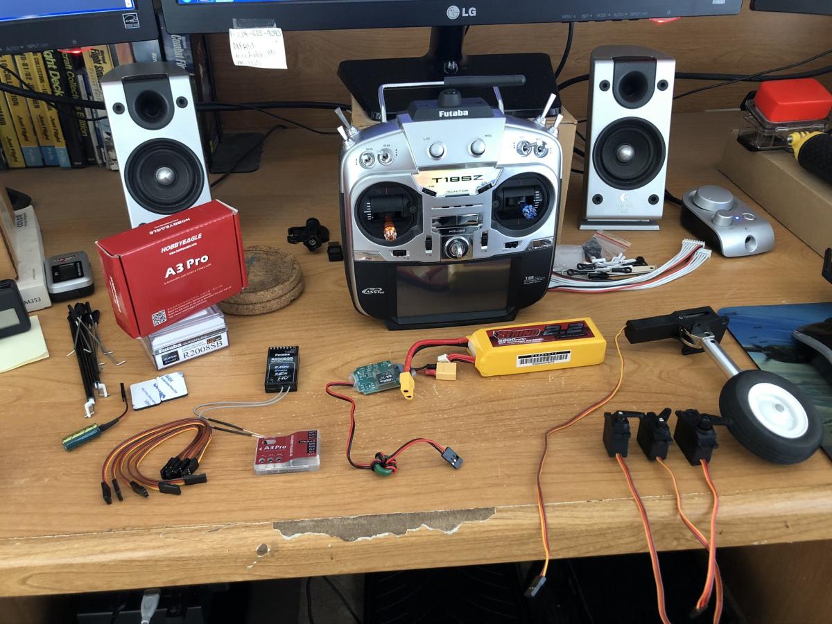

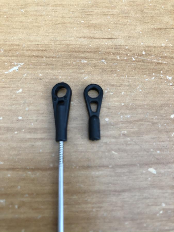

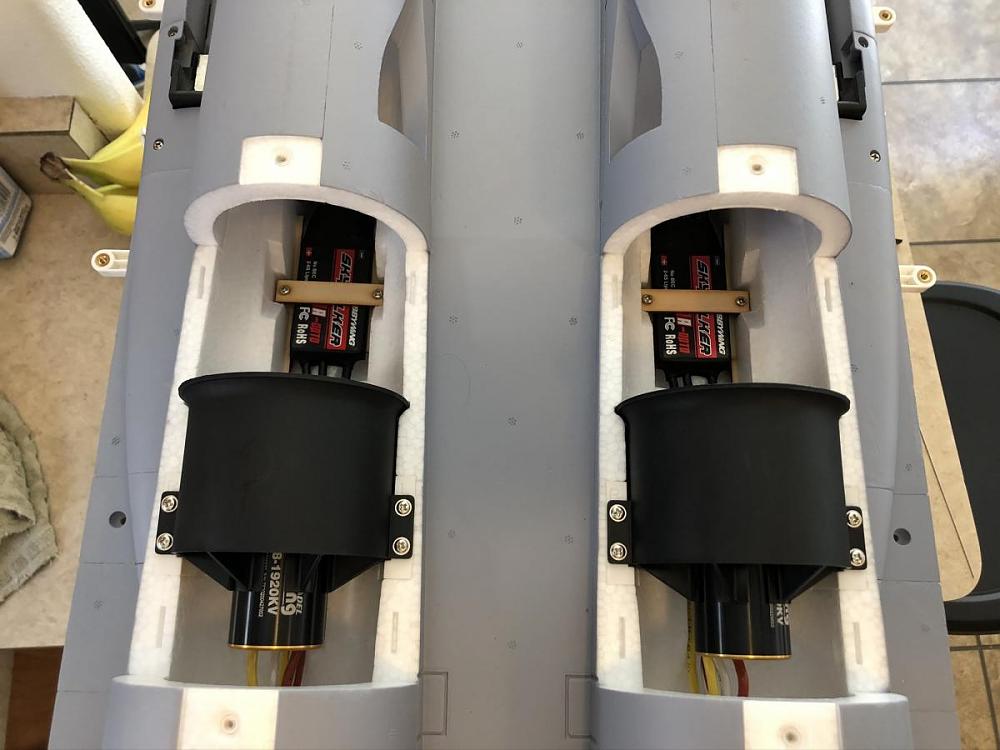

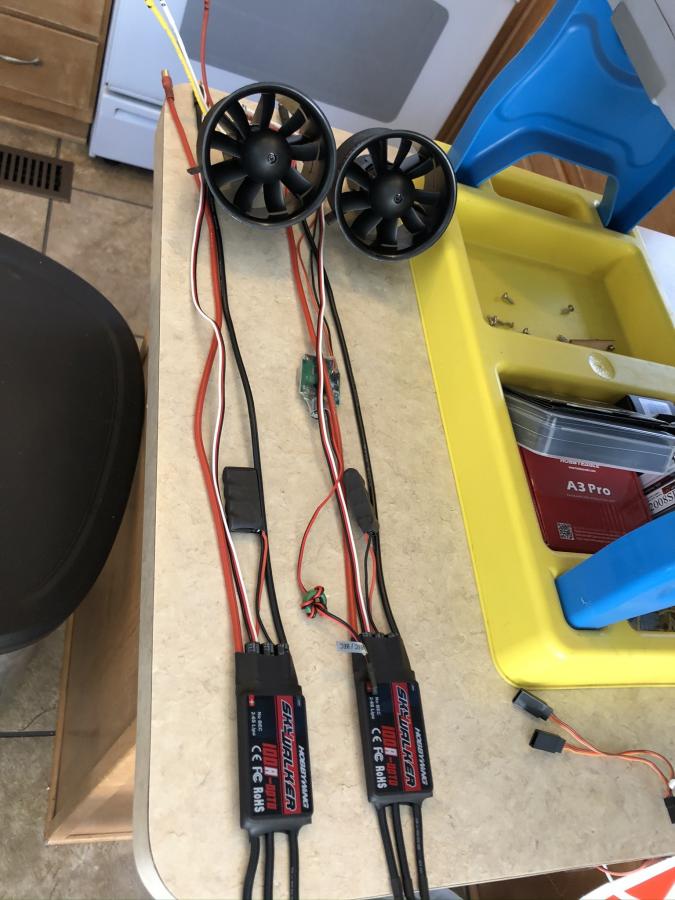

                                      The tension in here is high as your MiGs get closer and closer. I know many of you know what you're doing but I wanted to point out a couple things I went over on my build. I estimate I spent about 45min building the jet and about 6hrs setting it up. I pulled the engines to check the fans, pulled the ESC's to solder bullets, and setup my radio system on the bench first before installing it in the plane. Make sure to set the elevator servo horn positions to the middle hole and set the manual recommended 1mm of nose UP neutral trim. Book rates seemed solid with 30% expo on elevator/aileron.

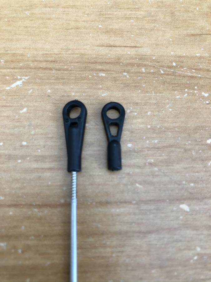

                                        I was really glad to see beefier turnbuckles on the MiG. MiG turnbuckle on the left.
