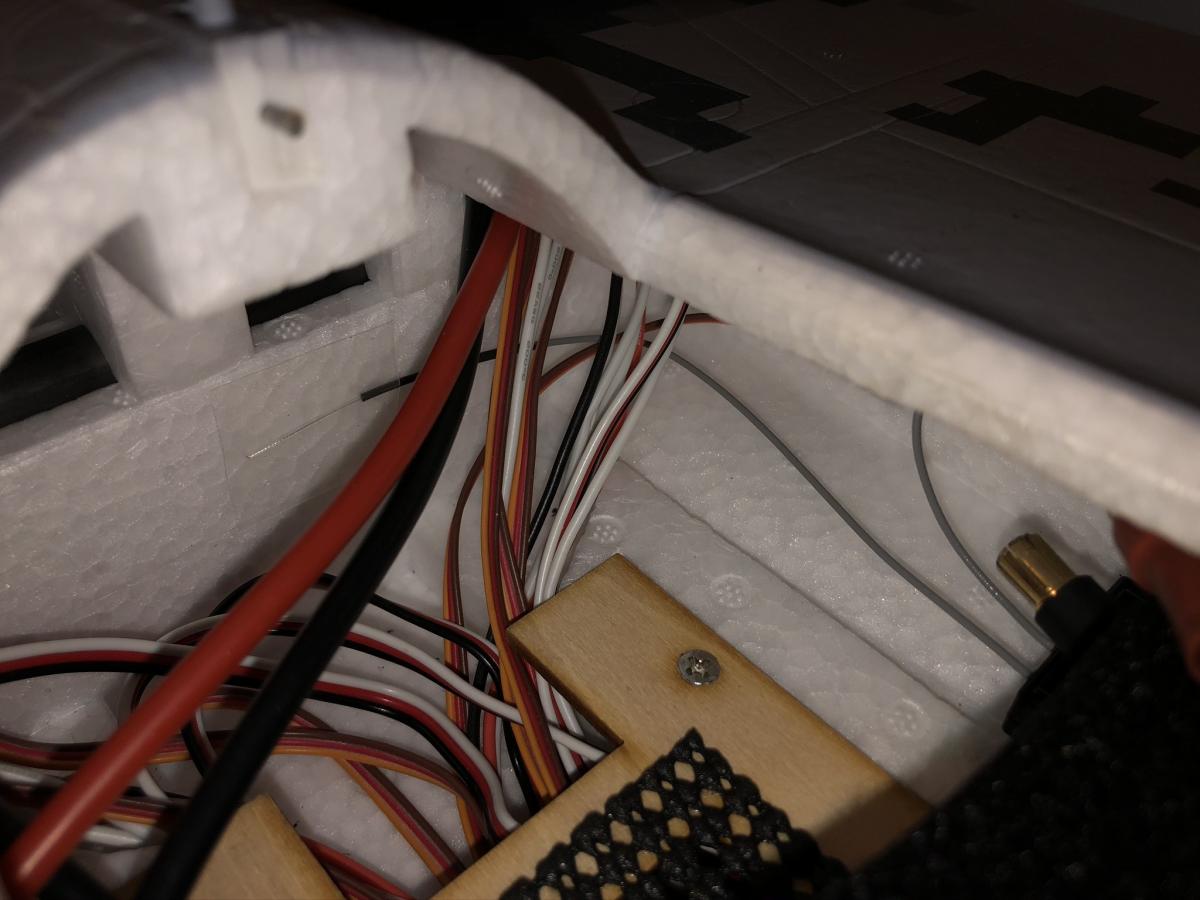

                              #754

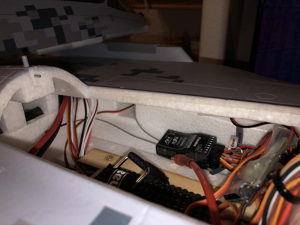

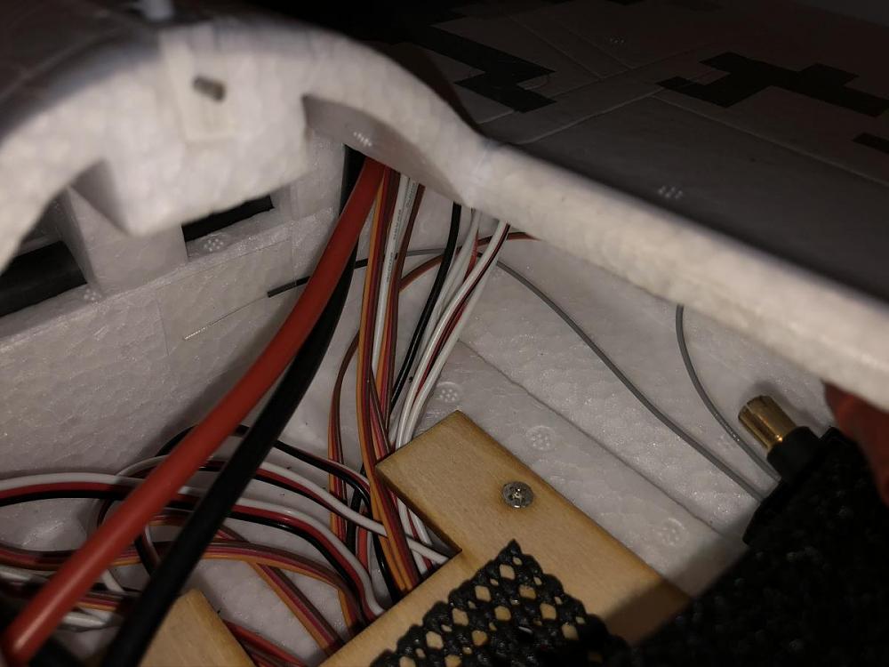

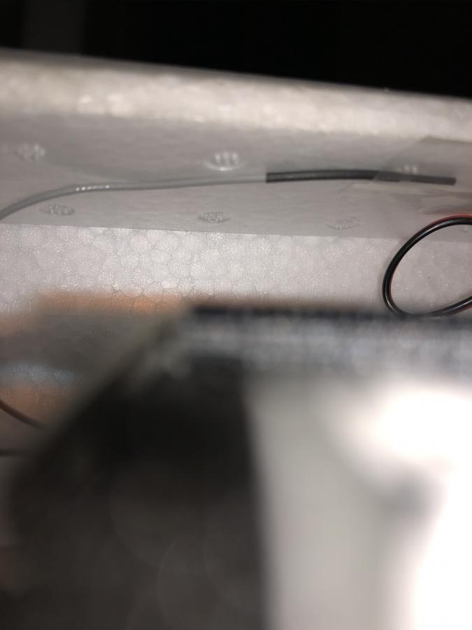

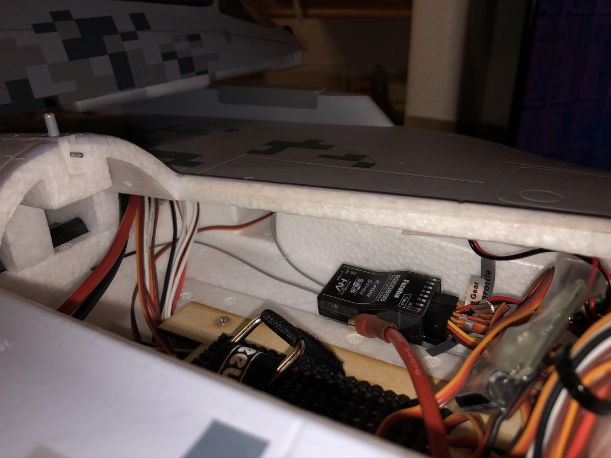

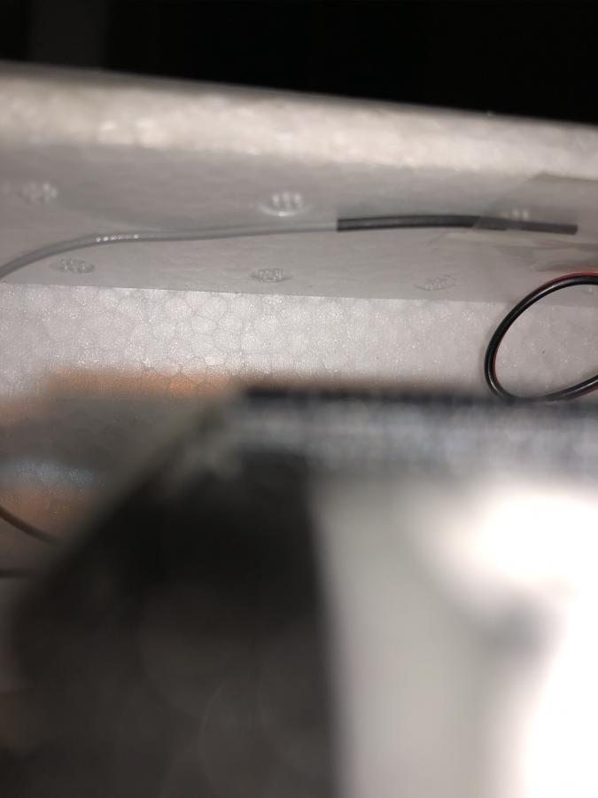

                              Originally posted by Skosh25
                              Can you show your antenna routing? I’ll be using the same receiver. Actually a 7008SB, but basically the same.
                              I taped one to the bulkhead behind the battery and one to the ceiling of the side pocket.
