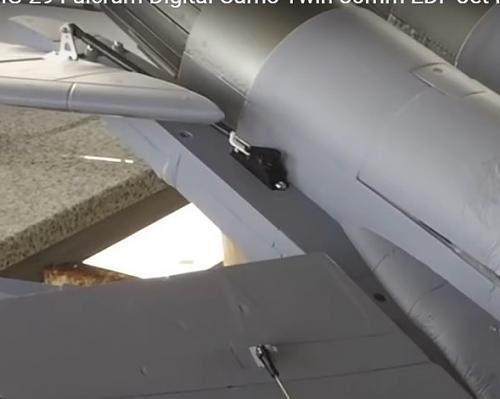

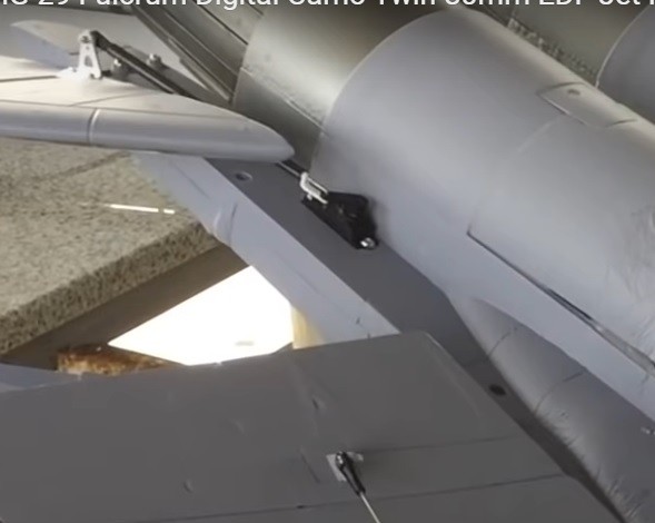

                    This is a grab I took from the now infamous video on youtube. Note that there is some handling of the elevator before this is taken, so it does not represent the servo position at the point of impact.
                    But there is certainly an issue with the setup ;)

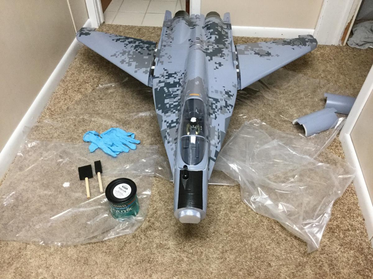

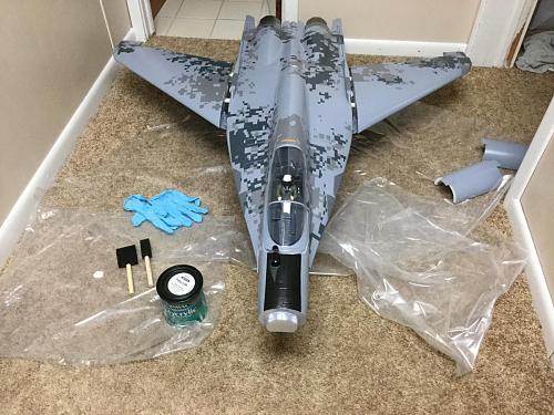

                                        Whew, good thing i waited to maiden until after i got that clear coat on or i might have had an servo issue getting it out yesterday afternoon. On another note, my mirage 80mm lost power and took a dive into the soft dirt ending up in a pile of foam yesterday afternoon. Couldnt tell what happened other than it acted like it went into lost signal mod. I really cant wait for that gripen now😅
                                        Click image for larger version  Name:	image.jpg Views:	0 Size:	173.4 KB ID:	274034
