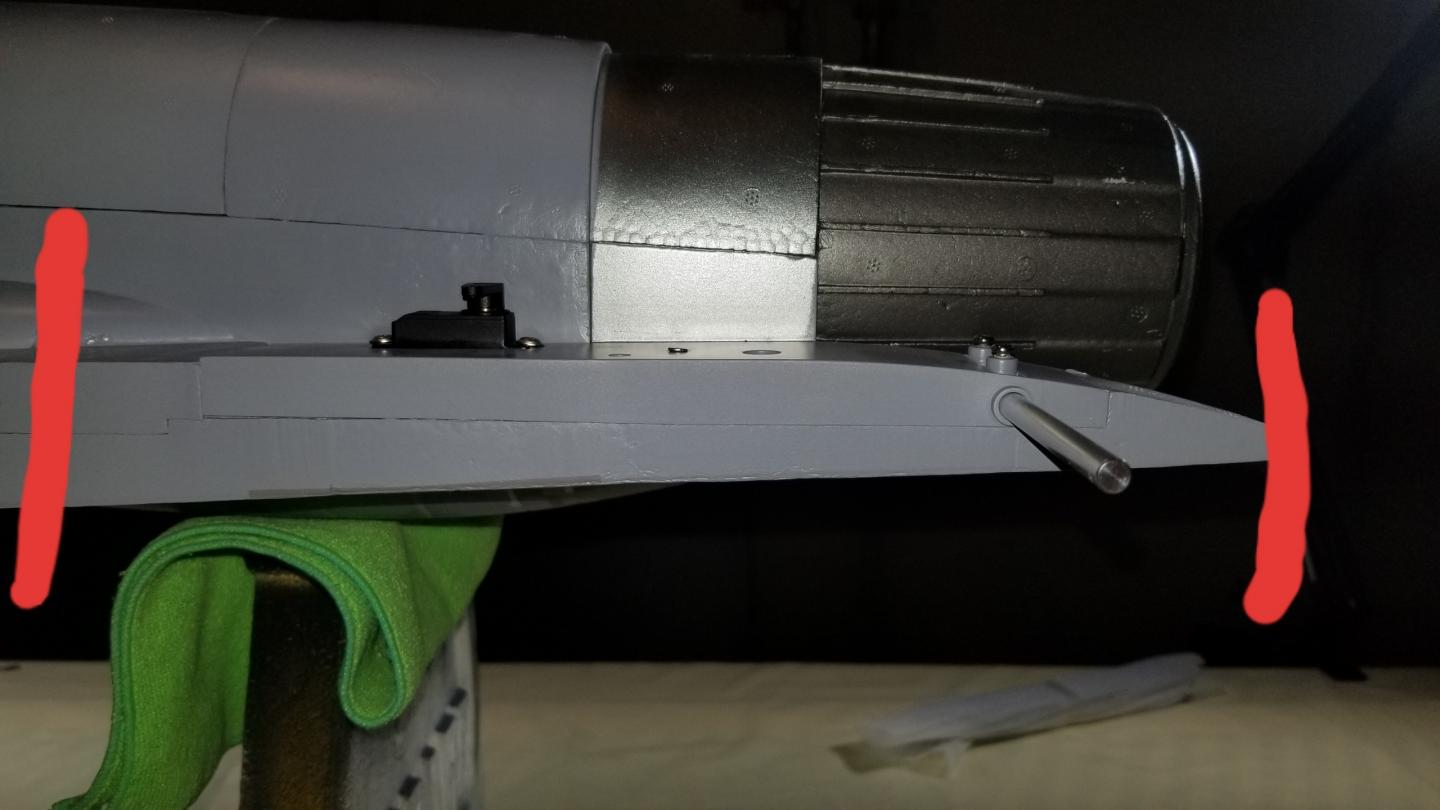

      It's not about the servos.
      The torsion of the assembly sending the stabs into anhedral changes the geometry of the linkage and prevents servos from actually producing any sort of pitch up regardless of torque. It is structural.
      You can test this in your garage, go full pitch up with your jet and force anhedral on the stab assembly with your hands, you'll see the stabs automatically reduce pitch deflection from the geometry that ensues.

      Look, for the aircraft to balance with flaps down, the tail needs to make a certain down-force regardless of its shape.
      If you make stabs shorter, you will need more deflection to achieve said force, but ultimately, you will end up applying the same force if you want your jet to balance.
      And the most important factor that everyone seems to miss... this is no longer about servo torque, but how the linkage geometry gets distorted by the structural torsion of the stab assembly, making it impossible for the servo to pitch the stabs up, regardless of torque.

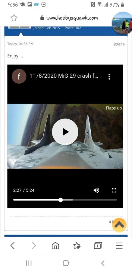

                  POSSIBLE REVELATION.....
                  Take a REAL close look at the video. Watch the area along the bottom of the vertical stab attachment. There is no downward movement...no shifting downward...no CW or CCW twisting is seen.
                  What appears to be, upon first look, the rear of the plane (FFS support area) bending and disappearing out of site is actually the FSS bending down out of sight.
                  Nothing wrong with making the rear area stronger, but from what I am seeing...air loads are bending the the FFSs down, and the support area is stable more or less.
                  This downward bending of the FFSs (more evident at the tips), combined with the knowledge that the CP is so located rearward of the pivot point, would be an indication of the loading being imposed on the servos.
                  I submit for your study and comment that the geometry of the support area is minimally changing. If it were changing, there would be deformations/changes of the top area at the bottom of the vertical stab attachment line. There's none to be seen.
                  Looks like a case of perception not being reality. Initially, I was fooled, too.
                  -GG

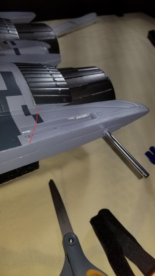

                      Still assembling mine, and after watching video, I applied down force to the stab pivot rod and there is torsional flex following the red line I drew on my photo. I'm thinking that a nice piece of CF plate epoxied to the side should solve this issue. I remember back in the day with the Phase3 F-16 that this mod was a "must do". Was the guys flaps deployed in that shallow dive or was that just air pressure twisting the stabs out of sight?

                        RC30Flyer....watch the video closely...he flashes "FLAPS DOWN" very briefly just before starting the dive. For the rest of the video prior to this, there is very little downward "twisting" of the stabs. Take note...don't fly yours with flaps down very fast if you wish to avoid the crash.
                        Once you attach the vertical stabs, the movement you see drastically decreases.
                        Strengthening this area won't hurt...but that's very likely not what is causing the problem.
                        -GG

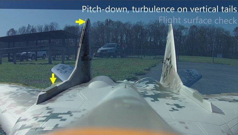

                          For your consideration - 2 frames from my video overlaid: reference shot on ground during flight surface check, and the other during flaps-down dive.
                          While the right horizonal tail is being pressed down, the right vertical tail is being pressed inward:

                            I agree...This shows only a small movement....not matching the large movement of the FFS captured at that time in the video. And there is turbulence to consider, too (flap generated?). Let's see what the others see after they re-study the video.
                            I'm not saying the rear doesn't show some deformation...the amount doesn't match the amount of movement of the FSS.
                            The perception is that the rear of the fuselage is disappearing out of site. It's not. Pretty much all the movement is in the FSS flexing downward under air loads...seemingly caused by the flaps.
                            -GG

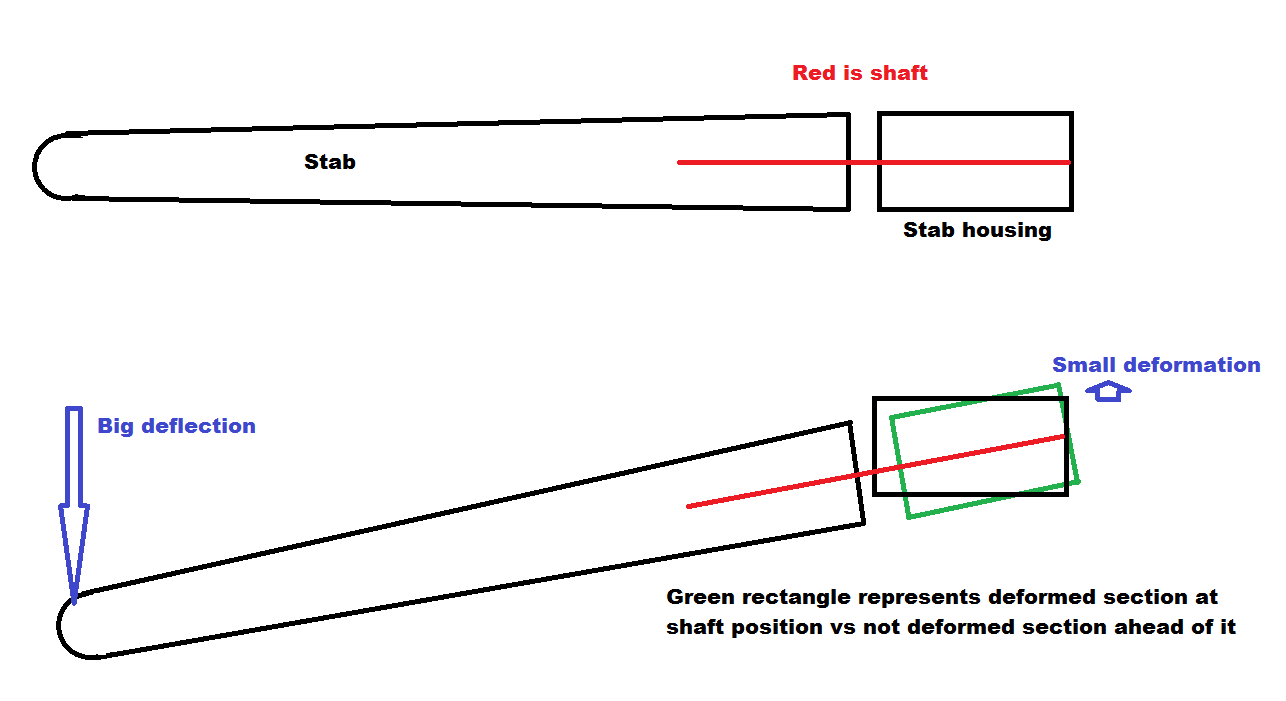

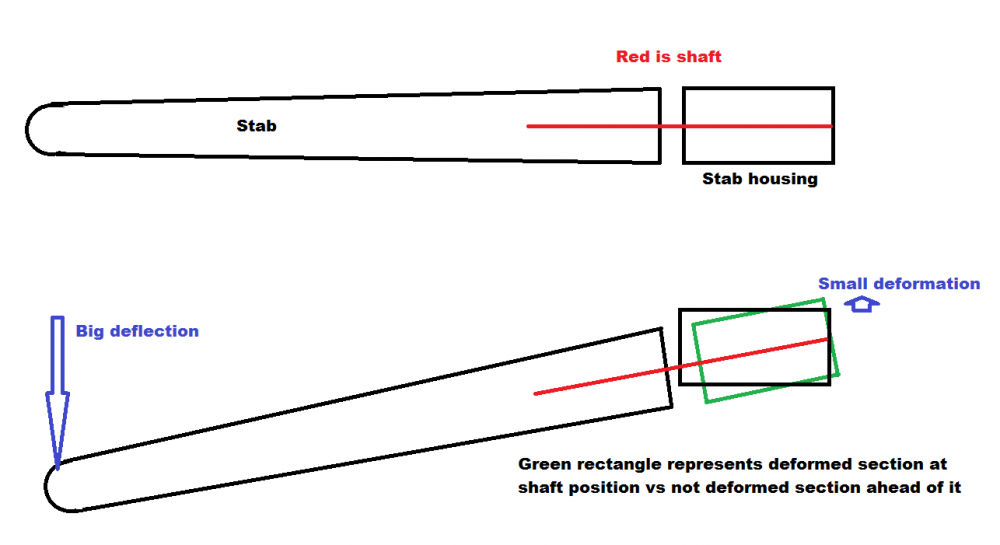

                                That argument is pretty flawed. It takes very minimal deformation from that section (that wouldn't show up on such a camera recording) that will produce the huge anhedral seen by the stabs. Again, you can test this on your own MiG. Take vertical stabs away, apply force to the shaft and see how the piece deforms. It is pretty clear once you do this exercise.
                                It does not have to. It's on the center of the torsional axis.
