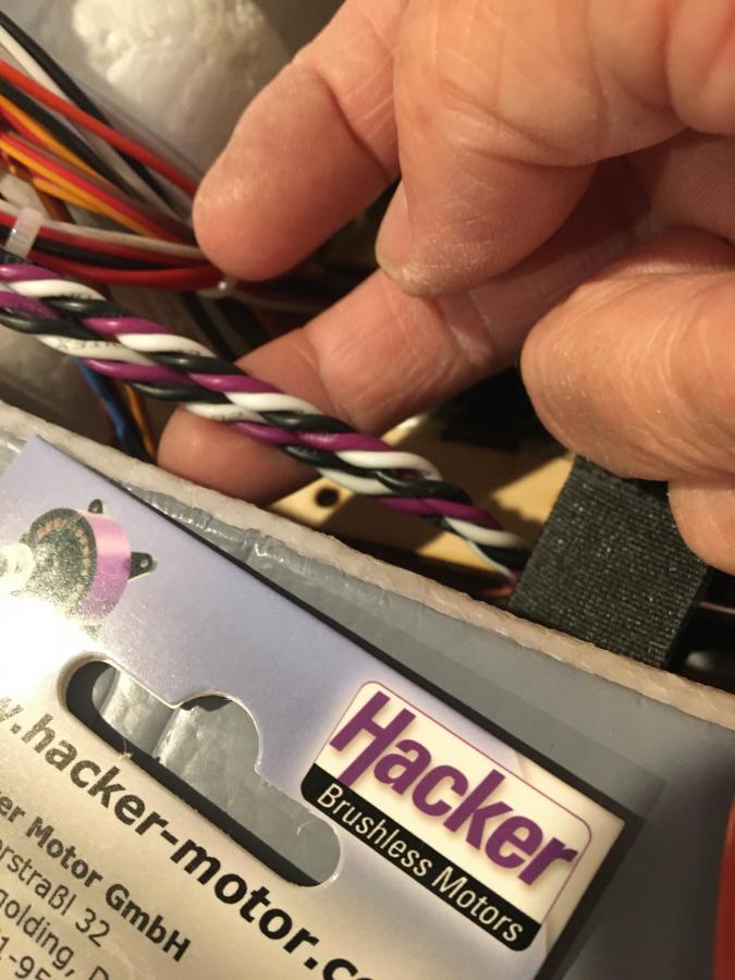

          GG, you show both upgraded extensions AND the MRC Y. Aren't they the same purpose?
          Hi Evan - MRC supplies a short (about 5 in) Y with the upgrade servos that is just long enough to reach to the 2 individual FFS drive wires that are about 70 cm in length.
          I used these 2 stock wires as “pull” wires and threaded forward the twisted 0.5 mm x 80 cm (20 AWG) from each FFS servo. Then I connected each of these to the MRC-supplied Y then tossed the stock 70 mm servo wires onto my spares box.
          So, other than the short Y to connect to the RX, the rest of the FFS drive is “new” “larger wire” “gold contacts” and “twisted”. I did not re-route as some have.
          Here is the link....be sure to get the 80 cm length
          https://www.hacker-motor-shop.com/Se...ge&rdebox=box1
          Here’s a photo of the wire as I began tucking it under the rear battery box. Lots larger diameter than the stock wires. Will help keep the voltage level higher at each rear servo.
          -GG

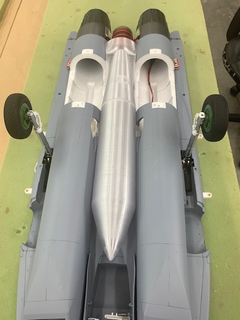

              I am working with my friend Keith (Yellowbird911) to make the Mig-29 a turbine conversion. We are both using the K-45G3 turbine. So far this has been a very easy conversion with a simple turbine mount between the engine nacelles and lots of room on top for all the extra stuff. Not much foam carving is needed. This is possible because we are using an external centerline tank as the main fuel tank. This external tank holds about 45 oz and will feed a 12-14oz header tank in the rear battery compartment and then feed the air trap tank and pump in the nose. Most fuel will be near the CG and its great not to have to carve foam to stuff all the fuel on the inside.
              Keith has designed and 3D printed tanks for several foamy turbine conversions before. The process is to print the tank and then coat the inside and outside with epoxy resin. For the Mig-29 he designed a semi scale center line fuel tank from photos that also functions as a FOD shield for the rear undermounted turbine. The tank has anti slosh baffles.
              My tank arrived today. At first look it look fits perfect and looks great and scale. Keith will be posting the CAD and 3D print files on Thingiverse so it can be downloaded and printed if desired. This conversion is still a work in progress and I will post a full build thread somewhere when it is complete. For now here are some photos of the 3D printed tank.
              Gary
