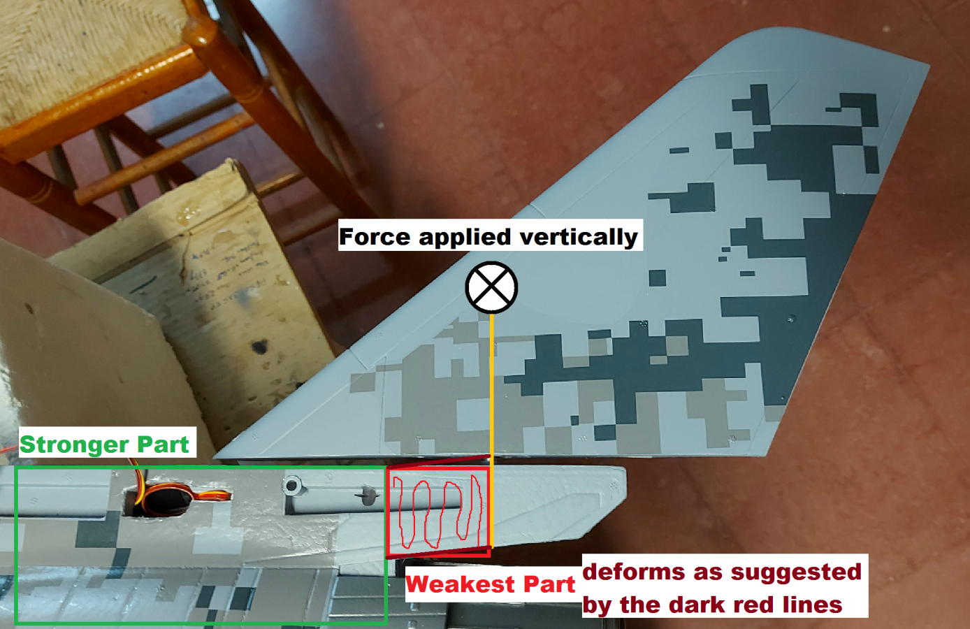

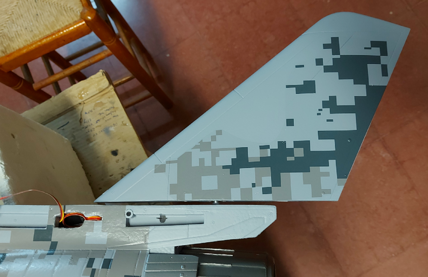

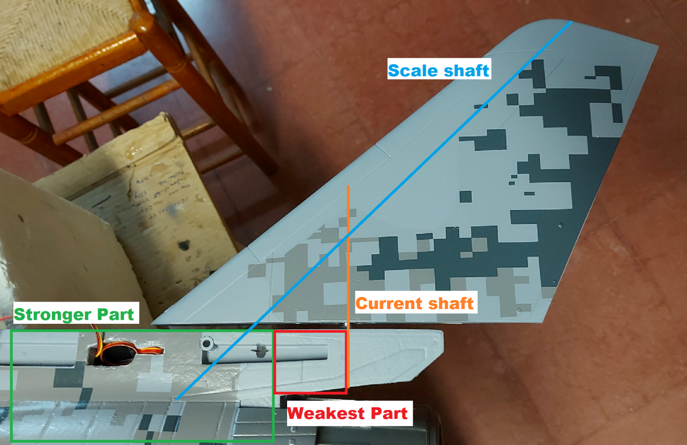

                                    I spent some quality time evaluating the MiG-29 stab housing and now that I know what to look for, it is pretty darn obvious to me what is wrong and I'm kinda surprised/upset that this was overlooked or outright ignored by Freewing/MRC.
                                    There is indeed a structural issue as a result from a design flaw derived from choosing not to implement the scale stab shaft axis for whatever reason.
                                    Click image for larger version  Name:	00.png Views:	0 Size:	1.22 MB ID:	284793
                                    The thing is, with the 'scale' pivot axis, the stab would unload the forces directly to the strong part of the rear fuselage but with the 90º shaft placed further aft, the thin foam+plastic box that should be basically only there for cosmetic and aerodynamic purposes becomes the responsible for keeping the stabs in place. If that little piece of foam and plastic fails, the stabs will deflect producing anhedral and that probably messes the linkage geometry to the point that the stabs cannot simply be moved to produce the restoring downwards lift required for level flight or pulling out of a dive, regardless of whether the servo is operating properly or not.
                                    Click image for larger version  Name:	02.png Views:	0 Size:	1.34 MB ID:	284790
                                    To make things worse, the piece of foam that has to take the torsional load has been 'emptied' to allow the 'aligning' vertical stab insert.
                                    This reduces the total cross section of the piece and makes it act as an open U-shape profile (as if EPO flexing wasn't already bad enough). It can be clearly observed from manual application of forces to the stab axis that this piece is deforming. If the glue responsible for joining the of the two fuselage foam halves and/or the one gluing the plastic stab housing to the foam fails, then that will provide basically zero structural resistance. That's the underlying reason for the dive-crashes witnessed so far IMO.
                                    Click image for larger version  Name:	03.png Views:	0 Size:	1.33 MB ID:	284791
                                    The foam being cut open to host the vertical fin only makes it worse as it 'opens' the profile, killing its ability to withstand torsion which was already marginal to begin with for the flexible foam.
                                    Shifting the shaft more aft without changing the sweep angle will only make things MUCH worse.

                                    Being that the most likely culprit of jets going down is structural, switching the pivot shaft aft while keeping it at 90º will only make it much worse.

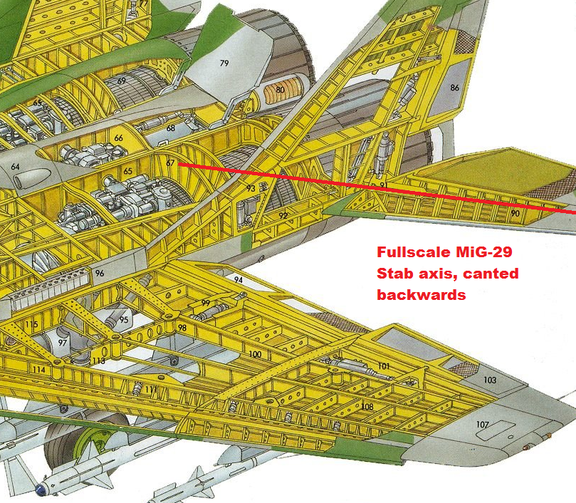

                                    The 'good' solution would be to cant the axis as it is on the fullscale jet and should have been the stock design.
                                    Challenging? Sure, but perfectly doable IMO.
