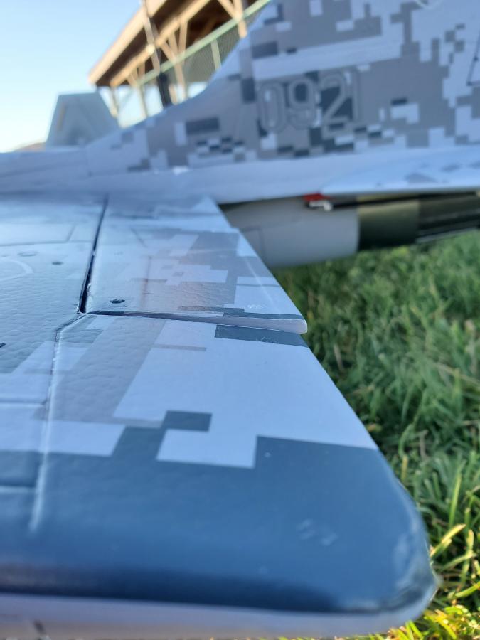

                  Now, yes I can certainly appreciate that the "FFS" (stabs) are deforming due to loads in high speed dives with the flaps down. Maybe overloading the servos as well. That video was incredible. I'm not saying that isn't a thing - but it's not the problem that some of us have reported. Both elevators simply stopped working while I was flying at low speed, low throttle, flaps up, and simply losing altitude gliding in a level slight dive towards the end of a completely normal low-drama flight. Function returned after about 2 seconds when I cut the power, and then I returned to flying normally and landed (with flaps) without any issue. (I also have balanced stabs, the upgraded servos, and HD hardware)
                  Others here reported the same thing: the servos simply stopped working while flying normally. So we've figured out we shouldn't dive at 120mph with flaps out. But why are the servos shutting off in flight for no apparent reason? As opposed to a failure when under a large load, having both servos cut off during normal flight doesn't seem to have anything to do with the airframe. So I think there may be more than one problem here.

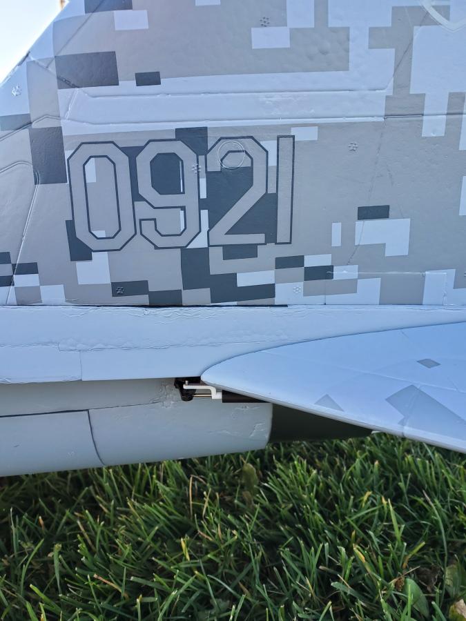

                    Finally started working on a drag chute release for this bird. Aside from a few springs, a servo and hinge pin it should be completely 3D printed.
                      If the design of the airframe results in excessive loads being demanded of the servos even in level flight, that can easily lead to the kind of problem you observed.
                      And as has been amply demonstrated, the design of the airframe DOES demand unusually high loads from the servos.

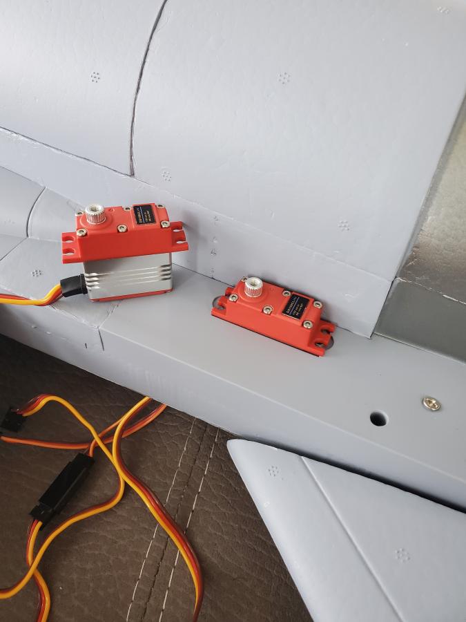

                        Has anyone checked their upgrade servos for travel as opposed to the stock ones? One of the upgrade servos I had in the kit was faulty as stated in my previous post this was replaced by MotionRC. EU. I have found that the stock servos have a limited travel the upgrade servos can travel 360% is this normal? I have never come across this in any other make of servo I have used.

                          - Upgraded elevator servos to Promodeler DS150CLHV

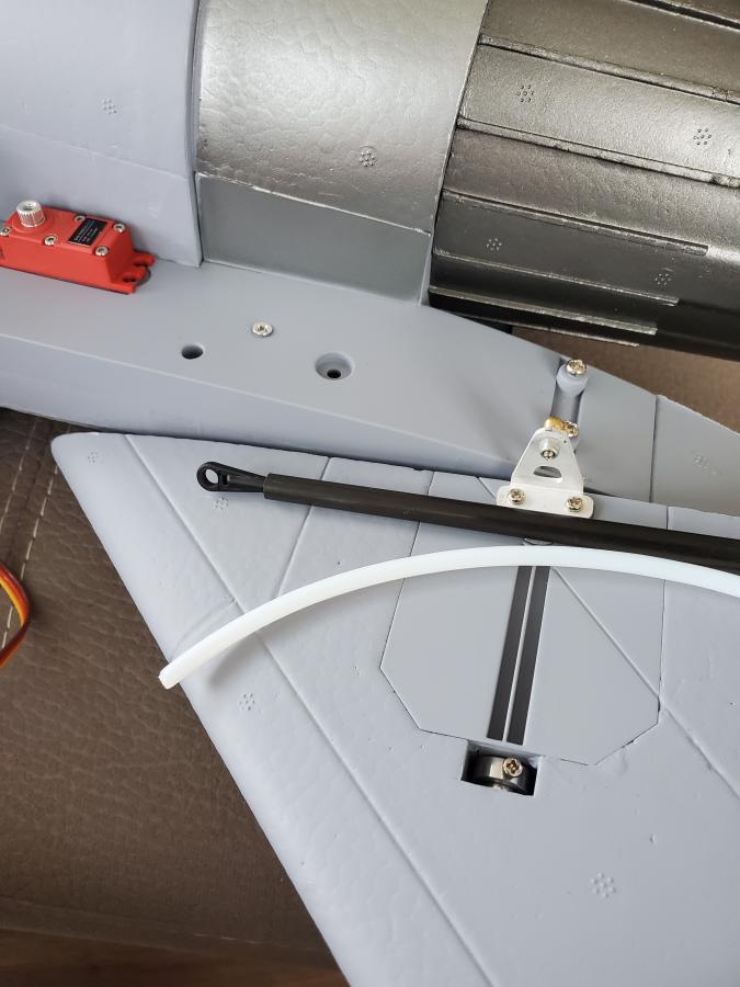

                          - Beefed up elevator rod, by inserting a PTFE tube inside the carbon tube, to fill the empty space

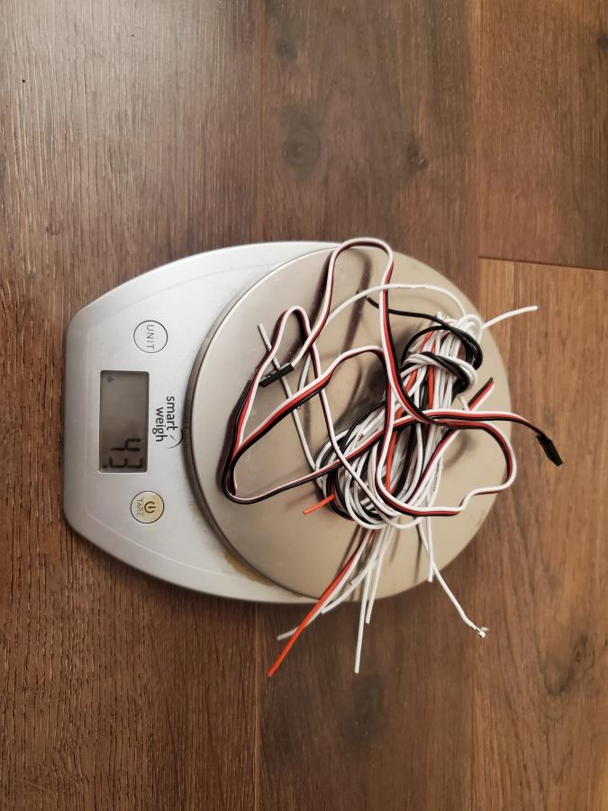

                          - Removed 50-60g (at least) worth of unnecessary wires, moved the blue box all the way aft of the canopy bay.
                            Servos aren't shutting off in flight. The deformation of the stabs is likely doing something to "lock" the pivot in place so the servos can't articulate them.

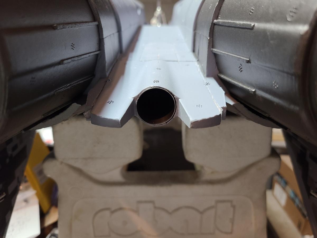

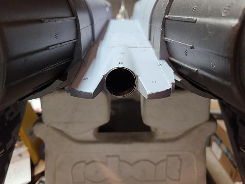

                                    TV nozzles will be good because they will add some redundancy for if the elevators fail.. You just have to leave them on 100% of the time!

                                      All of my planes that have VT, the nozzles are active at all times. You just learn to fly the plane that way. They augment pitch, roll and yaw, so you use lower rates most of the time and then throw into high rates as airspeed dictates more need for them. In the case of this MiG, I'll do the opposite and use high rates most of the time, since it's not clearly known why the elevators sometimes don't do what they're supposed to.
