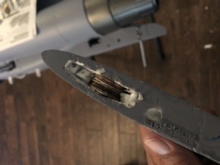

                          • I did more testing on the workbench and despite all that I previously said still applies I found out that the more pressing concern seems to be deformation of the stab itself.
                            Fiberglassing the stab with thin GF cloth and WBPU is comparatively easier to doing the proper thing with epoxy and thicker cloth with the tail assembly, so there's that.
