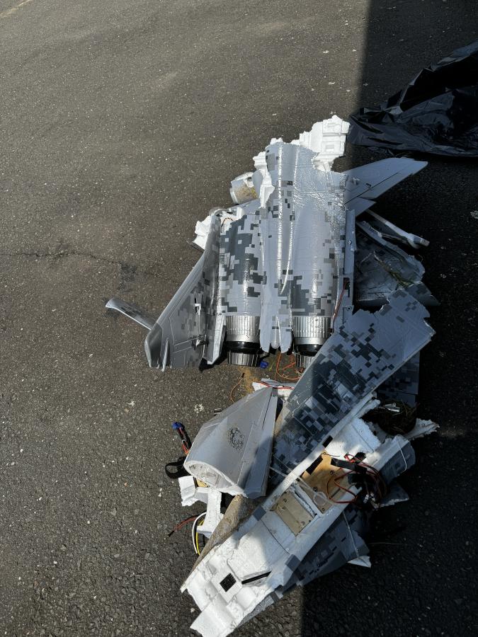

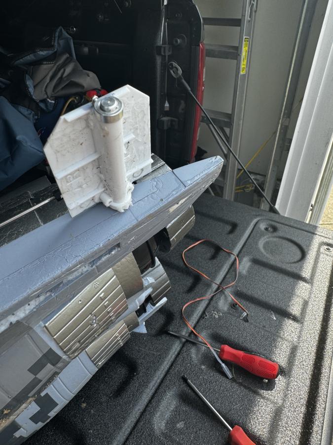

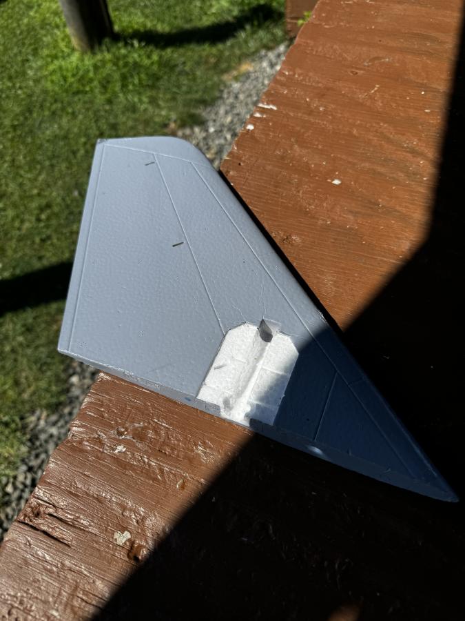

                                      What the heck crashed my MiG-29 on final approach today jet headed straight nose down and was totally destroyed. After investigation noticed that one of the elevators detached itself from its mounting plastic bracket very little glue was used. This is unacceptable from free wing.

                                        Adhesives seem to be in short supply in China.
