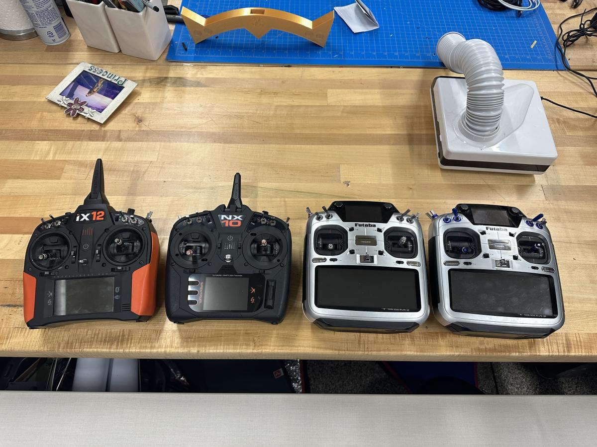

      Can someone explain how to set up the reverse channel? I bought an ix10 just to have enough channels for the reverse... I'm a futaba guy, don't speak Spektrum very well, but learning.
      • DCORSAIR
        • 1918
        • Selma, Ca.
        #6003
        Oh no, you went to the dark side, you should have gotten the Futaba 16IZ instead...........
          • 5387
          #6004
          Really, he should have. Especially since there s no such thing as a Spektrum iX10!
          • DCORSAIR
            • 1918
            • Selma, Ca.
            #6005
            Were just giving you a bad time buddy, I think you meant NX10, my buddy just got one and I have to say its a very nice radio, don't care for those long sticks it had though, I did go over some of the programs with him because I do his test flights on most of his jets, tried to get familiar with it but after being with Futaba 39 yrs I just didn't get it either so don't feel bad, but you can learn it.
            • drscoles
              • Feb 2023
              • 6
              #6006
              I have two 32MZ's.... Don't wanna take a $3000 radio to the field for a quick foamy flight.....
              Forgive me for getting hung up on Spektrum nomenclature... NX...IX.... Makes complete sense.... LOL. I just want to be able to assign dual rates to every channel like in Futaba!!
              So, anyone care to opine on the virtues of setting up the reverse channel on the magical Spectrum platform??? 🤣 Click image for larger version  Name:	1B1DFA1A-F843-43FF-B21B-AB1C5328186F_1_201_a.jpg Views:	0 Size:	171.5 KB ID:	384755
              • kallend
                • 1863
                #6007
                Assuming you know how to use the roller and get into "System Setup".. . . .
                Go into "Channel Assign"
                Scroll to the channel you wish to use for reverse (Ch 10 or "Aux 5", maybe) and use the roller to select the switch you want to use. Anyhow, I'll use this as an example.
                (Depending on which receiver you use, the ports may be numbered or named)
                Click on "NEXT" and make sure that port AUX5 is linked to channel Aux 5 (notice the difference in upper and lower case letters). Ports are the physical slots on the receiver that you plug things into, channels are just somewhat abstract positions in the transmitted data stream. You now have a switch associated with the channel and output port on the receiver. (If this seems weird, it is actually very powerful because it allows you to re-map the output ports in complex models like canard deltas with TV, for example).
                Now use the back button to get back to the main screen.
                Your selected switch will now send an output to port "AUX5" (or 10) on the receiver. You can see what it's sending on the monitor screen. By default for a 2 position switch you will see values of -100 and +100, which are fine for controlling the reverse function on the ESC. Plug the ESC's reverse lead into this port.
                If for some reason these are not the values you see because someone has previously changed them, you can go into "Digital Switch Setup" and once again use the roller to select the switch, and for its positions you can then use the roller to change the values for each switch position. As always, check that the values are correct using the monitor screen.
                • drscoles
                  • Feb 2023
                  • 6
                  #6008
                  Perfect thanks! I ended up using program mixes for the TV, but might try to assign channels like you describe instead. Thanks!
