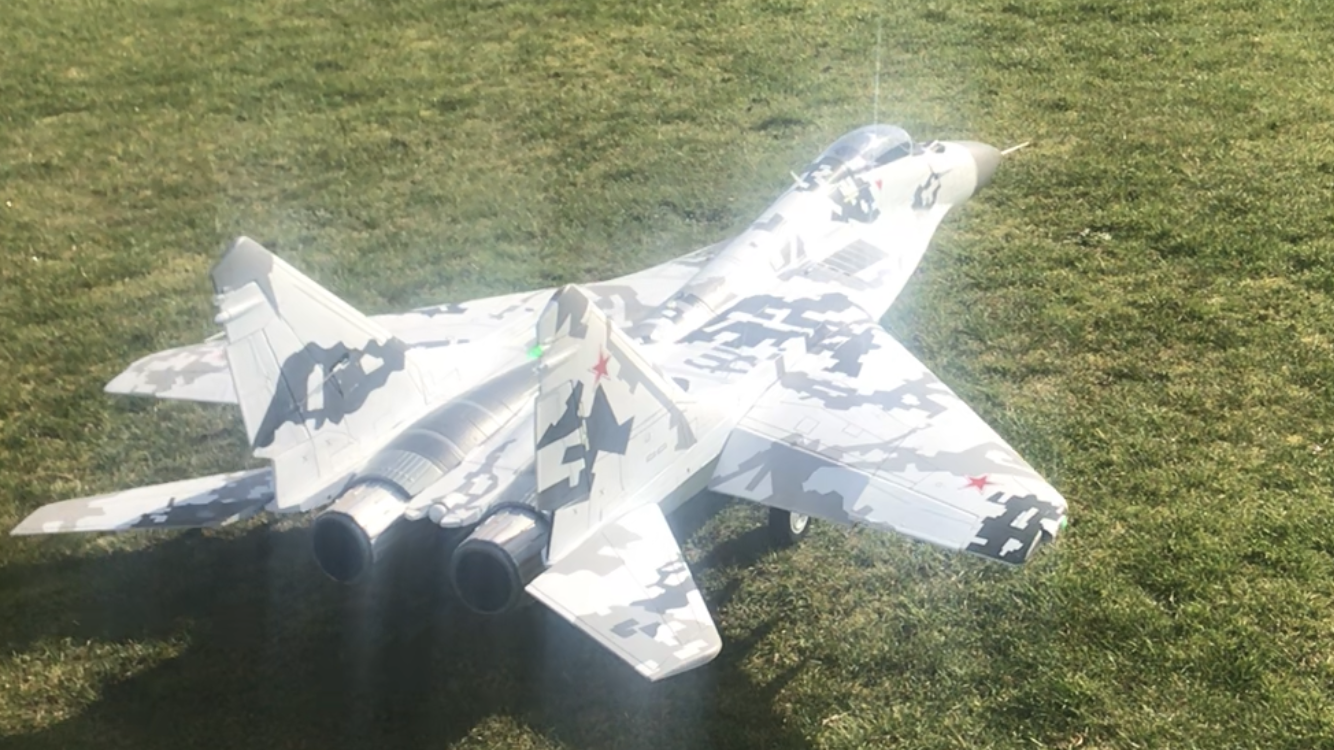

                      • The only pic i did before entering in the field ..
                        that’s it

                          But you also have some pics that you posted here earlier and the ones you sent me in the PM's showing the entire jet, the one close up of the pilot and the lit HUD. Those are fine for the contest. BTW, when is the contest. Any photos of the crash site? Those would get you tons of votes.

                            Such a work of art. I encourage you to do another....in time. A few more questions, please...
                                  Hey Hugh, sorry I don’t have any photos after the . crush . I was incredibly shocked and speechless, with helps of others we collect the most of it and tossed in my car ...
