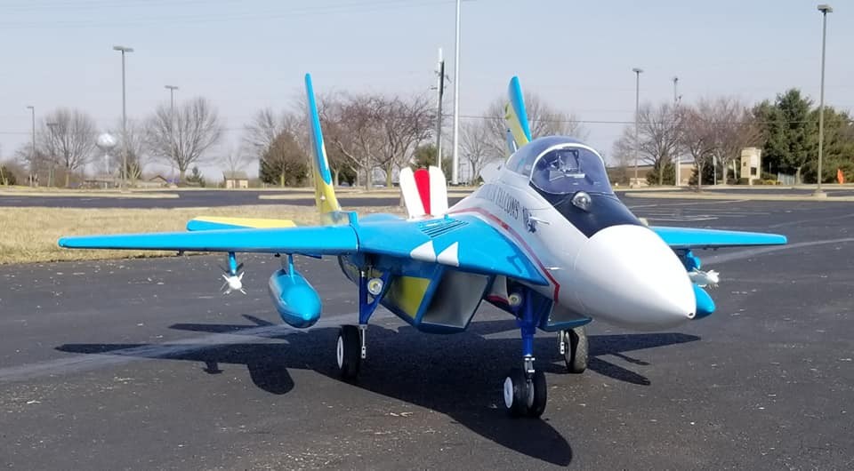

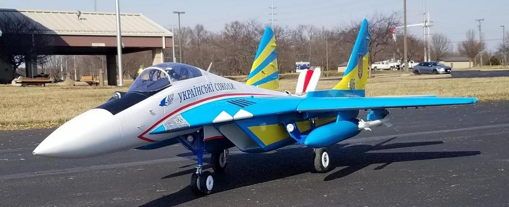

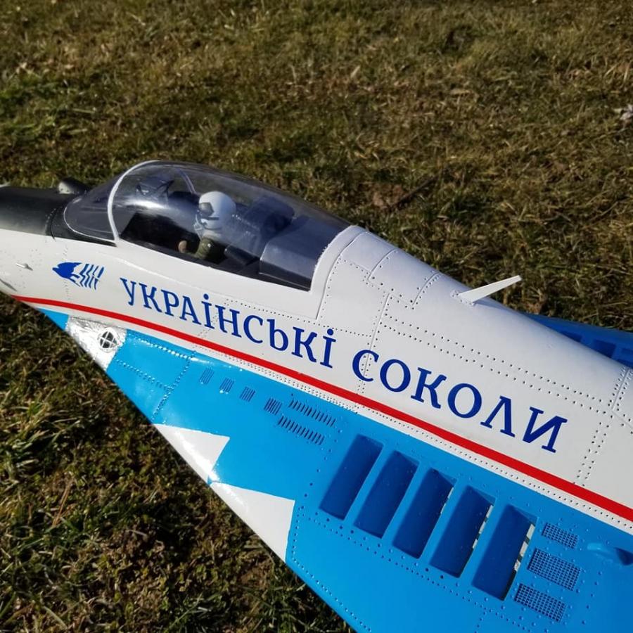

                      #4150
ID:	303680Click image for larger version  Name:	159223018_3652566744778639_7033528086720402899_n.jpg Views:	0 Size:	140.0 KB ID:	303681Click image for larger version  Name:	158497641_3650191165016197_2476579044871477824_o.jpg Views:	0 Size:	110.8 KB ID:	303678Click image for larger version  Name:	159250726_3650191228349524_7381672316548872827_n.jpg Views:	0 Size:	85.4 KB ID:	303679

                            That Ukrainian Falcons plane is amazing! I've been watching all the prep work, but had no idea what the finished product would look like. Perfectly done.

                                      • 450
                                      #4158
                                      Originally posted by t33jetman
                                      The Ukrainian is just a tad bit off ...
