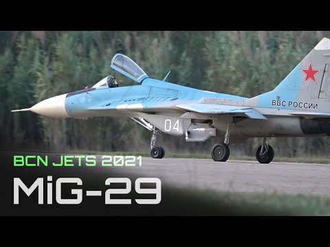

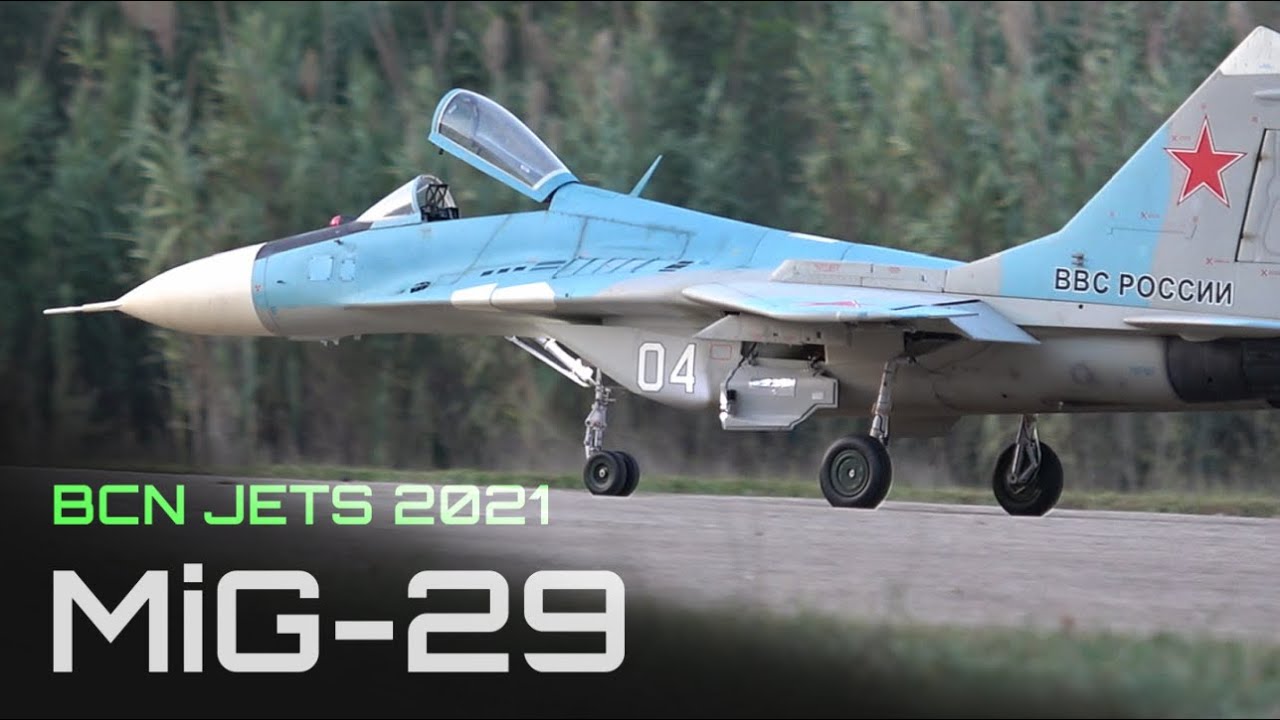

                    • Probably not the MiG you were expecting but...
                      • Originally posted by Airguardian View Post
                        Couple of ruff landings, almost looks like he was a bit too slow on the approach. What say you?
                        • Very gusty and windy, saw it from Jandro's videos too. Looked like the same flight from two cameras.
                          • It was the same flight from two cameras indeed.
                            It was windy and gusty all day long until he flew. At this point there was barely any wind and this pilot is not used to flying without wind. He uses it to slow the approaches (keeping a greater actual airspeed for more safety margin) but he is not used to high alpha flying and doesn't have tailerons configured so when the wind is down, he struggles to bring it in because he is not used to slow high alpha flight.
                            Gut feeling tells me he is also rather on the nose heavy side, making things worse.
                            • Thats a good argument for tailerons
